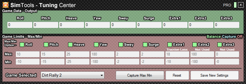

  17. DOFreality
    DOFreality Member
    Oct 30, 2016
    84
    Montreal
    343Coins
    +45 / 5 / -0
    new 6DOF profiles and tuning settings for Acceto Corsa, Dirt Rally, Dirt 4, pCARs 1 and 2
    -download them,
    -unzip
    -drag ' n' drop to the Tools -> Preset Installer
    -In Axis Assignments select Generic 2D Standard
    -Select game from the game list
    -click Preset
    -Select proper 6 DOF preset
    -Click Save
    more to come

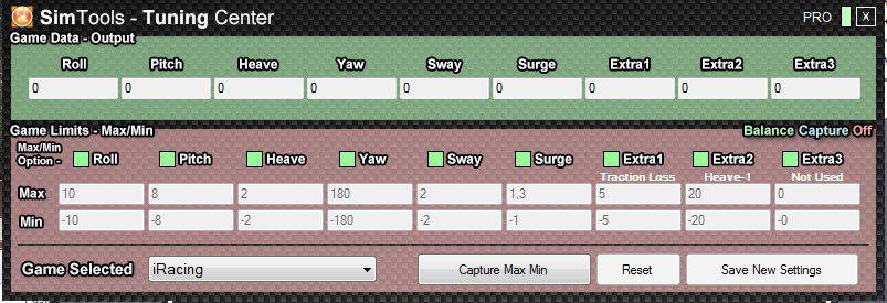

  18. DOFreality
    DOFreality Member
    Oct 30, 2016
    84
    Montreal
    343Coins
    +45 / 5 / -0
    iRacing and Dirt Rally 2.0 for 6 DOF

  19. splendiddd
    splendiddd Active Member
    Jun 13, 2009
    358
    CCTV security
    Netherlands
    810Coins
    +62 / 2 / -0
    @DOFreality no offence but i think it would be more usefull to upload the actual min/max files instead of posting screenshots.
    You can extract them from appdata (hidden folder) local/simtools etc. (same location as the axis presets folder)
