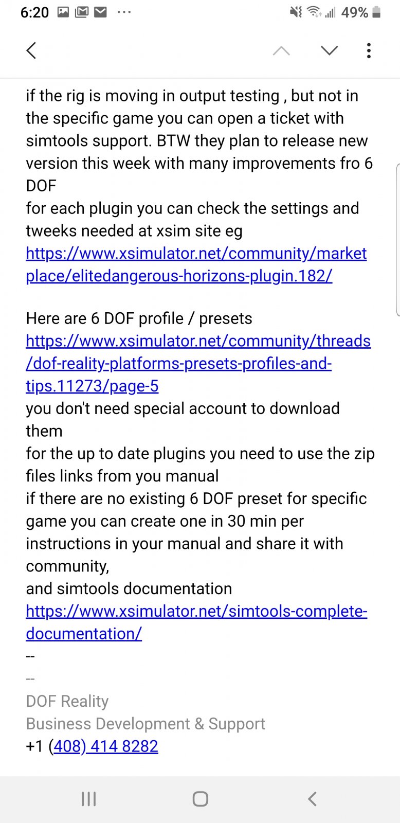

    Some of my profiles don't work either.... They said xsim is putting out a update patch this week for 6 dof.
    In the mean time... Try to start over.... Dcs... Assetto corsa... Dirt rally 2. And a few other work. For me.... Dirt rally... Elite dangerous and the crew 2 don't work for me.
    I am opening a ticket to xsim support for the ones that don't.... I sujest you do. The same after you start over.... If the profiles still arnt there.. you did something wrong....
    They should be.... Weather they work or not is anouther story.

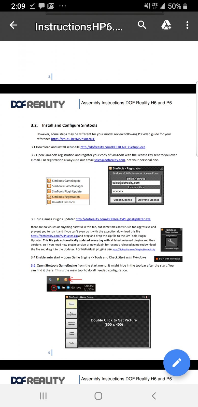

    I hope you understand... I am tryi g to help you....
    On page 9 on the installation.. Did you regester your simtools? With your code they sent you in the mail?
    Once your regestered you will have access to dof realitys profile on xsim....
    When you regester put
    Sales@dofreality com. AS THE USER NAME.
    then put your code.
    It will regester and then you can down load all the profiles.... Dose it for you..

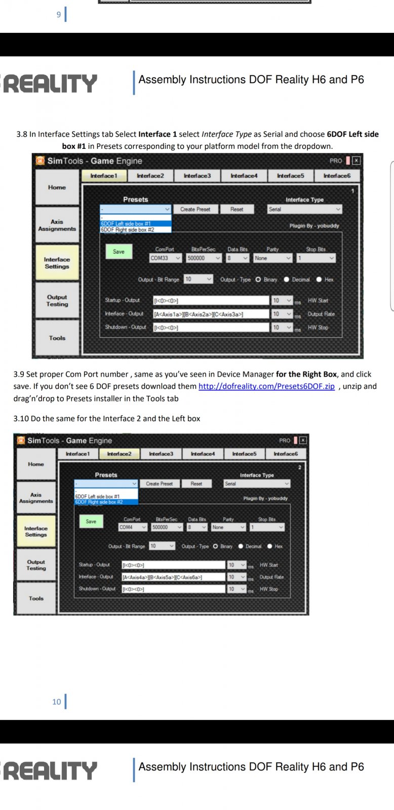

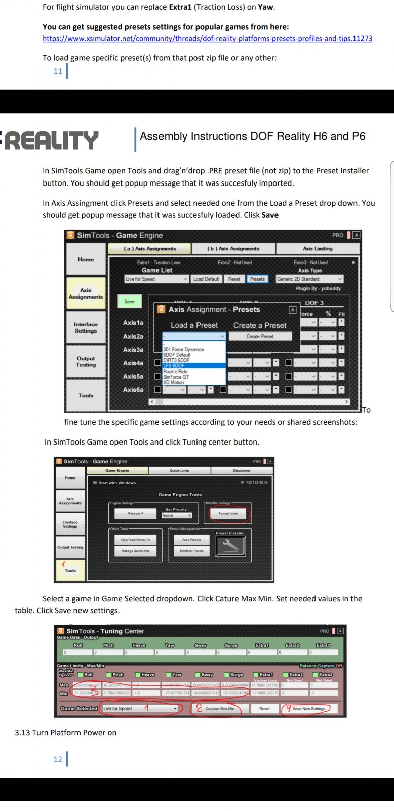

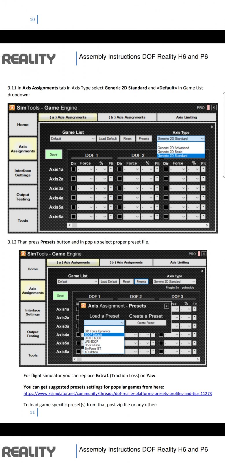

    Okay... I understand now.
    Hopfully this may help....
    Did they send you the zip file for the presets
    In your shipment email?
    Worse come to worse I will send you a copy of the instructions to do it your self. If you would like.
