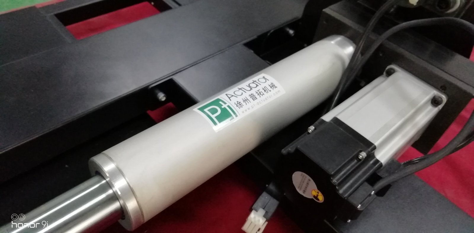

    For the money you paid, you could had 4 linear servomotor actuators from PT-ACTUATOR (with AASD-15A servos 750w, 150mm stroke 500mm/s speed!!!)... Serious industrial quality, not toys with DC motors...
    I hope you get it shorted and that it actually worths it...

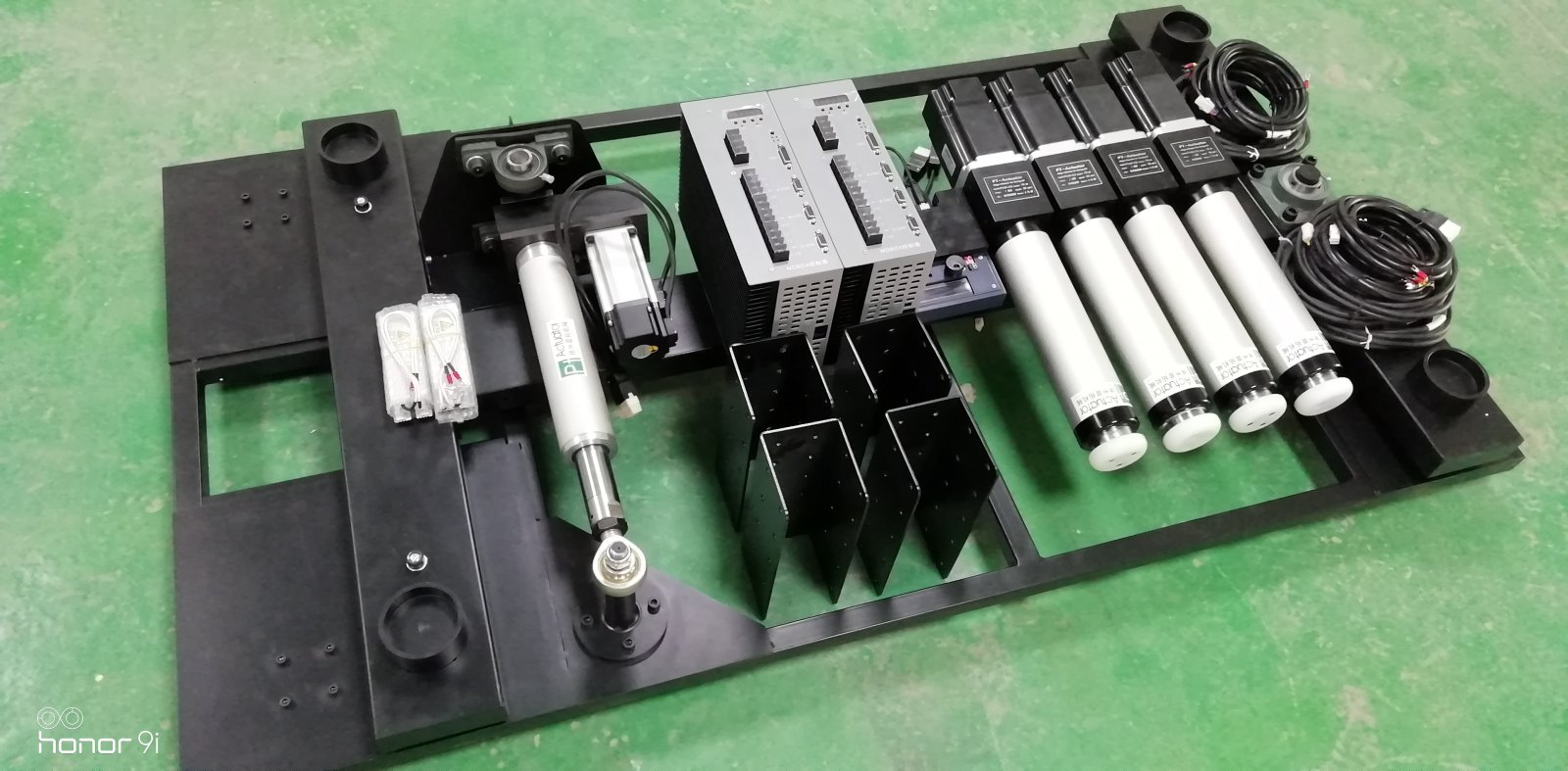

    There are now really inexpensive kits... even for 4DOF with traction loss...
    http://www.pt-actuator.com/pro.asp
    Totally easy to put together without messing with mechanical or electronics...

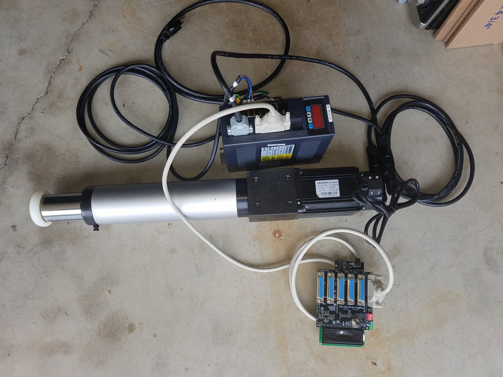

    He copied text from my Tindie store, where I offer the AMC-AASD15A controller without enclosure to save cost. I could provide that controller directly from me, assembled with enclosure for additional $30...
    The actuators cost $700 each, complete with servomotor and AASD-15A servo drive, 150mm stroke, 500mm/s... ready to plug and play on the controller...
    Like this one:
    He has also kits even for traction loss that fit on existing commercial cockpits, but you have to contact the PT-ACTUATOR to ask price for it. Make sure to mention it for the model with AASD-15A servos... and give him for reference the link from this thread here so he knows what is it about ;)

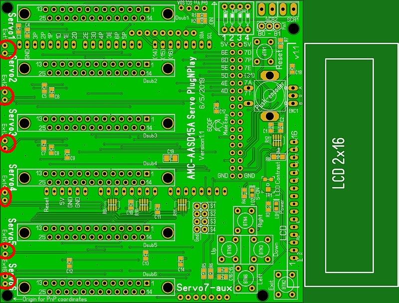

    Yes, you could. But you would have to wire the torque detection signal to limit switches instead and directly on the AMC-AASD15A controller as you would not have other way to calibrate the home position of the motors with rotary actuators...
    See the external connection circled red for use with limit switches for home calibration:
