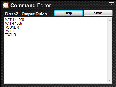

    Hi,RacingMat,I get a X27 589 stepper motor ,and I used a test program to run it ,but it was not run in your code ,I have tried to input the values from 0-255,but it just rotate a little,what style of input value is correct ? and could you picture your gamedash setting? I dont know the rules of gamedash,and I cant find a detailed introductions of the gamedash, Thank you very much!
    I found a function in the code is "map(Rpm, 0, 255, 0, TotalSteps)",but the I can't find the "map()" was define ,so is this in some library file? maybe it's the problem .

    @welen123 :
    what kind of "test program" do you use?
    here a screenshot I did

    Thank you for your help ,I get the map function means.

    the example code you posted cannot work with gamedash!
    Did you test the code I posted?
    Did you setup the same baud speed for Arduino and windows Comport and GameDash?

    Yes ,I tried the code you posted,the video showing the situation by your code ,maybe its the wrong rules of the gamedash with live for speed.how can I make the output value to a" byte"type. because your code define the Rpm to a byte.
    I have find the problem,its the rules setting.and I change the range of the byte to 0-150 ,and it works now.
