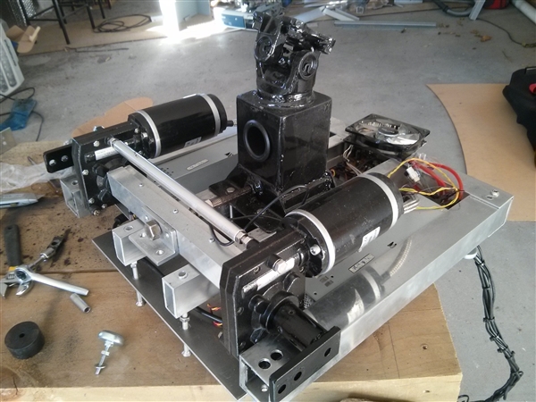

    My compact sim is back in bits again for some upgrades.
    I have shortened the motor lever arms, so I don't have to worry about catching my ankles on them. I would never have used the additional 60 CTC holes so have just left the 40 and 50mm CTC options. I have also swapped out the dainty but pretty hard rubber feet for some really big ones that are way more flexible, seen toward the bottom left of the picture, to better isolate the rig while I am experimenting with haptics.

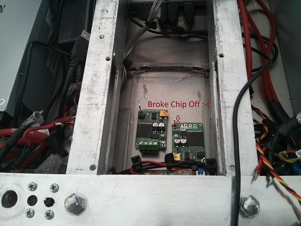

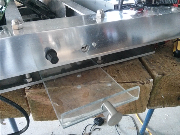

    To improve serviceability I have made up this slide out tray to mount the JRKs, as they live under a fan which is embedded into the frame, so are impossible to get to without pulling the sim apart. I made up some perspex runners for the tray and plan on using a magnetic clasp to lock it in place. The 8KG magnetic lock I got is actually too much, so I will probably end up using a 2KG one instead.
    I still need to add the new fuse box, rout the wiring through the back of the tray, add the new wiring connector blocks and put the JRK heatsinks back on, then do a bunch of wiring to the new control box.
    Unfortunately I also managed to accidentally break off a very small chip on one JRK board when removing the old wire block, which I am replacing with bigger wire connecting blocks. :(
    I have another dead JRK, so perhaps I can steal the chip off that and re-solder it to this one, nothing to lose in trying.

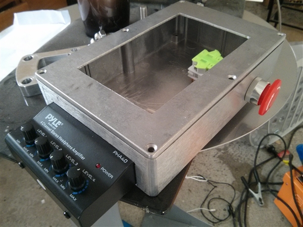

    This is the start of the new control box, which will also mount the HOTAS joystick in front of it. The kill switch and audio controls for sound and haptics are mounted. The hole is for the inbuilt Nexus 7 tablet, which will act as the computer screen when using the Rift without needing to run the ultra short throw projector, and for a bunch of apps that provide in game controls. I still need to add JRK monitoring LEDs and reset switches, using @Archie's brilliant idea.
    The control box will eventually be mounted with a quick release to allow it to conveniently pivot to the right, to maintain easy access getting in and out of the sim when the rig is in full frame mode and the joystick is mounted HOTAS style.
    I will add more upgrade details as they progress over the next few weeks.

    Modding, it never ends:). Just a question on looking at your pictures, do you have heatsinks on your JRKs - cannot really tell - I'm sure you use to have them fitted?

    Yes @SeatTime I have heatsinks for the JRKs, but they are off while I am making the new sliding tray, as it is a really tight fit and I didn't want to catch one on the frame while testing the fit by sliding the new tray in and out. The heatsinks will go back on once all the new wiring is in place.
