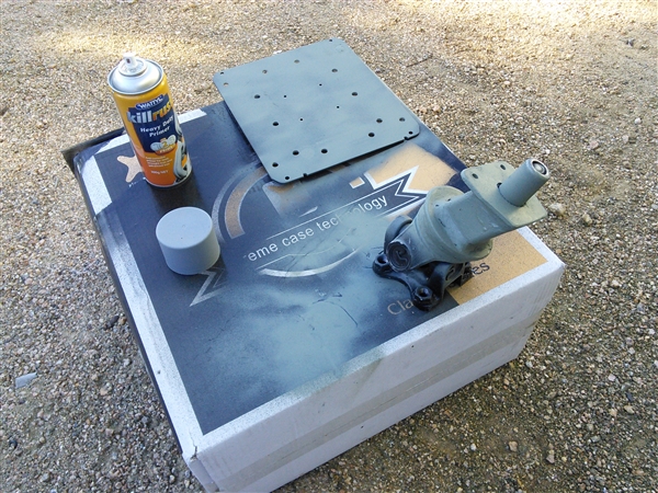

    @noorbeast - Time permitting, would you mind making a close up video of how that heave mechanism is working. I've watched the video a few times and also read your reply to the other member. Is the office chair mechanism the seat height adjustment part or the forward and back tilt part?
    Oddly enough, some time ago I had the same idea of using an office chair for heave where actuating the height adjustment would drop the chair, but could not figure out how to pull the chair back up as you normally have to take your weight off the chair to adjust it for more height..
    Awesome work as always Sir. Very impressive set up!
    22,230
    154,849Coins
    +11,229 / 57 / -2
    The mechanism is the tilt part, I already had it but this is an example of the style I used, so it could be purchased. You would want to hunt around concerning price if there was a need to buy one: http://www.ebay.com/itm/Office-Chair-Seat-Plate-Knee-Tilt-Mechanism-Control-NEW-/380342104992
    What I really need video wise is good lighting, as I was trying to capture the heave plate mount movement in the first half of this video: http://www.xsimulator.net/community/threads/dx-racer-compact-simulator.5866/page-15#post-83683
    What I may do is try and do a video of it as a 1DOF, with the heave motor driving heave, surge and pitch. With the Rift the 1DOF surprisingly feels pretty good and while you miss the sway it is not as much as you would think!

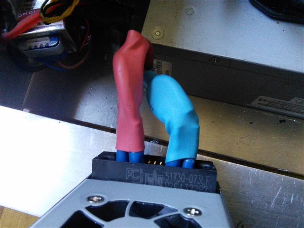

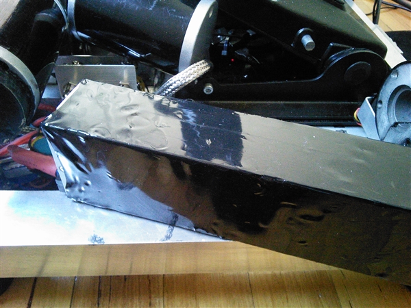

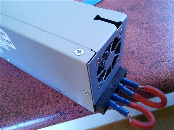

    Some maintenance updates.
    I started getting frequent JRK usb disconnects on the right front motor. I swapped out the motor and usb cable, which had no effect, so I concluded the most likely cause was a failing PSU, which was indeed the problem. I use HP server DPS-600PB PSUs and managed to pick up a brand new replacement, with the genuine HP shipping box being somewhat of an overkill:
    In the past I soldered the bridge wires direct to the PSU terminals, as per @Slider's original guide: http://www.xsimulator.net/community/threads/how-to-modify-a-server-power-supply-for-12v.5774/
    However, this time I am trying something different to simplify swapping out a PSU within the very tight confines of my sim. I have pinched each pair of the blade terminals together and used two 6.3mm female connectors each side to bridge the bade terminals. I then soldered and shrunk wrapped the power cable to the wire bridge just behind one of the terminals. I don't know how well it will hold up in the long run but so far so good and it means I can easily swap out a standard PSU in minutes, without pulling the whole sim apart.
    I also noticed that some of the springy metal tabs that normally provide tension in a server PSU bay have been catching on the frame of my sim when I pull it out in an upward direction. So to ensure that can't happen and to prevent any possible chance of earth leakage I also shrunk wrapped the whole PSU before putting it back in the frame.

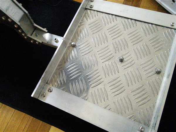

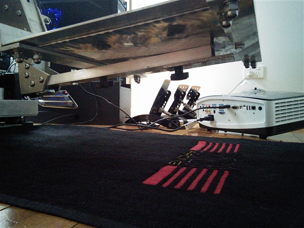

    While I was at it I also modified the pedal plate so that there are three different mount positions, using two quick release thumb bolts. I have a short mount position for my sister and father, a medium length mount position for myself and one for friends with long legs:

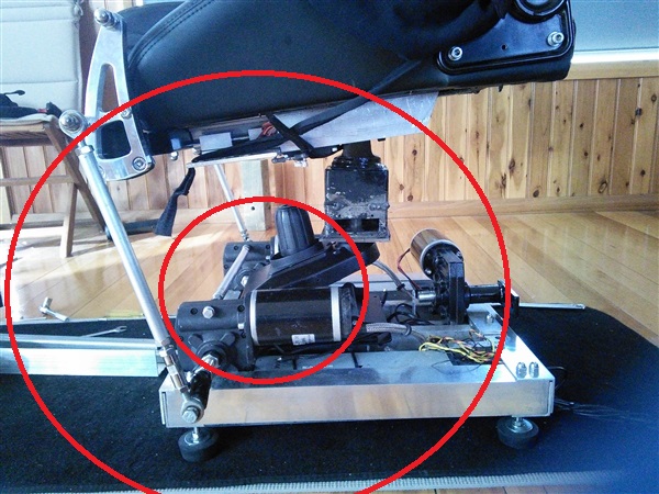

    22,230
    154,849Coins
    +11,229 / 57 / -2
    Yes, when activated the heave motor centralizes the heave spring position and can move it up and down from there.
    I actually use my sim as an office chair unpowered, which is why I chose the 25:1 for the heave at the rear. The 60:1s at the front remain in position when unpowerd. The heave spring will support over 100kg unpowered and being adjustable will perfectly balance a users weight. The unpowerd 25:1 moves, so the seat has some 'give' under you up and down if you shift your weight, which makes it really comfortable.
    When in use the heave spring balances the users weight and provides some small positive lift force up and some small negative resistance down, both of which actually help as the user weight is already assisting downward movement anyway and the positive up helps lift the user more quickly.
    The last comment is about the arc the heave knee travels through and the relative position of the universal joint used to minimize the impact. When I mocked up the heave it was immediately obvious that seat would travel through a large arc relative to the much smaller arc of the knee if the joiner was perpendicular to the heave knee:
    So the joiner is angled forward to minimise that impact, that way the seat travels through a much smaller arc comparable to the knee itself:
