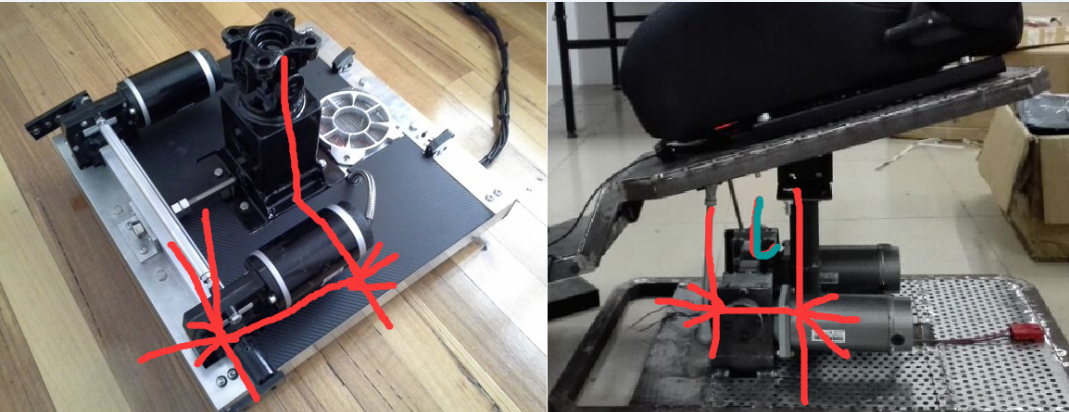

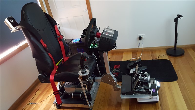

    In the picture, left is yours, right is mine.
    and the distance between cross coupling and motors are similar, and you use 200w motors only, but I used 350W motors, when I sit in my 2dof, it can' perfectly, my motors is not enough to move my desk. That's why?
    How do you determine this distance between cross coupling and motors?
    Thank U!

    My gearhead reduction ratio is 1:40

    You should actually post the question on your build thread.
    However, I use 60:1 gearboxes, the distance between the pivot point and rod connection is 250mm, which I consider is about the minimum, and I don't connect the rods to the base but higher up closer to the center of gravity.

    These are the new HOTAS and wheel mounts.
    They may look similar but the new HOTAS mounts are further forward and quickly detach with 2 nuts.
    The wheel mount is higher and I have a separate one that folds down for a center joystick mount.
    I have ordered a new 50:1 gearbox for heave. The 25:1 is great for racing but I found when recently setting up P3D that the heave motor gets pretty warm if you do long climb outs, where the 25:1 is under constant load for long periods. At some stage I will also change the front motors to 50:1, as they are now under light loads with the heave design and I can pick up a bit of extra speed.
