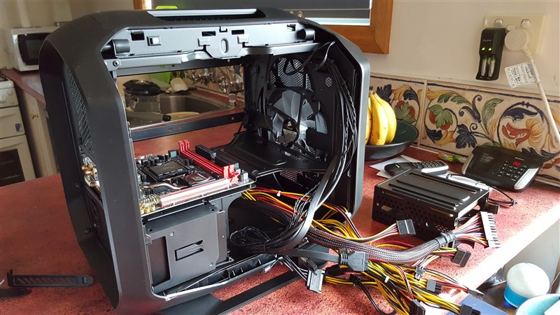

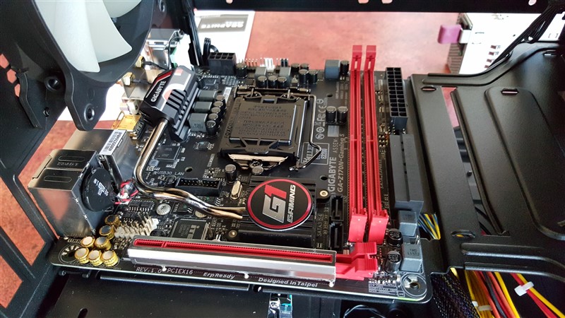

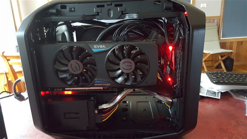

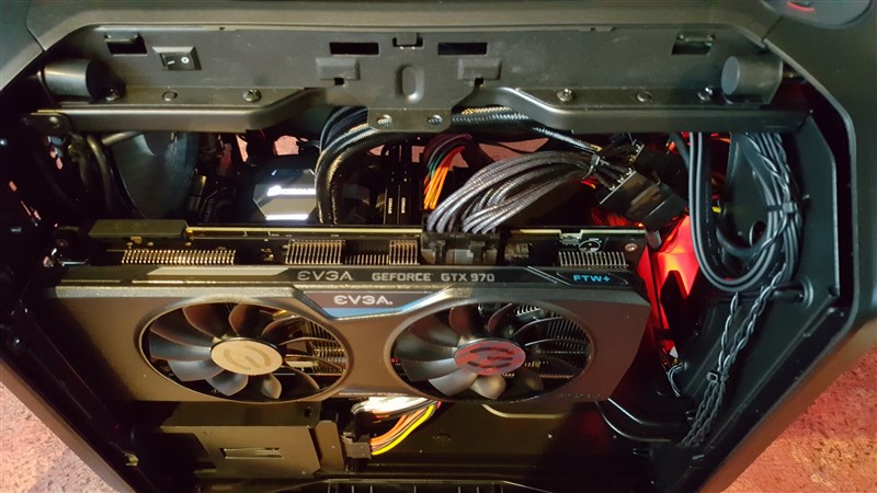

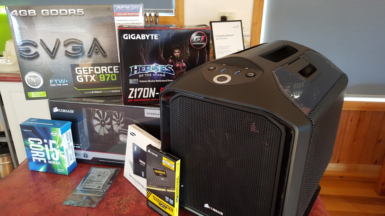

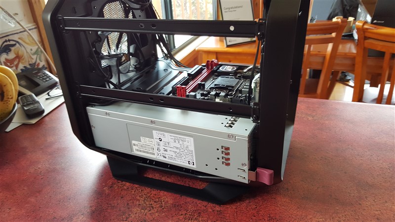

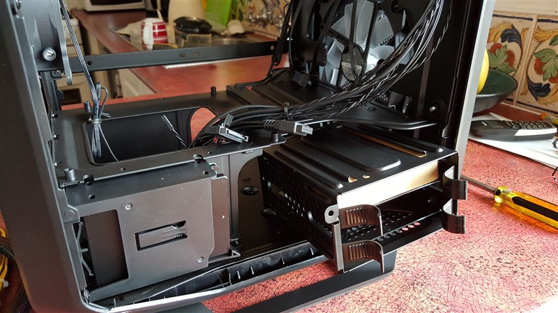

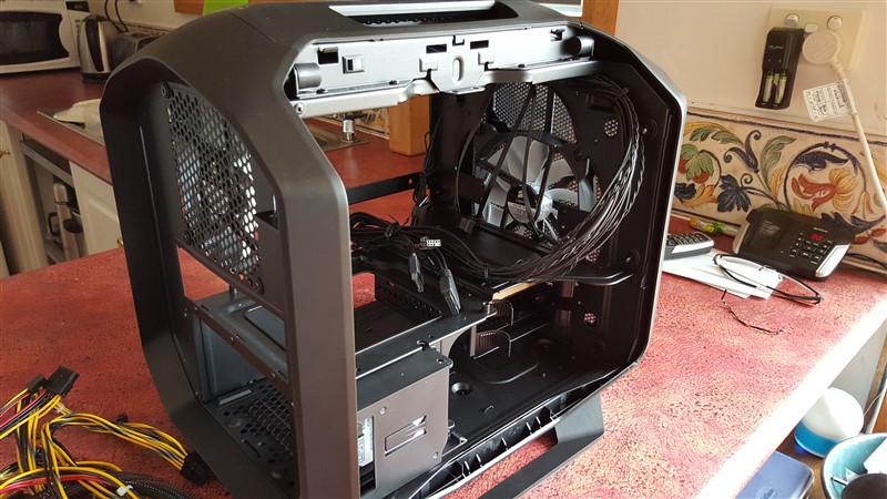

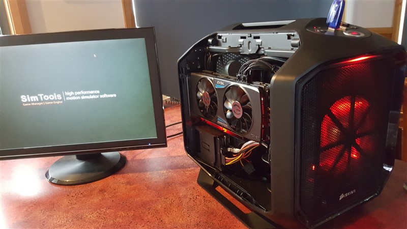

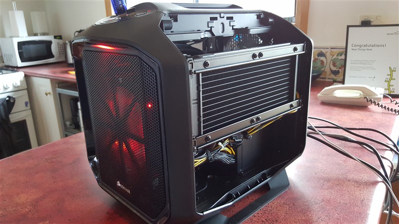

    This is the new compact VR computer I just put together, interestingly the brilliant Corsair case would neatly fit HP server PSUs if anyone wanted to build a portable PSU, control board and perhaps sound system out of one.
    Corsair Graphite 380T Mini ITX Black Gaming Case
    Gigabyte GA-Z170N-Gaming 5 Motherboard
    Intel Core i5 6600K
    Corsair Vengeance LPX CMK16GX4M2B3200C16 16GB (2x8GB) DDR4 Black
    Samsung 850 EVO Series 250GB 2.5in SSD
    HGST Travelstar 7K1000 1TB
    Corsair Hydro Series H100i GTX 240mm Liquid CPU Cooler
    EVGA GeForce GTX 970 FTW+ ACX 2.0+ 4GB
    Cougar RS 750W PSU (a modular PSU would be better but I already had this lying around)
    I deliberately chose the 2.5in 1gb 7500 rpm HGST drive for storage so I could remove the double bay 3.5 housing to give more room for cable management. If I ever feel the need for more space with cheap drives I can put the 3.5 housing back in, but as this is meant to be a portable VR rig for a 9 transducer chair I plan to build I won't be adding more to it than I actually need.

    @noorbeast Thanks for the reply. Well that means i need to go look around for motors at Sim Lim tower instead of a scrap yard during my off day. Wonderful rig you have there. Was wondering whether the Dell Alienware alpha or Zotac mini PC is powerful enough to run your game, simtools & the OC rift. A compact mini itx PC would look great on your compact sim
    22,230
    154,849Coins
    +11,228 / 57 / -2
    While a mini PC supporting x86 could run SimTools and games not needing high end graphics, they are not suitable for VR which needs high end specs like the compact PC I just built.

    I have since fitted the 50:1 gearbox for heave. While I had it in bits I swapped in the brand new boxed HP server PSUs that I got really cheap some time ago.
