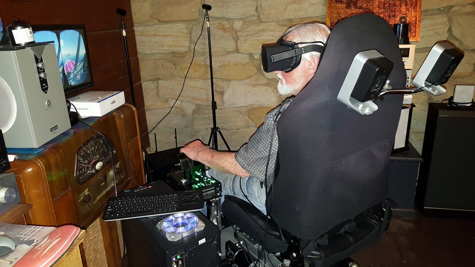

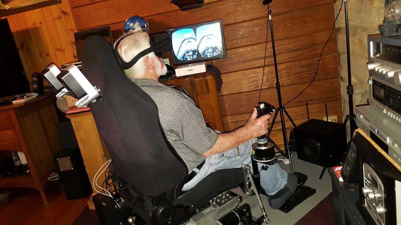

    I am away staying with family for the next few weeks and as my 86yo father loves using VR with my compact sim I packed them both up and brought them with me...not something I suspect many members do.
    I arrived tonight, had dinner, set everything up and dad is straight into it, even though it is already 10:30pm!
