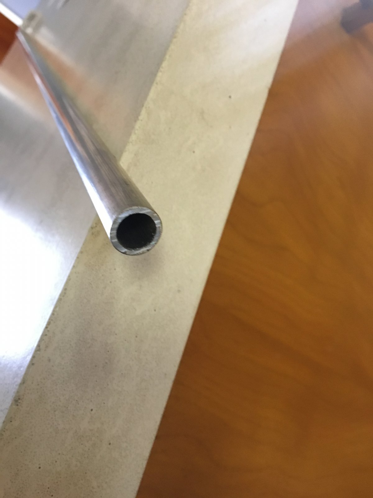

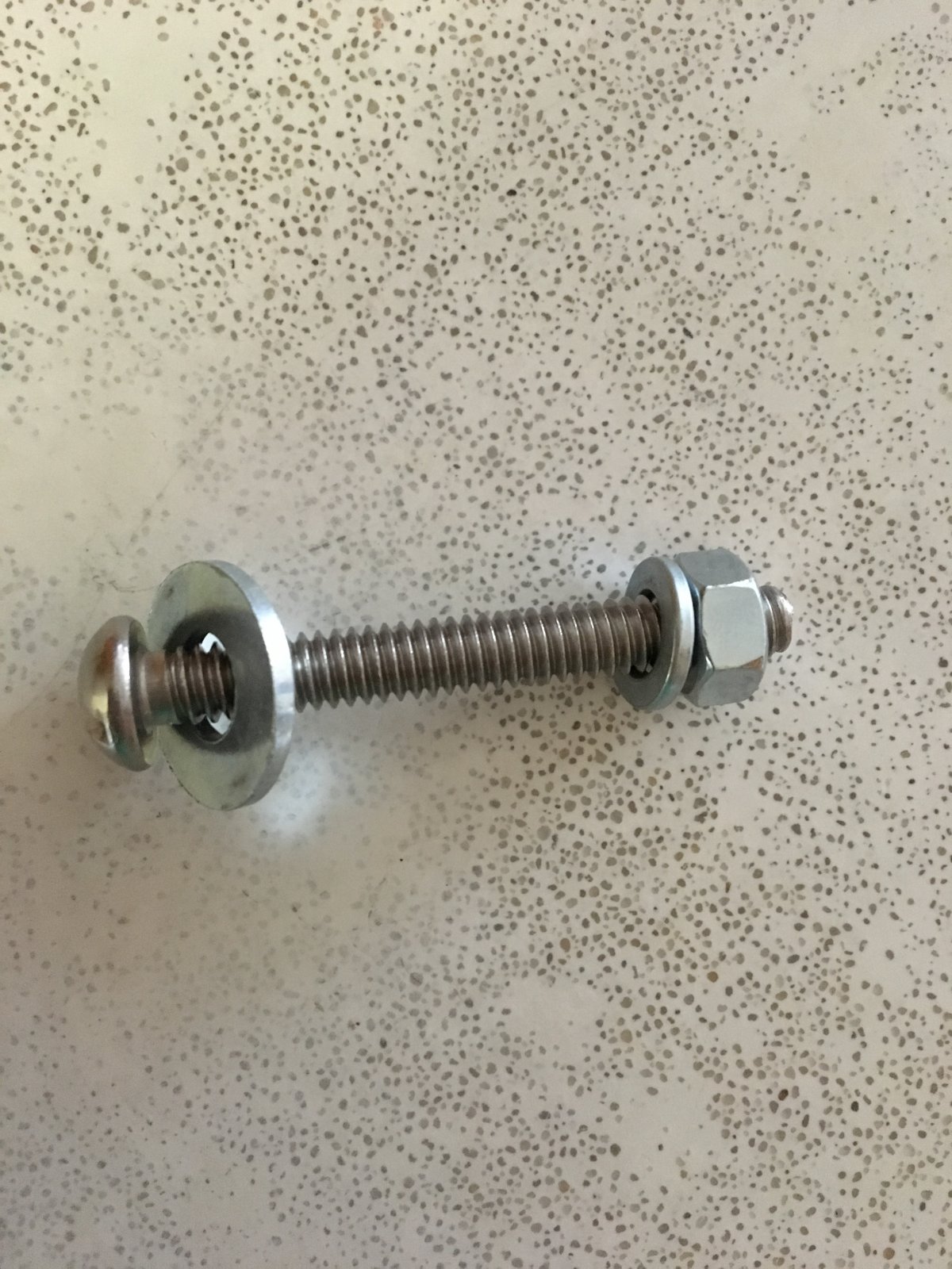

    Thanks for those dimensions. I am going to take your advice and build the base at 20" x 24" (apologies for the imperial units, I used to build houses and think in inches/feet, but that's roughly 500x600mm.
    Also good advice on the sleeves. I went material shopping earlier today and grabbed some round aluminum tubing to use as a sleeve. My assumption is that this is keep the bolt from compromising the integrity of the square tubing as torque is applied to the bolts?
    As far as bolting the corners- I just picked up some standard zinc-coated machine screws, with top washers and lock washers. I attached images of the nut/bolt/sleeve tubing for reference. Did you do anything special to keep the bolts secure the movement and vibration associated with the sim? Are bolts with nuts and washers enough?
    22,230
    154,849Coins
    +11,228 / 57 / -2
    I used additional lock nuts in key areas, like the suspended base plate, and used dome nuts pulled up tight for aesthetic reasons for things like the duel corner bolts, which have inner spacers to you can make them pretty tight.
