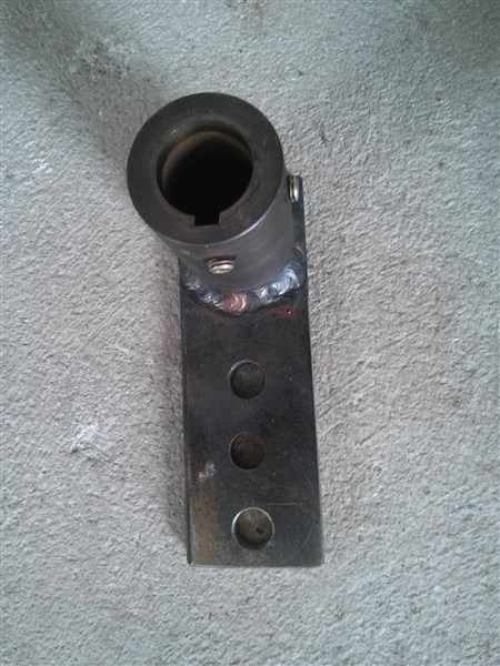

    Can you tell me how many kg you can adjust the heave assist? Ithink it have to be for the motors power because if it is to strong, even when the movement is down it will be much heavier to move as if it balanced, to assist and to resist right?
    And how can I calculate how much kg the wheelchair motor, Iam using can handle and how many to assist?
    is there any similar to your seat spring , maybe a car spring damper? I am searching for solutions.
    The most imported information for me ist the kg for example to 30 - 50 kg of your spring seat assist
  13. noorbeast
    22,230
    154,849Coins
    +11,228 / 57 / -2
    I have used my rig for children to big guy users:
    I used the original DX office chair tilt mechanism, you should be able to find specs and alternatives by searching for heavy duty tilt mechanisms for office chairs.
    At minimum settings if I drop the back motor arm off, which is the proper way to set it, I can basically rock the seat back and forward with one finger:
    If I crank the settings all the way up I can sit in it and it won't move (86kg + seat).
    The way I set mine for different users is that it should be adjusted to have a slight give in travel whatever the weight of the user, with the rear arm detached, and react much like a smooth seesaw to them bouncing their weight, then reattach the rear arm.

    Hi Noorbeast, this thread has been a amazing source of information. About to pull the pin and change from the 25:1 gearboxes to 60:1 with the 200w MD motors. Just wondering where you got your couplings with set screws from and if they were 20mm ID?
    Cheers
  20. noorbeast
    22,230
    154,849Coins
    +11,228 / 57 / -2
    That was many many years ago, so I can't recall the supplier, but they must be the correct size for the shaft size of the pot, in my case the Hall sensor had a 1/4" shaft and I used a 8mm bolt tapped to the shaft, so was 8mm that end.
