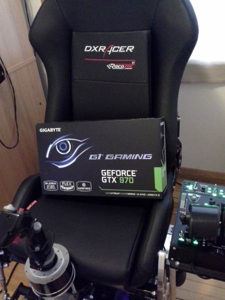

    The postie just delivered the new graphics card, my existing Nvidia 660 will go to my father and I can set up my old DK1 for him. I will have to dig out all my old DK1 tweaks.

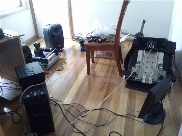

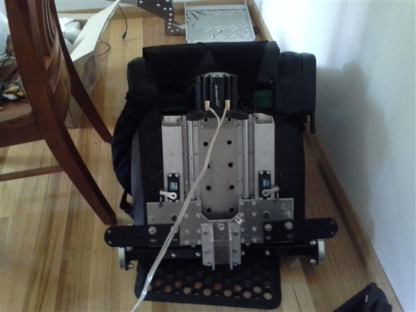

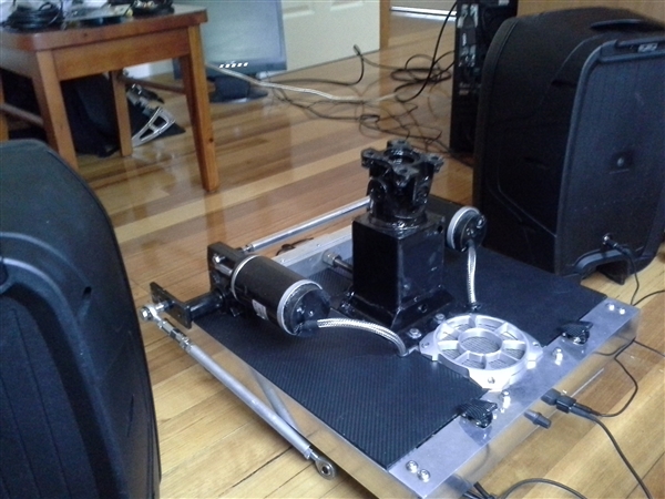

    Back in bits again...I spend way more time fiddling with stuff than I do using it!
    I have been playing around with plugging my portable PA speakers into the sim's on-board sound system, which can drive them just fine, along with an old baby amp I had lying around to manage those and the Buttkicker. I am also trying to simplify some of the wiring tangle into some key looms.
    I did try mounting the Rift tracking camera on the roof but the cables are just a bit too sort and at this stage I don't want to add extensions. I will need to reconsider when my VR Omni treadmill arrives, as the tracking camera will need to service the Omni and the sim.
    I really should take it completely to bits and install the new cables that connect the internal USB hub to the post mounted USB outlets, which are there to allow for easily changing controllers. However, I am itching to try out some of @value1's new plugins, plus I plan building a pull out tray for the JRKs to allow for easy service access, so will wait until I do that. Time to put it back together again!

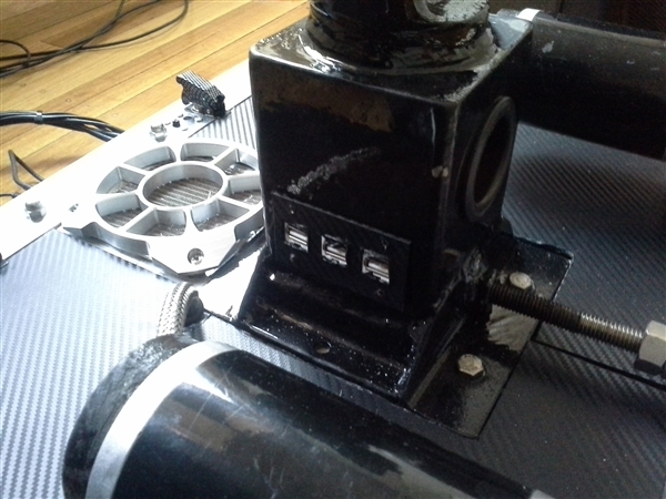

    I started with 25:1 hollow shaft motors and used threaded rod, just be aware the motor shaft can be either 12mm or 1/2 inch, so measure it to be sure. I could have simplified the pot side of the shafts if I had used a correct sized flexible coupling: http://www.xsimulator.net/community/threads/dx-racer-compact-simulator.5866/page-3#post-63105
    The 60:1 I have now are solid shafts and I have far more robust keywayed located arms: http://www.xsimulator.net/community/threads/dx-racer-compact-simulator.5866/page-5#post-65721
