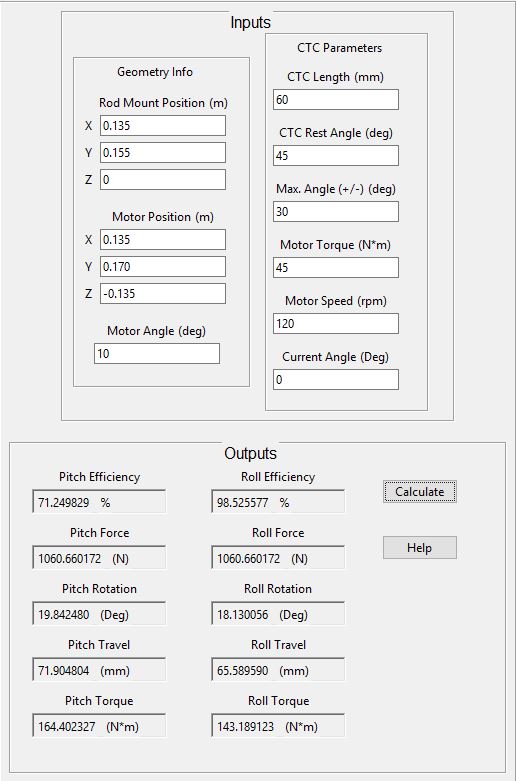

    Here is a SimCalc Screenshot when i put 0.000 instead of my real -0.050 Value for Rod Mount Position Z.
    Can i use the Sim with this specs ?

    Try a CTC Rest Angle of 0-20 degrees and use your real -0.050 value for Rod Mount Position Z.
