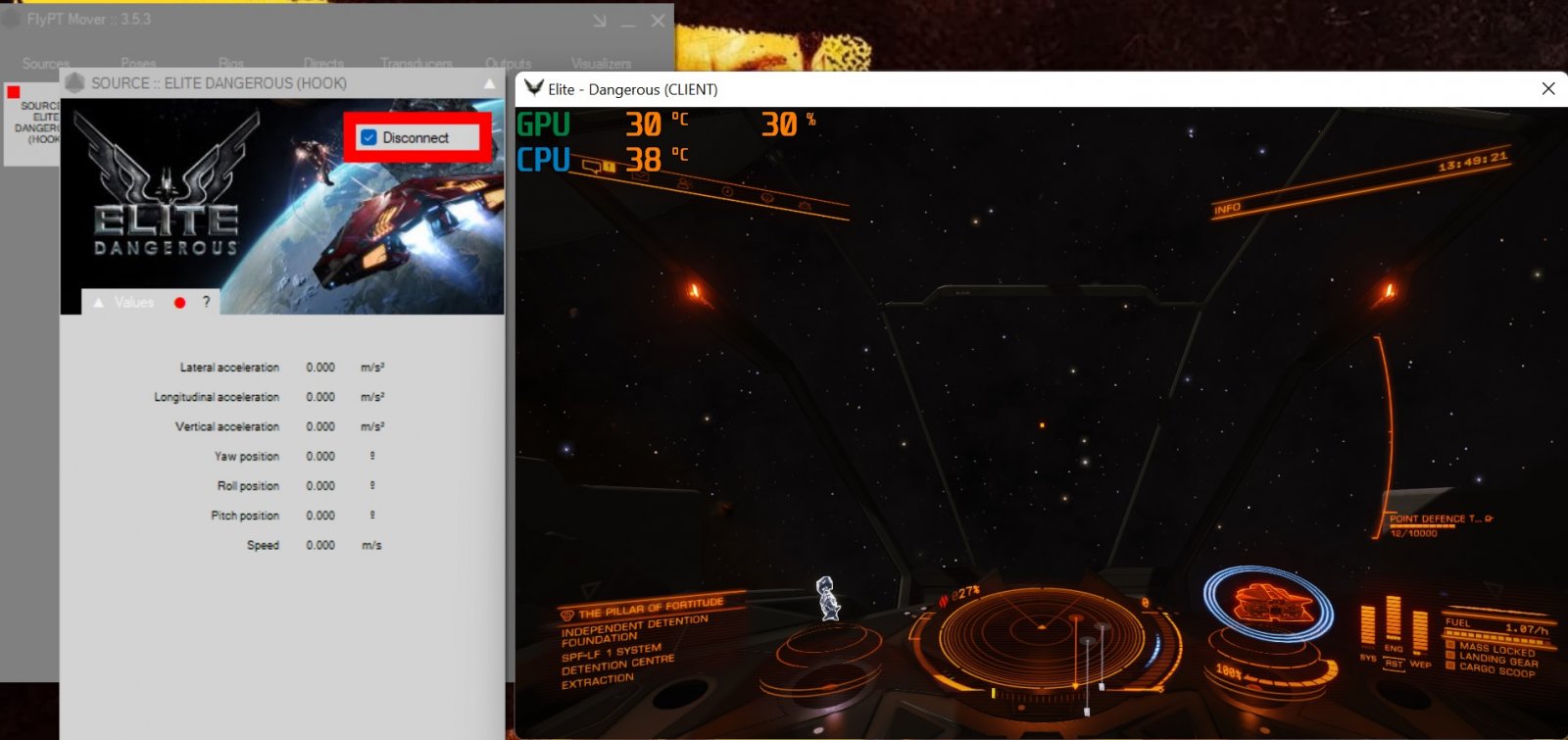

    I can't get ED to work with flypt .
    It gets connected if you look at the red box on connect , but no data is coming in .
    Can anyone help me with this problem.
    Does it have anything to do with pointer updates ? and how does that work

    Enumerate all the steps you did to connect, so we can know if you missed something.

    -I started Flypt
    -Added source in flypt for elite dangerous .(connect box is yellow)
    -Opended steam
    -Started Elite Dangerous
    -Connect source in Flypt ( connect box changes from yellow to red )
    also tried to start ED first and then Flypt with same result.

    It's been a while since I connected anything so other people might be better than me for checking this out.
    But, ED requires Simtools, No? I don't remember a direct connection from Mover. Am I wrong?
    And with Simtools, you need to patch the game.

    The FlyPT Mover source for ED does not work. I had to create a custom source using Wagnard's offsets. I can provide more info when I get home, but it works rather well, and whenever a new patch comes out, you just have to change the offset address to the new one and it works as before.

    Hi Nisch , that would be great I like flypt with MSFS so prefer to get ED running in it .

    Here you go. You'll have to modify the rig parameters and whatnot, or just delete everything but the source module and then merge it with your current Mover profile.
