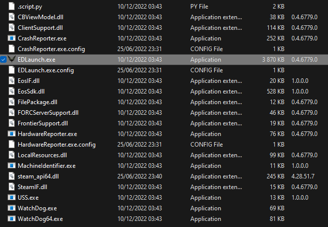

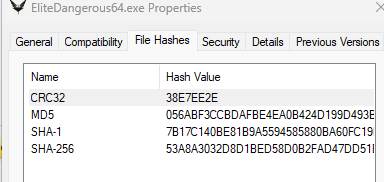

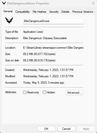

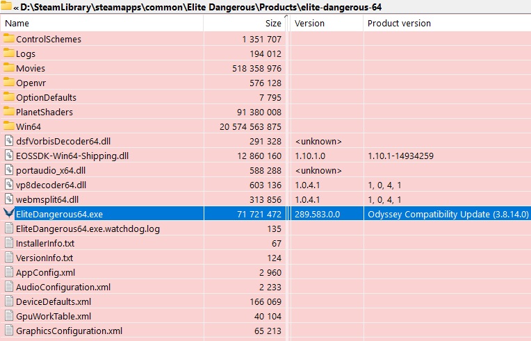

    Attached my file sizes and versions which you could compare to yours

    It's not on the EDLaunch that i'm hoking, it's the EliteDangerous executable
    located in "\Elite Dangerous\Products\elite-dangerous-odyssey-64\EliteDangerous64.exe"

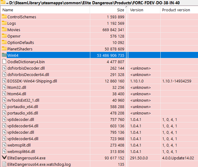

    ok, i have 2 versions, one with your executable, probably in the Legacy folder,
    and another older file version 3.8.14.0 in the default folder.
    So I may just use pointers from that version, if it was made.
    I purchased it june 22.
    Or maybe copy the working executable...

    the path seems to be the issue.
    The plugin check if it's odyssey is loaded if it find "odyssey" in the path. If not found, it use the pointers for the "legacy"
    Maybe you can hack around the path and add "odyssey" somewhere so the plugin will use the odyssey pointers.

    On my end it's this for odyssey/horizon (non legacy) : SteamLibrary\steamapps\common\Elite Dangerous\Products\elite-dangerous-odyssey-64
    legacy path : E:\SteamLibrary\steamapps\common\Elite Dangerous\Products\elite-dangerous-64
    The plugin check the path, if it find the string "odyssey" it will load the pointers for odyssey; if not, it load the legacy one.
    I will try to update the plugin to also recognize the FORC-FDEV-DO-38-IN-40 as an odyssey executable.

    @TomSawyer2112 I just posted a new version with a potential fix for your path.

    WOW, great, Elite Horizons has motion now, thanks a lot.hug:

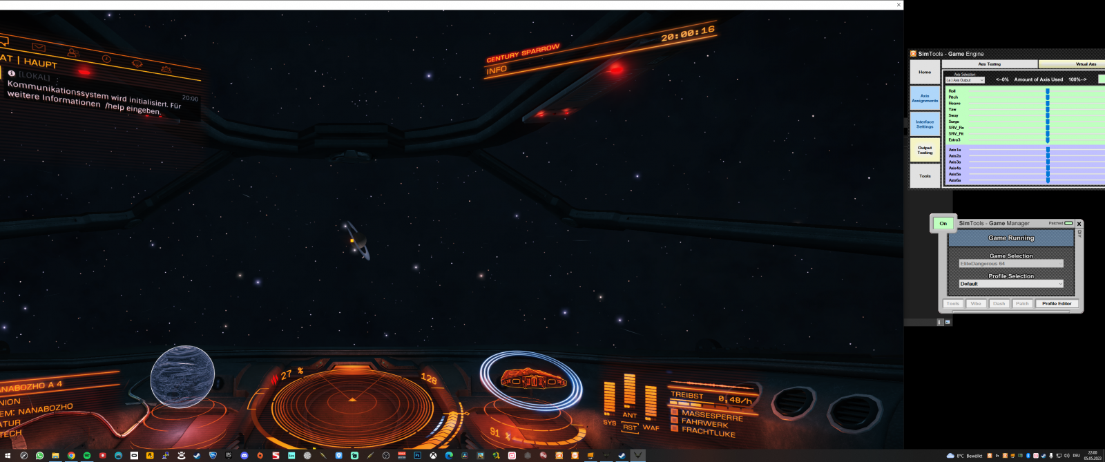

    unfortunately still not working for me...
    Is there a way to uninstall and freshly reinstall everything about the plugin?

    Legacy doesn't work as well.
    I should be seeing movement on the Sim Tools screen on this, right?:

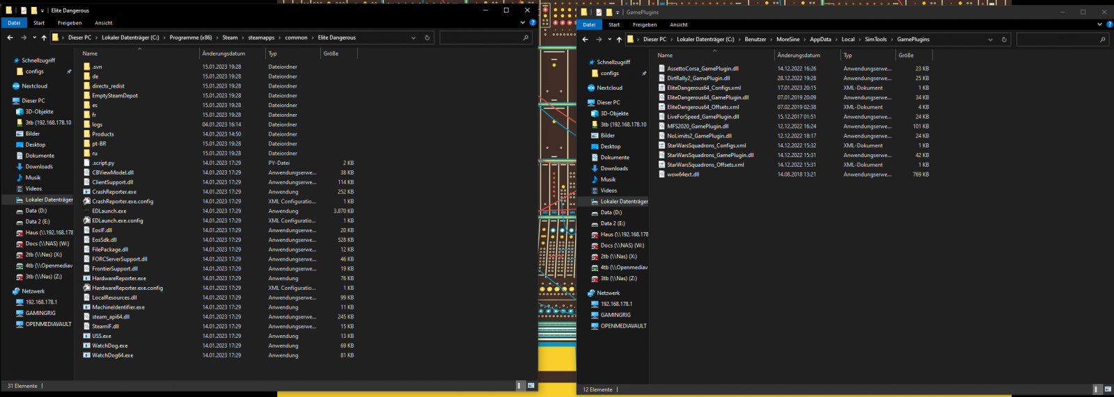

    And here are the folders:
    let me know if you need any more info.

    The date on the XML offset is 2019 that's is really old, probably you don't have the latest. what is inside that file?
    plugin seems old too, it should be dated from today
