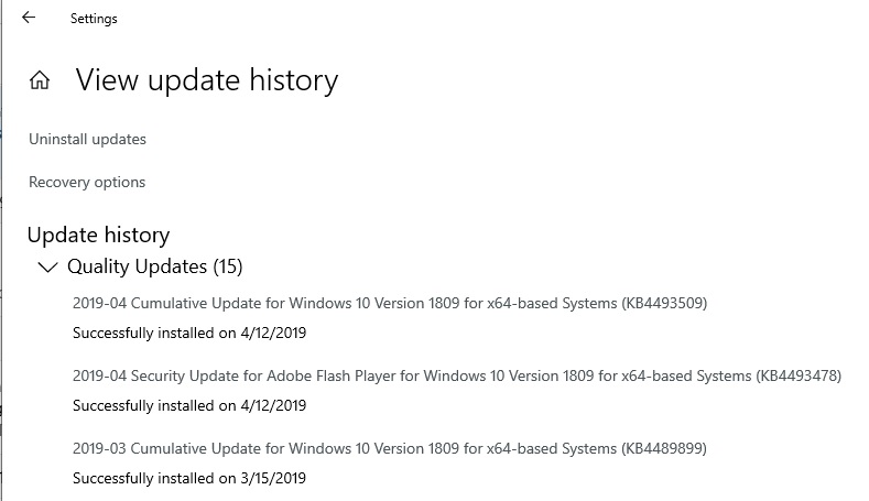

  18. Wagnard
    Jan 30, 2017
    562
    Wagnardsoft
    Canada, Quebec, Mirabel
    5,349Coins
    +776 / 2 / -0
    Yes this can be calibrated via XML, but I'll do probably more test when I have some free time.
    Also, on what windows version are you? May update or October?
  19. Pierre Lalancette
    Dec 11, 2016
    1,012
    Tech Artist
    Quebec, Canada
    8,052Coins
    +947 / 6 / -0
    3DOF, DC motor, Arduino, 6DOF
    Is this what you are asking for? I'm not sure.
