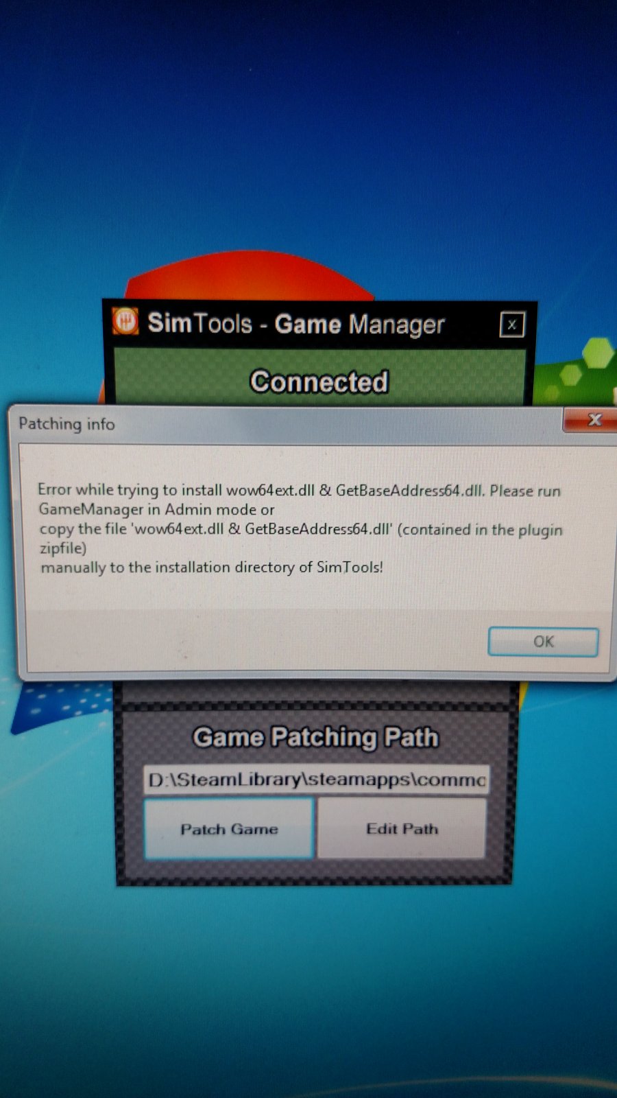

    Hello, a few weeks ago i had downloaded the elite dangerous plugin to a demo version x32 this still working, yesterday I did the download the new version to x64 and when i try pacthing the game he showed a message (picture in attachament), I try copy the files to the simtools folder but always showed the same message, if i click OK and start the game the Simtools Game manager stop. I'm using a steam version

    Start again and run in admin mode
    Also this is for Horizons only

    hello @SilentChill
    I tried run the sim tools plugin updater in admin mode and a can't add the new plugin, so i added in the normal way, and i ran the sim tools GameManager in admin mode and he showed the same message.
  16. SilentChill
    2,645
    20,598Coins
    +3,570 / 34 / -0
    Hmm sorry but it works for pretty much everyone else. Read back through this thread lots of people had issues but most got resolved eventually

    Bordiin,
    I had the same issue as you have, I finally solved the problem.
    Take care about the followings:
    1.
    You have to set the game engine and game manager running in admin mode, -I suggest you give admin rights to installer also-, just right click on the icons, compatibility, then click on running as admin.
    Be sure about if you moved the shortcuts to your desktop, it has to made by 'make a shortcut to the desktop', not just drag and drop to your desktop.
    It will only work in win7/64 if you get the message at starting the programs 'you are running in admin mode.' Thats good.
    2.
    Be sure that you have set the real directory of the game. If you have installed by steam, it should looks like, Program Files (x86)/steam/SteamApps/common/products/elite-dangerous-64/
    The most important to find elite directory, called:/elite-dangerous-64/
    By the way you can set manually your path in win7 at:
    C:\Users\*yourname*\AppData\Local\SimTools\GameManager\GamePathSaves\elitedangerous64.cfg
    It has to be working!
    Cheers,
    George

    Bordiin,
    Another thought: If you run updater in admin mode, just drag and drop the zipped file into the updater, has to be workin!
