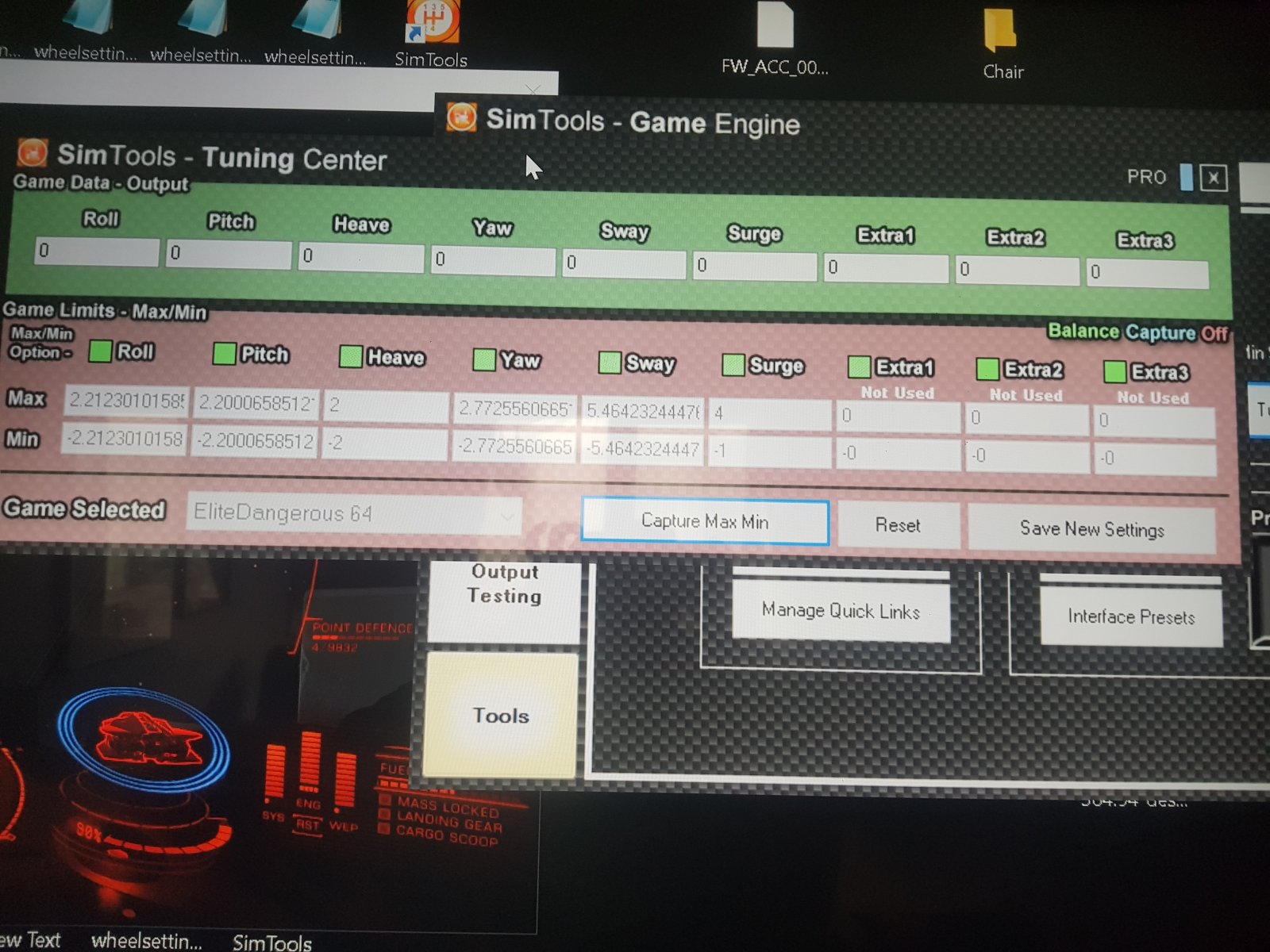

    Hi Craig, many thanks for this. I've copied the xml data in from your last post above and the result is excellent motion in roll, pitch and yaw, in normal space, super-cruise and there is no issue when you jump out at or drop in at your destination. Exactly as it should be. No issues whatsoever in these 3 dof and definately playable (hoping it kinda works in cqc too - all your previous plugins did - I'll try that out later).
    No data for yaw, sway and surge tho (although I may try swapping those values with some from the other xml's that kinda worked- to see if I can get them to work here). Wish I knew how to use CE to help out
    Thanks again tho - gamedata play I can use - cheers,

    I've now set up @SilentChill xml data on my system properly and all is working now - even sway, surge and heave. That's all 6dof in full working order so many thanks Craig for the xml.
    I got the sway, surge and heave by ensuring I ran the tuning center to capture the limits (these 3 were at 0 to start with - prob due to a previous data capture). Its obviously important to do this or you may not see all (or some) data in game engine (as was my case). Now all 6 dof are seen by simtools when I play ED.

    Oh nice so to get sway, heave and surge working I use silent chills XML data and then open turning center while ed is open and click "capture min max" then just play around for a while and then click save?

    Gettings moves in normal and super cruise now which is great but cant get any surge heave or sway - tuning center says no output from game with these. any ideas what im doing wrong?

    Ok so I copied travel trousers XML for sway heave and surge and pasted it over silent chills latest xml - got some moments now :)- is this what everyone else did to get it working?
    Is it recommend to do a min max capture for each force? What sort of values are you guys using? Thabks

    With any motion profile you should do each axis/force one at at time, see here for details: https://www.xsimulator.net/community/faq/steps-to-create-a-motion-profile.228/

    But to summarize - min max values are going to be unique to each platform or can they be shared between users?

    Sure it should work but if there is no data moving in tuning centre there is no data :( I will have a look see if I can narrow the pointers further

    as a base tuning centre config using +1 and -1 should be enough to get movement on each DOF

    No its ok I got data by combining travel trousers heave, sway and surge bits of XML with your XML data - all seems good now tbh!

    Whats I've got at the moment works fine in super cruise although I don't get sway surge or heave in SC - which I can live with. All values work in normal space.
    I did a mix max capture for all values but heave and surge were not using the full range in output testing so I changed the values slightly so that the slider went all the way to max and min with heave and surge.
    Is that the correct way to do things? :)
    Here's a little screenshot to show what I ended up with.
    What values are you guys using? Thanks

    Yeah there is no Surge Sway and Heave in super cruise. If everything is still working when you drop out of super cruise and frame shift its all good :)
