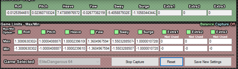

    Based on the recorded min/max after putting the ship all through it's paces everything looks good with SilentChill's xml, but cues are a mess as described in previous post. As I move on each axis the captured max of the correct axis sets to about 1 and minimum about -1. Makes sense and indicates pointers are correct. After doing all of them, they are all around +/- 1.
    So first question: Is it normal for the readings in the green box to be going way above the recorded max, while still capturing? Here is an example (image attached). This screenshot was taken fifteen seconds or so after just doing a pitch movement of the stick. Note the totally sane captured maxes, but the totally insane (in the green box) heave reading of 7.4, and sway reading of 5.4 despite the fact the ship is not being maneuvered. These are fluctuating faster than the eye can see between about 1 and 9. The surge reading is also over max, and it too should also be near zero.
    If this is not normal, hopefully it's a clue as to what is going on.

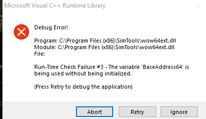

    Second question: Also I found this error message (image also attached) after I shut all the software down. I saw it once a few hours ago under the same circumstances but didn't see it after one or more other sessions. I hit retry both times I saw it, but just FYI, by the time I saw it both times I had closed Elite and Simtools down.

    Those numbers you are seeing I think are are exponential notation numbers they look big but they are actually very small. At least I think thats what they are lol

    The error is my plugin just ignore it , its got trace code from getbaseaddress. Thought I had sorted it in the last plugin :(

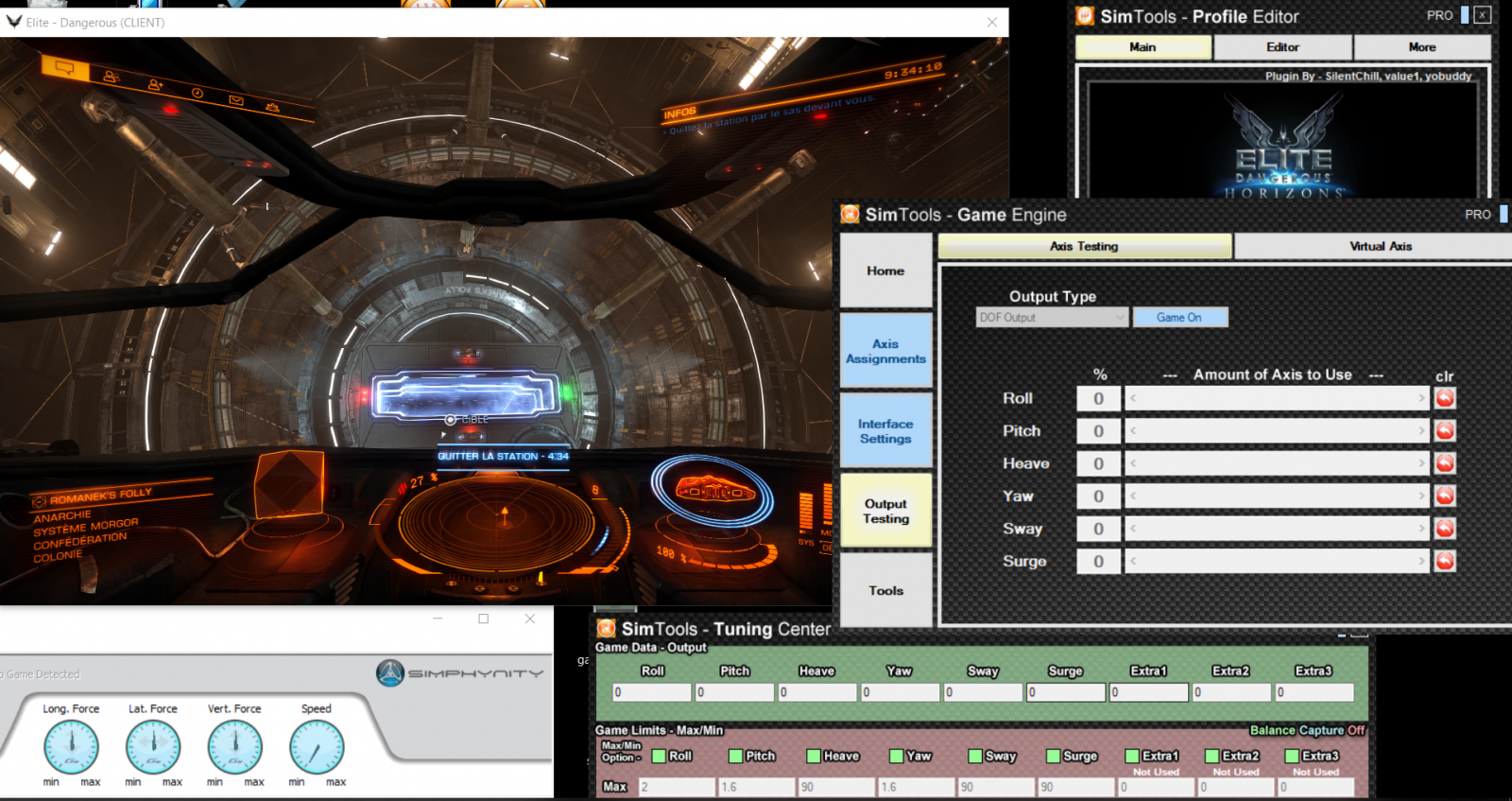

    I come back to you after making several screenshots so that you can help me solve my problem.
    Drive Link : https://drive.google.com/drive/folders/1Huxo4uiakJQPJrS0C9PisdDN3jSEDXmH?usp=sharing
    The GamePlugin folder of SimTools contains the default files "GamePlugin.dll, MaxMin.cfg, Offsets" and at the root of the SimTools folder the file "wow64ext.dll".
    The game is selected on Game Manager and Game Patched.
    SimTools Profile Editor confirms the activation of the plugin.
    The settings of SimTools Game Engine are correct because they work with the game "DCS World ».
    Simphynity software is well connected with SimTools software, "Output Testing" works well, the seat moves on all three axes.
    But by launching "Elite Dangerous Horizons 64bits", the Game Data Output values remain locked at 0 while the Game Limits - Max / Min values are validated.
    The seat does not move when the ship is moving.
    PS: I did not understand what the pointers are for and how to modify them.
    Do you have an idea to correct this problem ? Thanks
