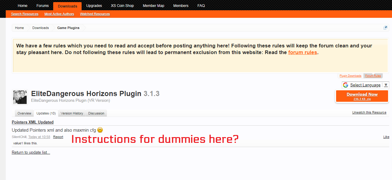

    Probably a good idea to give the exact path here right with that instruction:
    The offset file can be found here: C:\Users\<user>\AppData\Local\SimTools\GamePlugins\EliteDangerous64_Offsets.xml
    And for anyone unfamiliar, Appdata folder is "hidden" so you must enable "show hidden folders" in windows folder options to be able to navigate to this location normally.

    @SilentChill Just to minimize number of people coming here asking for help, is it possible to put instructions right on the page where you download the plugin? Here. [​IMG]
    I could help write them, being a "dummy" myself I'm good at writing instructions "for dummies" once I know how to do a thing! I would like to help however I can, doing this would allow me contribute in a small way.

    @SilentChill Here are my "for dummies" instructions for that location if you can/want to add them. Let me know if there are any mistakes.
    Important Instructions!
    1- Install Plugin according to SimTools documentation
    2- Open Plugin zip folder (this download) and copy EliteDangerous64_Offsets.xml to the following location:
    Note: Windows Appdata folder is a hidden folder. To access it go to windows "folder options", on the "view" tab tick the button for "show hidden files, folders, and drives" You will now see the Appdata folder in your user folder in windows explorer.

    With the next update of SimTools, you will be able to drop the .xml (EliteDangerous64_Offsets.xml) files directly in the SimTools PluginUpdater.
    They can even be zipped even.
    Take care,
    22,203
    154,681Coins
    +11,209 / 57 / -2
    I have added these additional instructions to the the Plugin Overview page.

    I notice that depending on how I navigate to the plugin download I wind up on different tabs (updates, overview, discussion) so it's still going to be easy for people to download it without seeing that there are instructions. Not sure there is anything to be done about that though, hopefully if they have a problem most will look at the overview before posting in the thread!

    I can appreciate that it may not be possible to remove the additional download buttons.
    But I can give an example how people miss the additional install instructions. If you use the Custom Google Search and enter 'Elite Dangerous plugin', then click the top result, it is the plugin discussion page and you can download the plugin from it without seeing the additional install instructions on the Overview page.
