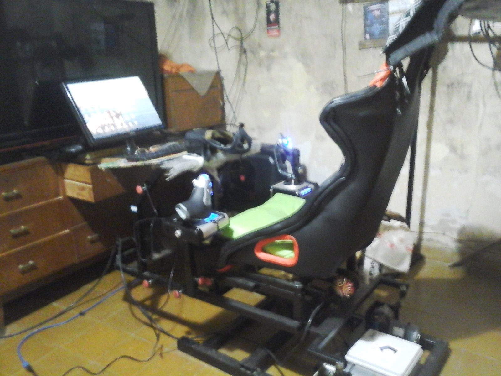

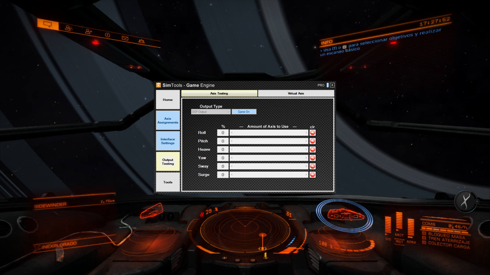

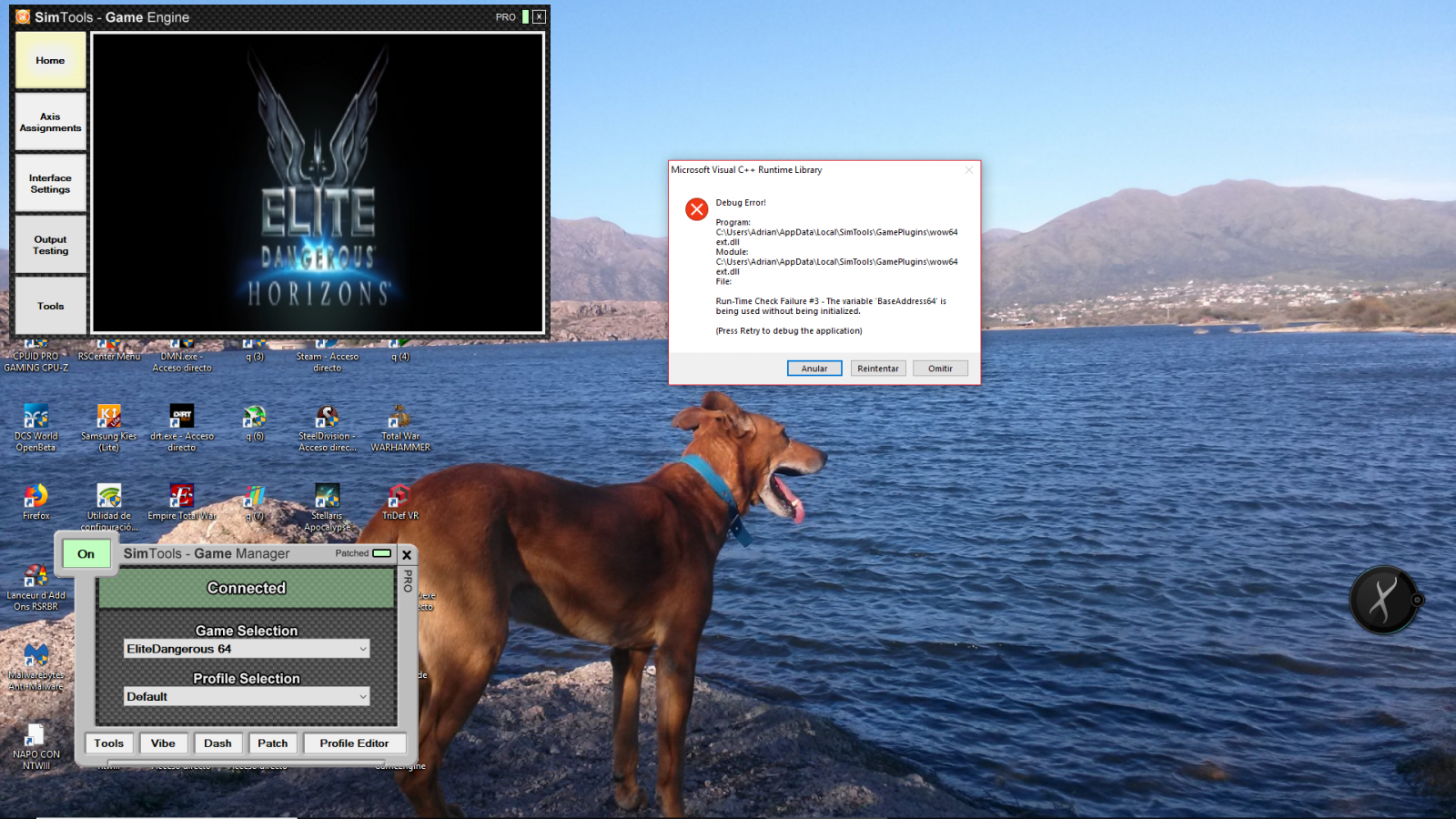

    i reinstall simtools an patch game ok, but when starting the game it takes the plugin but when moving the joystick nothing happens (when starting game before the menu it makes a small movement as if it were going to work but then the simulator does not move when moving the joystick ) Has anyone happened the same? Could you solve it? sorry i little english google translator post, i am spanish

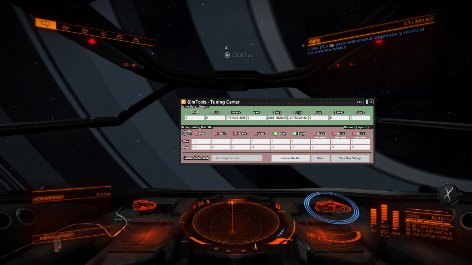

    Are there values showing in tuning centre ? have you set your profile up capturing min/max values ?

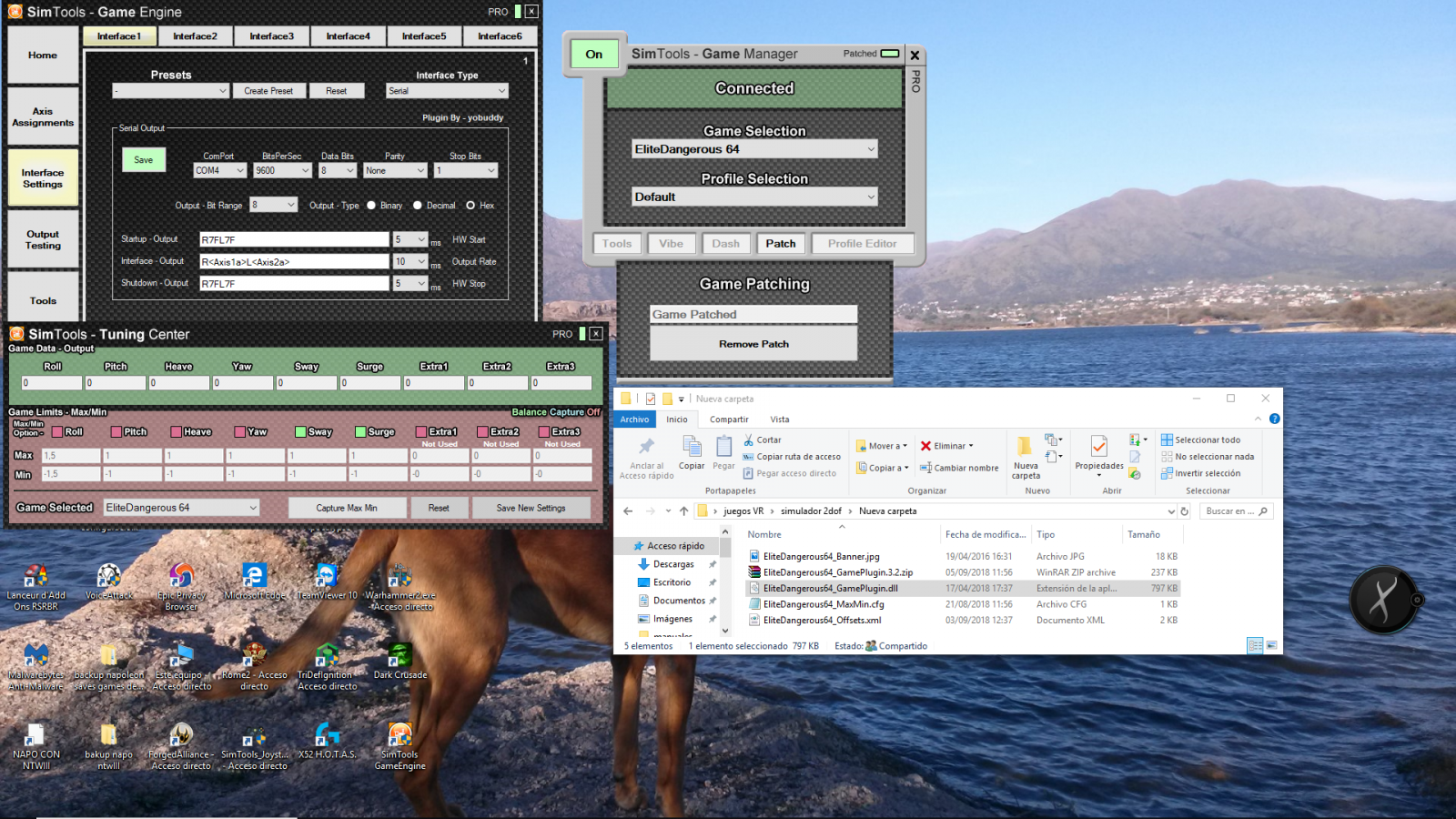

    Yes, the turning center show values such as roll 1.5 and -1.5 pitch 1 and -1 the same sway surge heave but does not capture min and max jostick when squeeze capture button, show error wow64dll instaled but not inicializated when elite dangerous run.
    If I start as administrator the game manager will not let me install the plugin ( wow64.dll error)
    I installed it without admin install fine plugin and wow64.dll error not show it
    but I will try manually
    ¿ how do i install the wow64.dll isnt comes in the rar of the plugin 3.2, where is it???

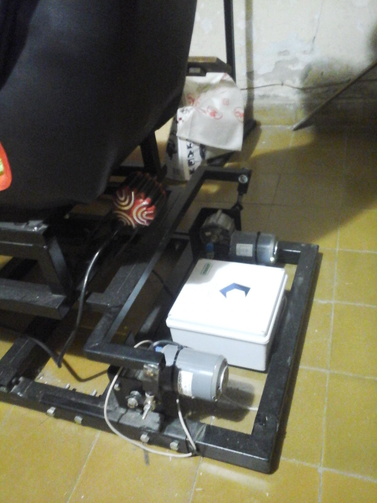

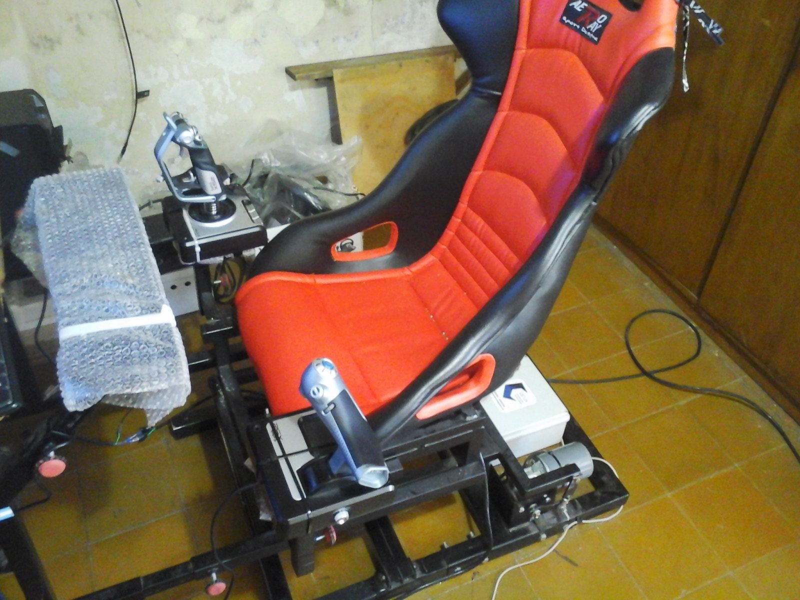

    this is my system 2dof
    i copy wow64.dll from simtools directory and paste on elite dangerous directory but not works
    important: game data output on green panel are not variables always show the same numbers
    show it on 2.png, stuck surge, sway and heave on this figures or numbers, they not moves.
    the simul move on game very very little when pass to supercruiser to normal space nothing more.

    plugin not contained on the rar wow64ext.dll
    Where is it????????????
    the same for getbasearess64.dll
