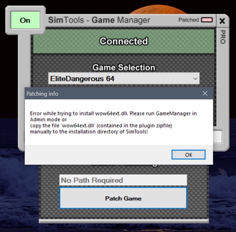

  7. greatg67
    greatg67 Member Gold Contributor
    Aug 14, 2018
    71
    509Coins
    +8 / 1 / -0
    Not sure if this is the correct thread? I'm trying to patch ED X64 for motion and this message keeps popping up?
  8. SilentChill
    2,653
    20,660Coins
    +3,593 / 34 / -0
    You need to install simtools as admin, the wow64 dll is missing
  9. greatg67
    Aug 14, 2018
    71
    509Coins
    +8 / 1 / -0
    Installed as ADMIN. This message still pops up when trying to patch?
  10. SilentChill
    2,653
    20,660Coins
    +3,593 / 34 / -0
    Have you installed to a different drive other than C ? That could be it maybe ?
  11. value1
    Jan 9, 2011
    2,192
    Zug, Switzerland
    14,294Coins
    +3,363 / 13 / -1
    Have you installed Simtools somewhere else than c:\programs 32\Simtools?
    EDIT: LOL, Silent was faster
  12. greatg67
    Aug 14, 2018
    71
    509Coins
    +8 / 1 / -0
    Installed in the correct

  16. greatg67
    Aug 14, 2018
    71
    509Coins
    +8 / 1 / -0
    I'm still trying to figure out why this won't patch. Does anyone have a patch for the non Horizon version? Does it matter?
  17. SilentChill
    2,653
    20,660Coins
    +3,593 / 34 / -0
    It works on both just not 32bit version
