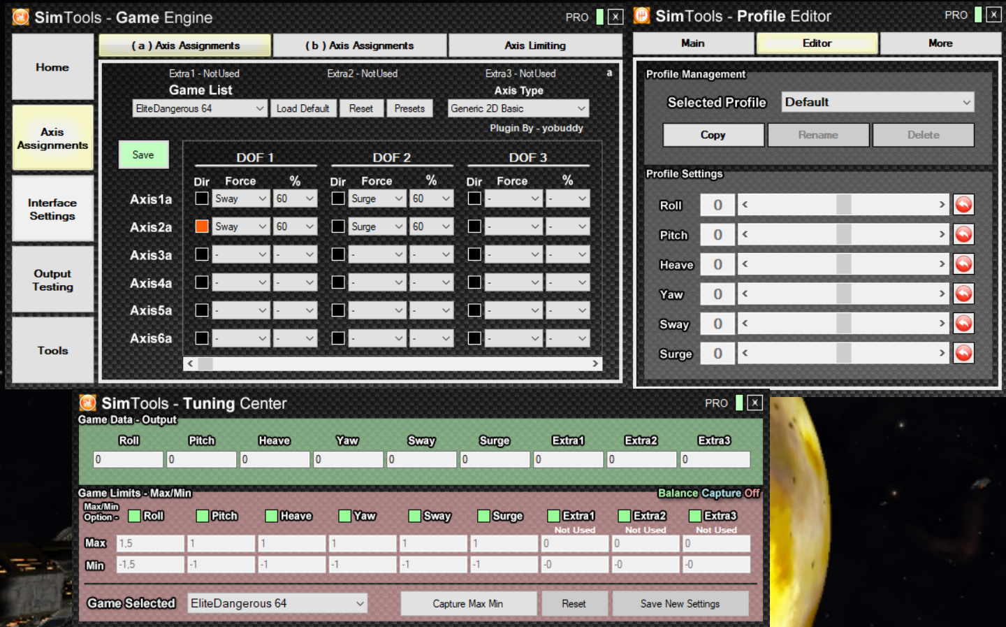

    What i found out so far is that i everything is done as it should, you can hear the motors somewhat but that tuningcenter is not displaying any values when capture/max/min is on like other games
    Also whats strange is when you patch the game, the xml gets changed to a older version (april)

    hello, download this add-on but as soon as the profile is active the 2dof is knocked down to the right and I have no movement in game, any help? Thanks

    You will need to provide more information.
    Have you installed the latest Offset File: https://www.xsimulator.net/community/attachments/elitedangerous64_offsets-zip.55526/
    Can you please most pictures of all of your settings, including the Axis Assignments and Tuning Center allocations.

    I have downloaded the file that is the same as the one I already had, the one I do not see where to download is the GetBaseAddress64.dll, I need to capture the configuration, it is the default with the plugin, I am new and I am very lost
