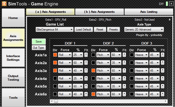

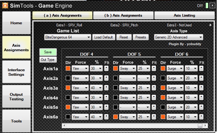

    Hi guys. I've hit a snag.
    Watched George's sim vid earlier and realised that while I get motion in my SRV - I'd not been getting the full pitch and roll moves like george's - I just get heave, sway, surge, yaw.
    Checked further and I get the correct game data for srv roll and pitch showing on extra1 and extra2 in tuning center and I see the corresponding inputs on the green sliders in game engine for SRV_ro and SRV_pit - all working as expected.
    In ED SRV demo mode I put the SRV into a pitch position and applied handbrake. Game engine showing no movement on bottom (blue) axis output sliders. Same for SRV in a roll position.
    It then struck me that in game engine, extra1 and extra2 aren't actually assigned at all. I have my axis 1a thru to 6a each sequentially assigned to roll, pitch, heave, yaw, sway and surge.
    As a further test I reassigned the roll and pitch terms with extra1 and extra2 in game engine axis assignments and restarted the SRV demo. Now roll and pitch motion works ok in the SRV but lose those moves if I then fly ship (as I expected).
    How do I include the extra1 and extra2 'inputs' into game engine axis assignments while still keeping the existing settings which are needed for my ship to roll and pitch?
    Seems like I am trying to control 6 axis but with 8 input signals when extra1 and extra2 are also needed.
    I include my current (ship) game engine axis assignments. Any pointers showing where to use the extra1 and extra2 values in game engine would be greatly appreciated. Cheers

    Your solution is so simlpe:
    I'm almost sure you just forgot to change the config in the XML for your 6dof. They are by default assigned to the Extra1-2, you have to modify it.
    to change via XML the option to use the SRV with the Roll / Pitch instead of Extra
    Hope helped,
    George
