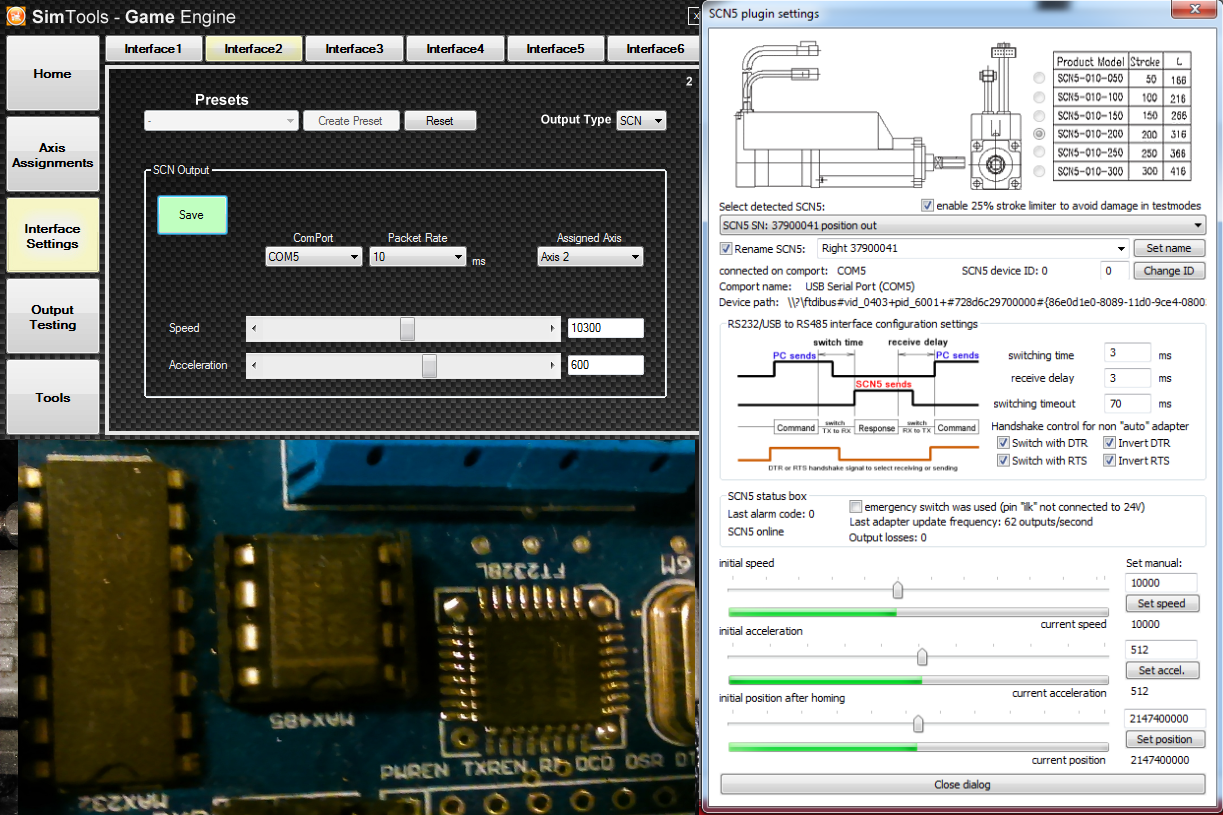

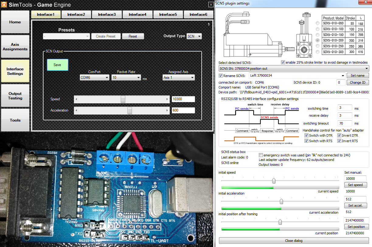

    Could we see your interface settings from Game Engine?
    (You should have 2)
    When you start SimTools they should both center?

    Hi, I haven't even used in a game, as unfortunately the Engine isn't controlling them yet.
    Oh, they don't move at all on startup. I do understand what you refer to though, as X-Sim does calibrate them.
    I also included the USB adapter photo. I don't know the manufacturer of the SCN5 microcontroller-box, they are sealed stainless-steel units with Red+Green status LED's on the side... not the white single-piece units as pictured in the config-diagram

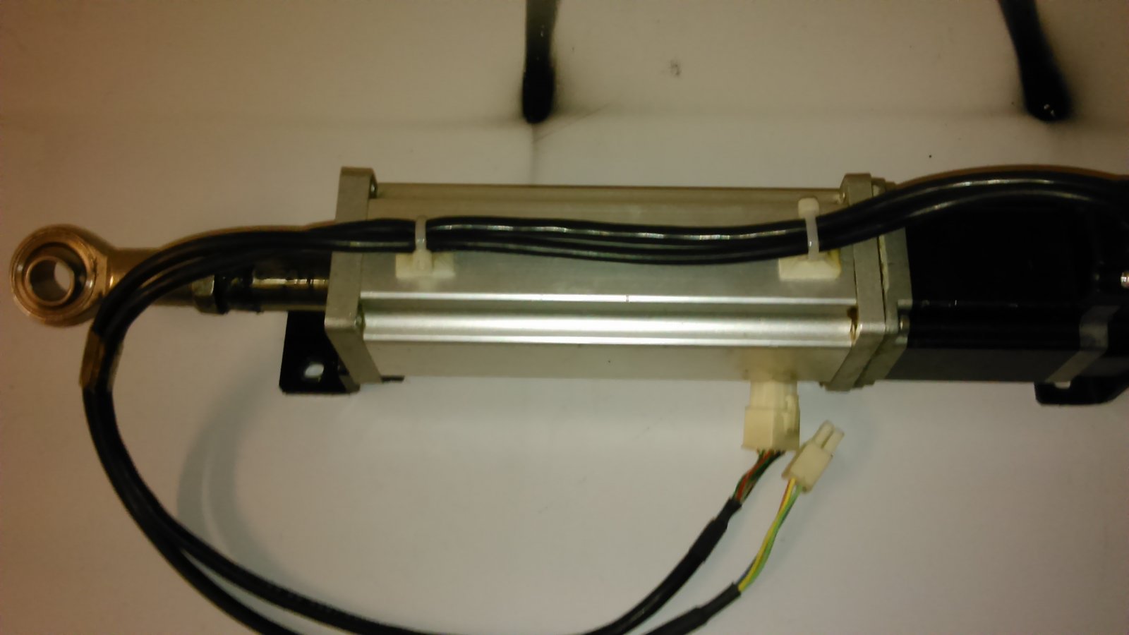

    This + steel controller-box + USB>232>485 adapter

    That looks like a SCN6 to me?
    Which will be supported in the next version of SimTools

    Yes, Only the SCN6's have a "steel controller-box".
    The SCN5's have it all built into the actuator itself.
    I believe you have a SCN6 there not a SCN5?

    That clears it all
