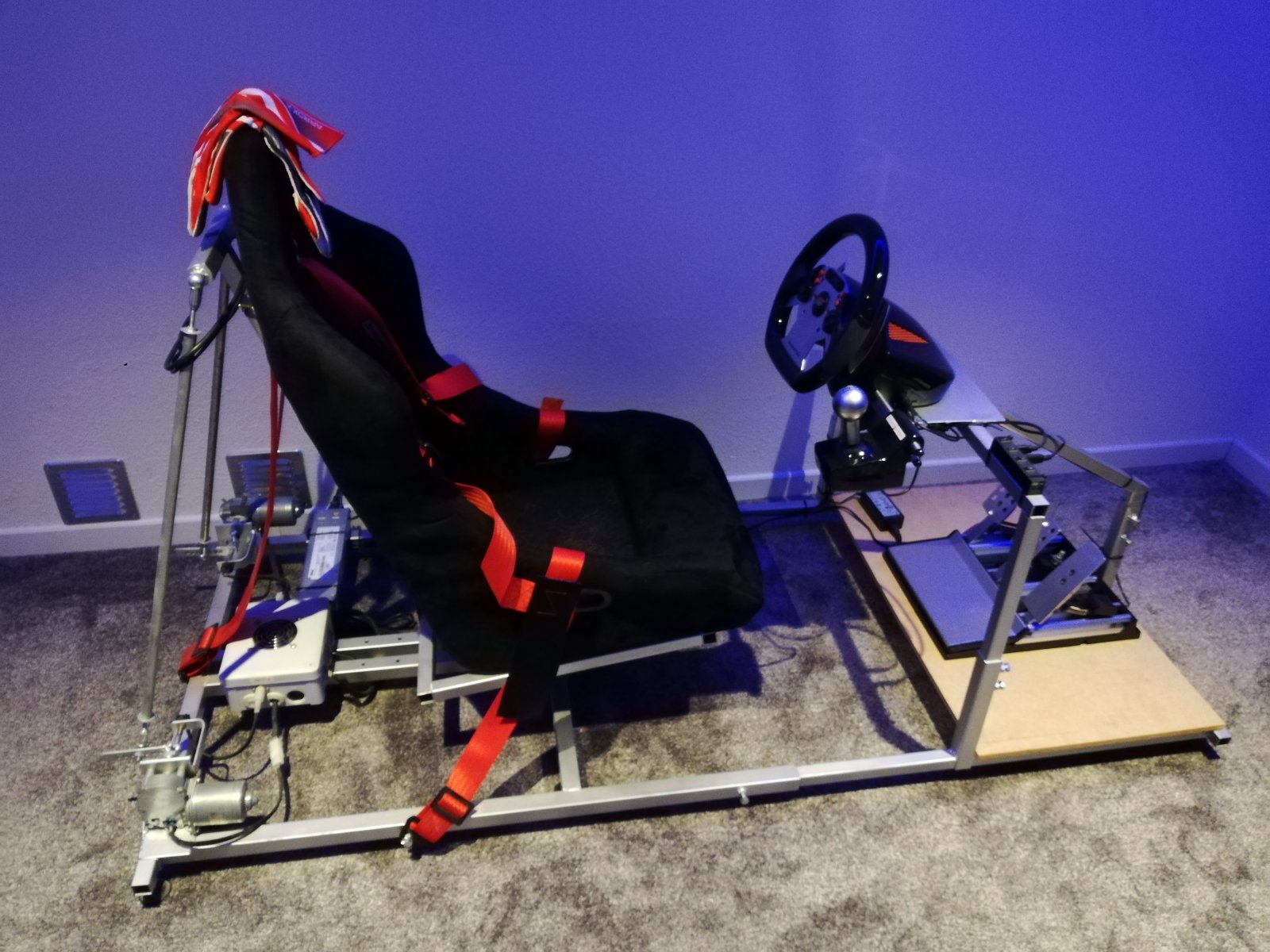

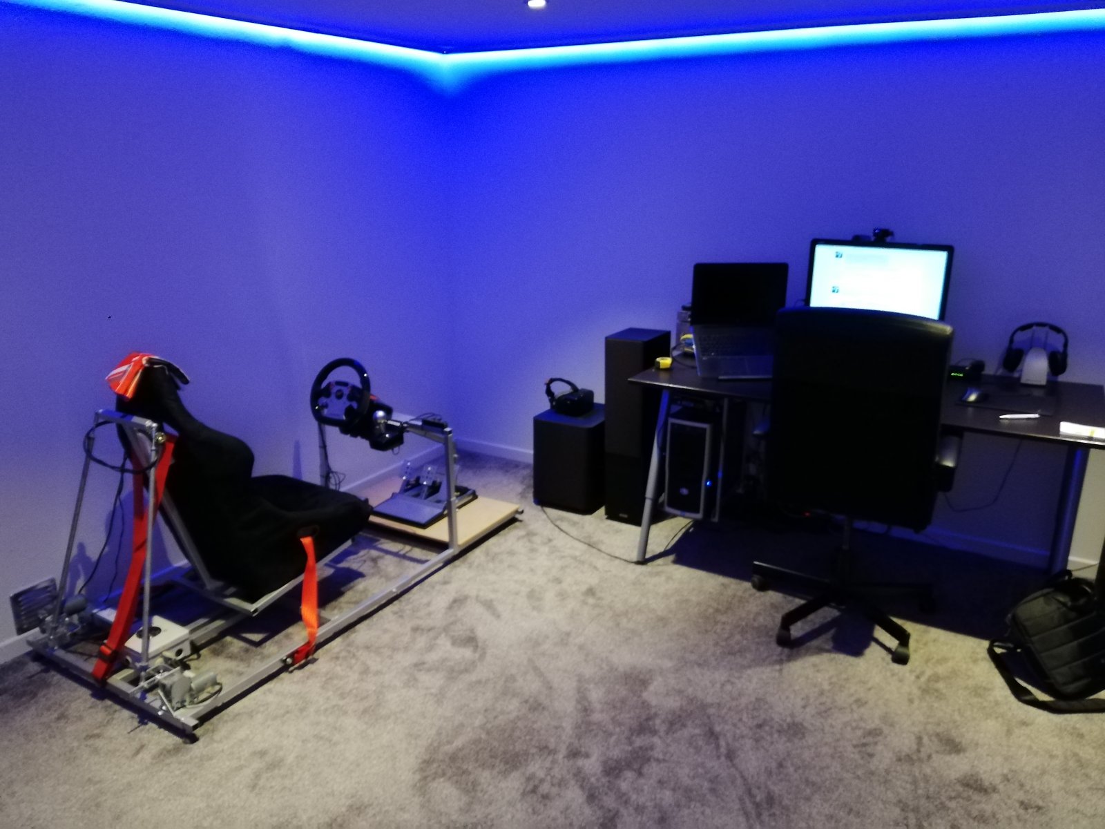

    Back again after a long period :) in the mean time i moved into another home, which needed some attention :roll. But the main thing is that my game / office room size is upgraded:thumbs.

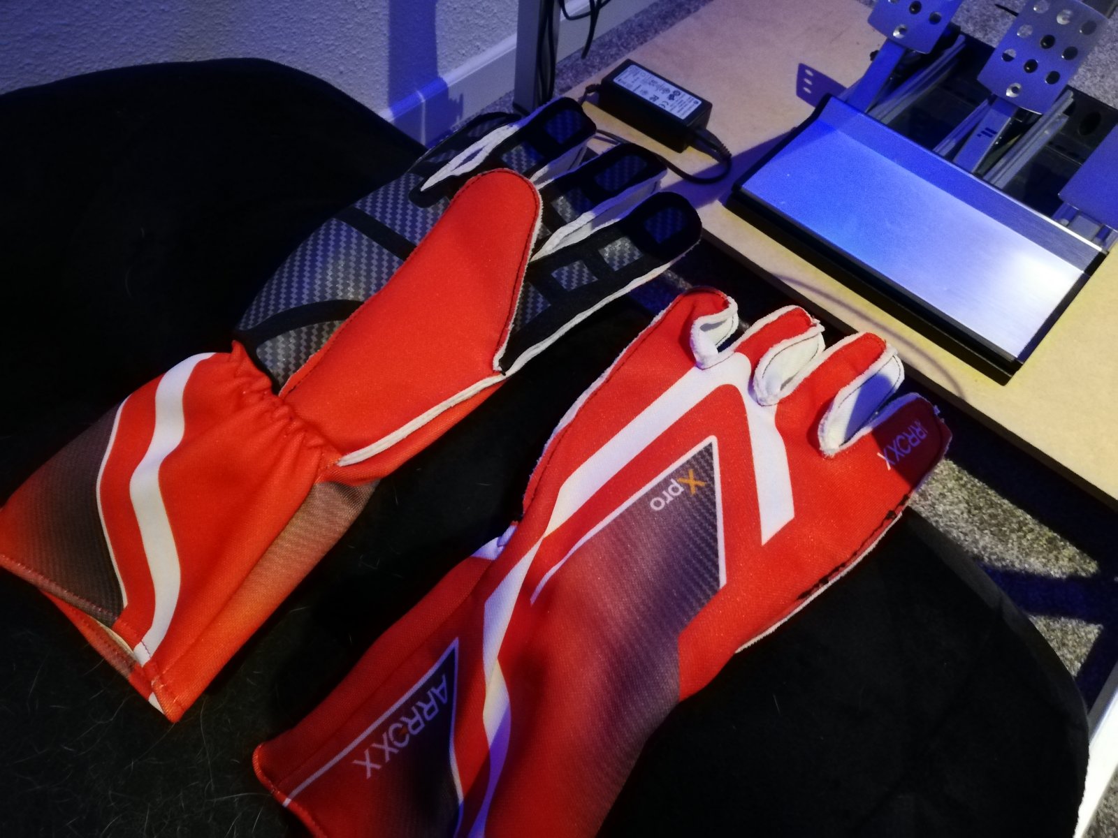

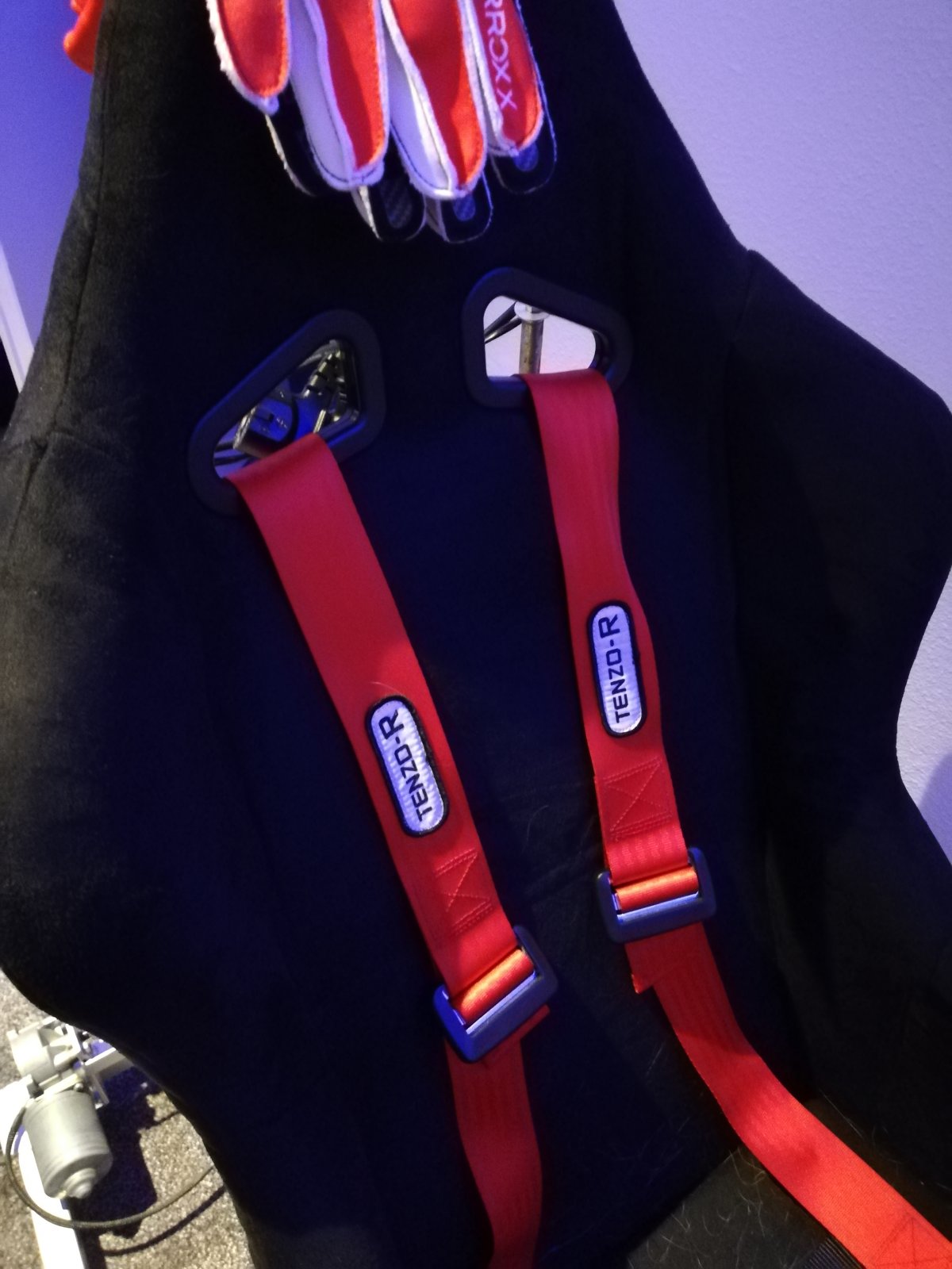

    Now that autumn is coming i have some time for the indoor hobbies. My simulator is mainly as it was last time around. I added some seatbelts, tidyed up the cabling and got a pair of gloves.

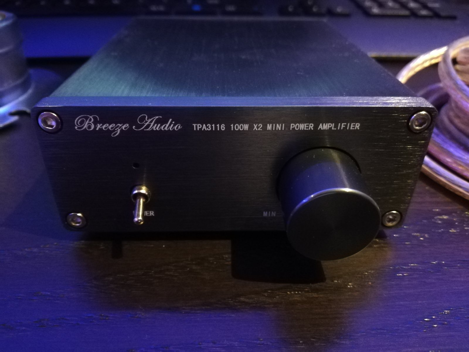

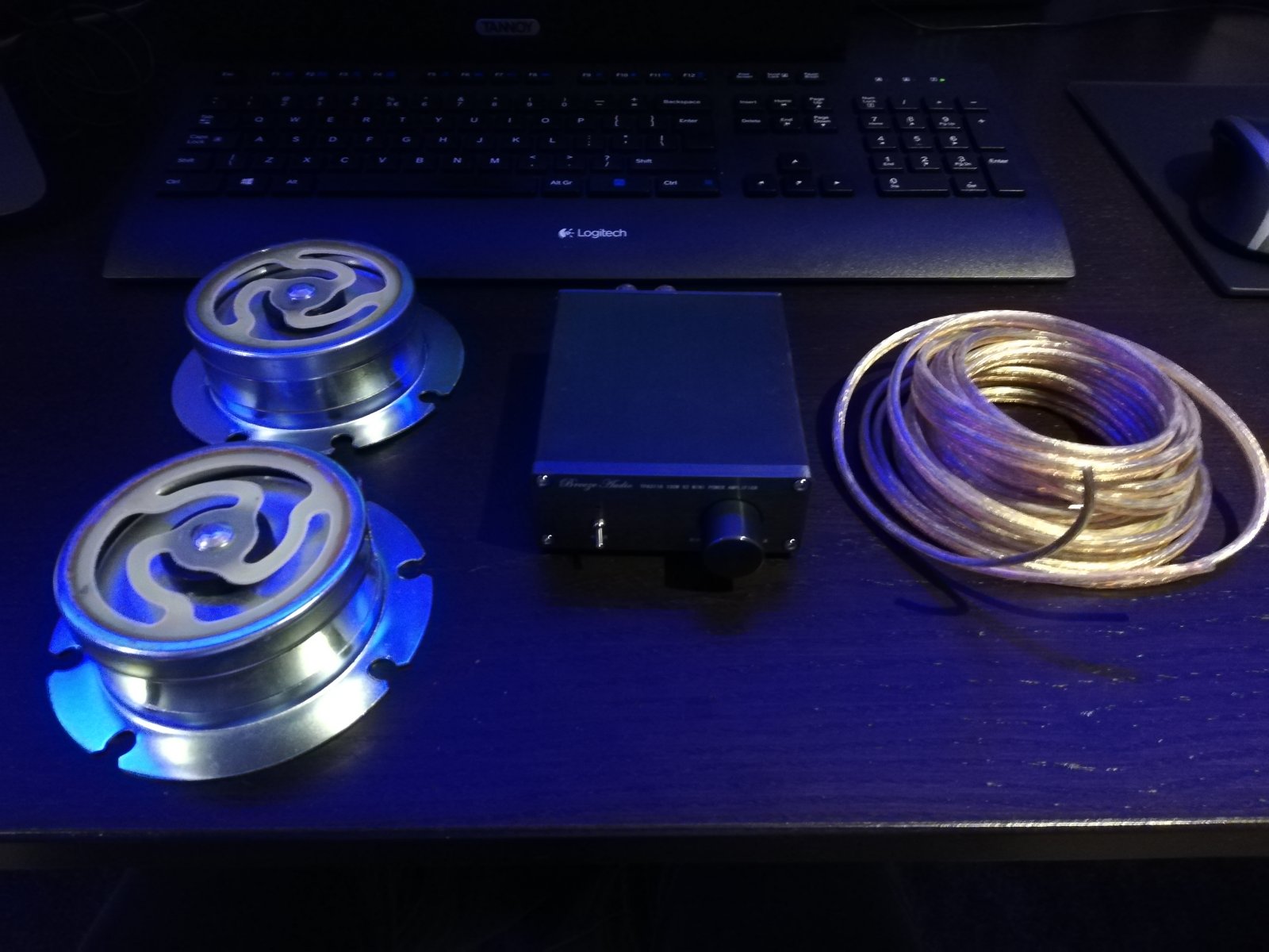

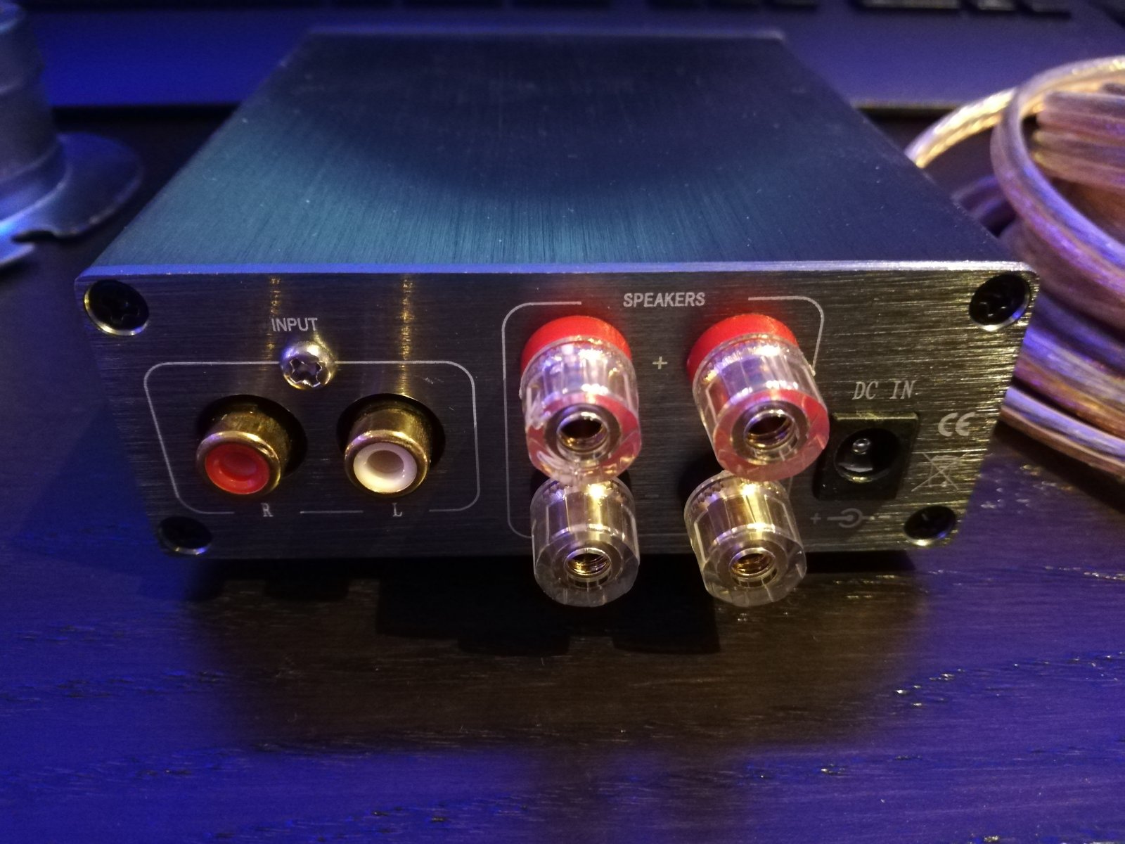

    Buttkicker / bass shaker
    Lately i had an afternoon af simracing at a simracing shop here in the Netherlands. The didn't have a moving simulator but they did have a buttkicker attached to the seat. I was immediately impressed, you get a lot of feedback through these, which you not always get with movement alone. So my future project was born!
    I noticed GameVibe is part of SimTools and can be used with a 2nd soundcard. Looked up some tutorials on youtube and decided to go with this setup:
    USB Soundcard, powercord and audio cable are not delivered yet so i have to wait a little before assembly can begin:(. For now i'm planning to attach one kicker to the seat and the other one on the frame around the pedals somewhere. Is that a common setup? anybody has the same setup?

    Update and a question :)
    Coming along nicely with setting up the new hardware with GameVibe. I also update SimTools to 2.4 (was on 1.x) and therefore needed to calibrate everything again. I also update the SMC3 firmware to 1.0.1.
    Now i encounter some strange behaviour; Some of my axis have the strange behaviour of a fast motion jerk at the end of the range. For example; when i test my yaw axis it moves nice and slow from 0 to let say 90% and then a fast jerk to the end of the range. when i reverse it starts to move at about 65 % and when around 0 it jerks back. (Almost looks like exponential movement) Anyone encountered this? i did a load of testing in Assetto Corsa, thinking it was a profile setting, but i can replicate this behaviour in the Axis Testing too...:(
    EDIT: the movement in SMC3utils seems perfect, so i think it has to be something with simtools / settings...

    Try this SimTools 2.5 update fix for Wndows v2004: https://www.xsimulator.net/communit...lation-software-simtools.63/update?update=753

    @noorbeast The Simtools 2.5.1 update solved the problems! Back to testing and setting up GameVibe! :cheers
