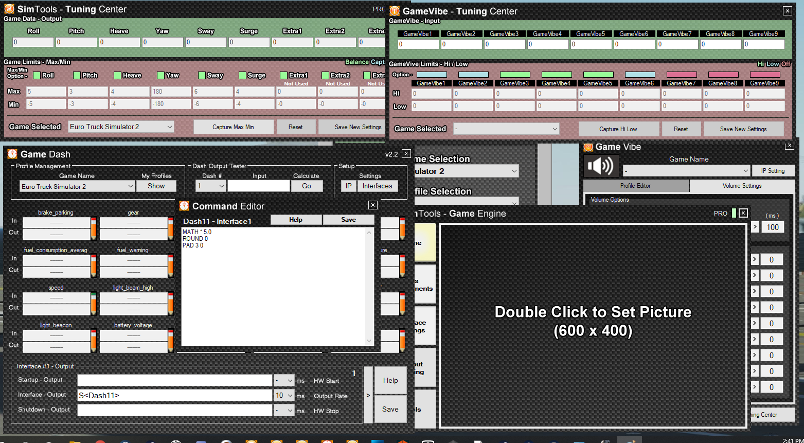

    I am very sorry for replying a year late. But for anyone that is having trouble (or even you Paul if you are still having trouble) here is a screenshot of my Dash (and other) settings:

    +2,177 / 19 / -1
    These are just guesses but...
    1. Your parents took away your computer and simulator rig.
    2. You are having a power outage.
    3. Aliens have landed and stolen your, and only your, Steam account.
    4. You found a girlfriend (or wife, not and wife...very important distinction) and you would much rather spend time with her.
    Kidding aside. As @paulopsx2 mentioned; we need more information. Please post these things as well as making sure you have telemetry added to the command line in Steam.
    1. Screenshots of the game manager
    a. Screen showing the Game Manager while the game is running, it should turn blue and say "Connected" if it is connected to the game.
    b. Screenshot showing the Game Patching Path, if the "Patch Game" button is not greyed out then you have not yet patched the game for Simtools use.
    2 Screenshots of the game engine showing the sub windows
    a. Interface Settings
    b. Axis Assignments
    c. Tuning Center (While game is running)

    39Coins
    Thank you. I've solved it. I don't know why the language is set to English (United States) doesn't work, but English (UK).
