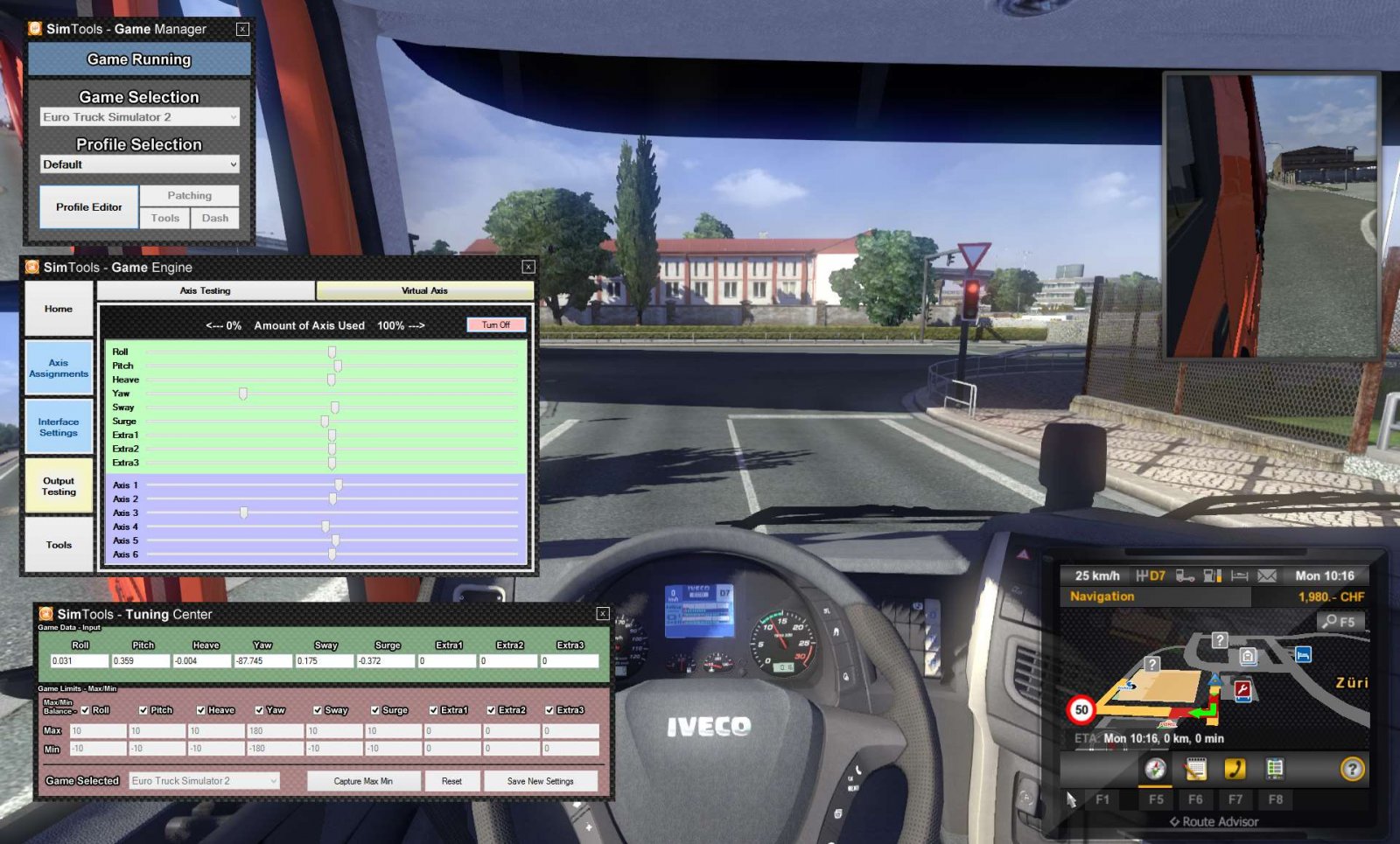

    Hi Historiker, did you do something special to make it run? I have Windows 7 64bit and cant get it to run. I have a steam version of the sim. Tried LFS and works just fine. But eurotruck just dont want to work. Axis Assignment same as LFS but for Euro truck simulator 2 in Game List, clicked Save Settings, Interface Settings Presets set to SimAxe , Output Type SER and clicked Save. Game Manager says Game running in blue and Game Engine Virtual Axis are turned On but nada nothing is moving!
    My installation folder is not on C: drive but plugin is intalled in my installation folder anyway.
    I need to get that game running ...
    Thank for your help.

    Hi @mugge66

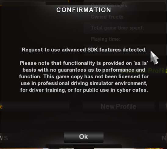

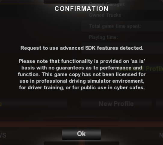

    This might help:
    Exit the game.
    Delete the file "SimTools_ETS2.dll" in directory ..\Steam\SteamApps\common\Euro Truck Simulator 2\bin\win_x86\Plugins" (and maybe all other files in the directory too).
    Unpatch the game in GameManager
    Patch the game in GameManager.
    Start the game
    If it worked there will be a message like this during startup:
    Let me know if it worked, please.

    I have done that but it doesnt help, I do get that message and my simulator is calibration at startup. but when playing game i get no motion. In tuningcenter there are no action.

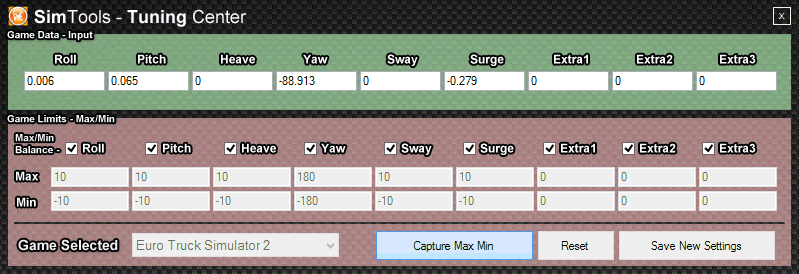

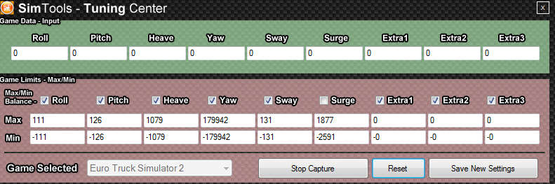

    Did a new install from steam, it works in a way. As you can see on game data nothing shows, but when i do a new capture this shows up. and yes there are movement in game but it´s complete out of control.
    The simulator is moving me in all directions without any control.

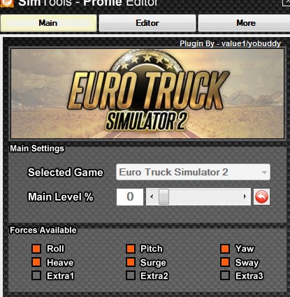

    Dont understand this, There has be something odd with this plugin. I have Surge witch have very slow reaction, and sway witch seems to make the simu move left and right in some uncontrolled movement.
    Do anyone else have these issues. my Tuning center still not shows any action. ive been playing around with different settings and what is wierd is
    iracing /ac / rfactor works perfect. ?? i only have these problems with eurotruck
  9. yobuddy
    51,747Coins
    +5,205 / 19 / -0
    The main level% smooth's the output to the simulator. (basically meant as a quick for a kids ride etc..)
    It will still move around, but with it all turned down like you have it, it will be very slow and won't match the output cues from the game.
    Set it back to 100 for the most accurate ride!

    Anyone got it going? Tried everything... older versions x86, new x64 admin access, nothing works.

    It runs fine here.
    Please check, if there is a file SimTools_ETS2x64.dll in C:\…\Steam\SteamApps\common\Euro Truck Simulator 2\bin\win_x64\Plugins and/or SimTools_ETS2.dll in C:\…\Steam\SteamApps\common\Euro Truck Simulator 2\bin\win_x86\Plugins.

    Yes I also tried deleting them unpatching and patching again as you said before. And still nothing. LFS, Rfactor is working great but ETS2 write SDK feature detected but it show nothing on virtual axis or Dashboard

    Good start.
    Have you tried fiddling with the Max/Min values in Tuning centre? These values are probably too high. Please check:
    TuningCentre.gif [/quote]

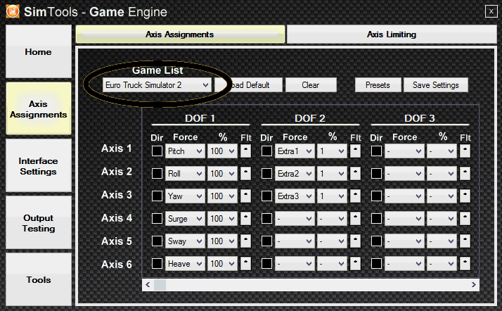

  20. value1
    Jan 9, 2011
    2,192
    Zug, Switzerland
    14,296Coins
    +3,363 / 13 / -1
    Also: Check, if there is something wrong with your Axis Assignments for ETS2:
