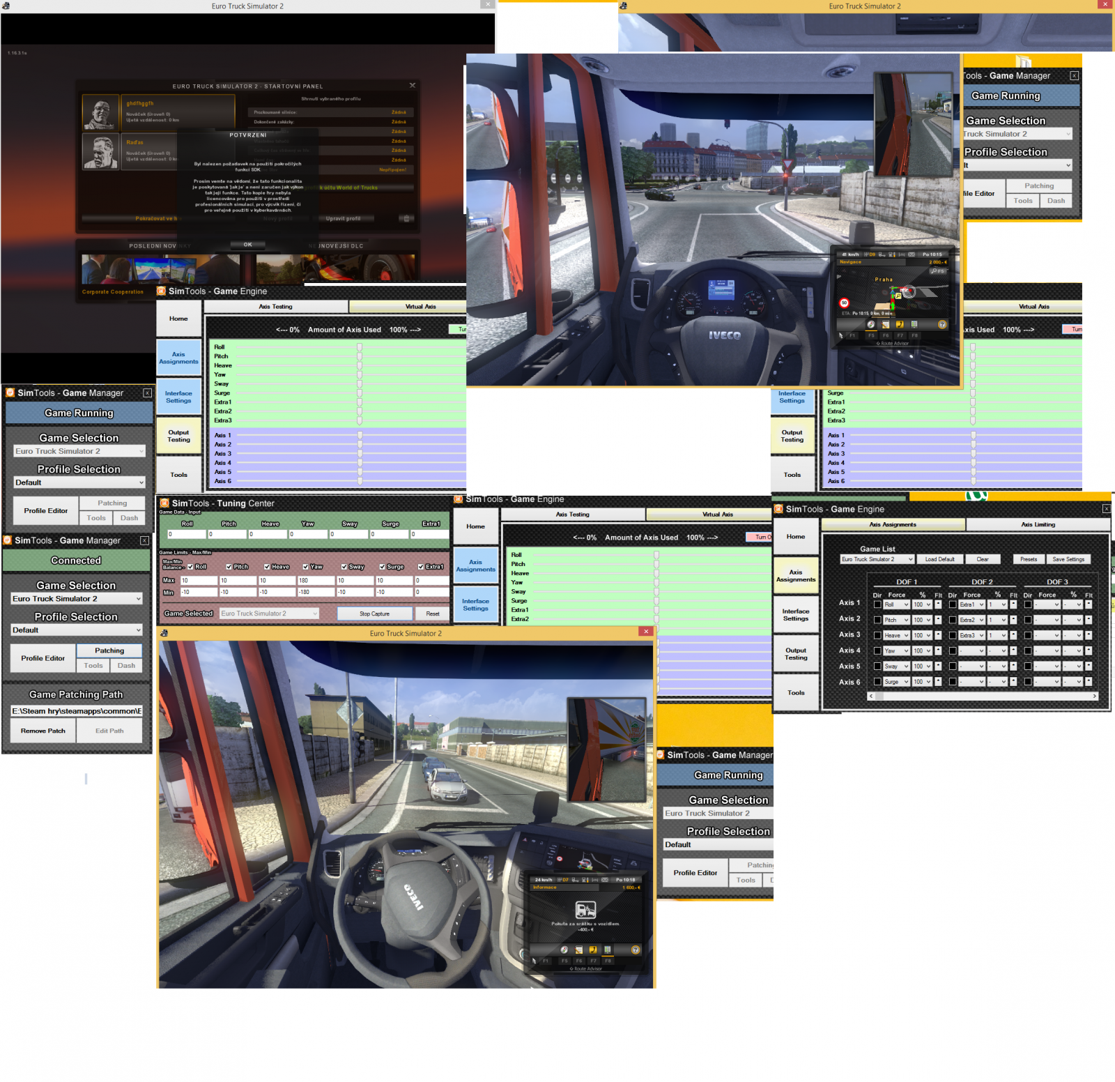

    2DOF, DC motor

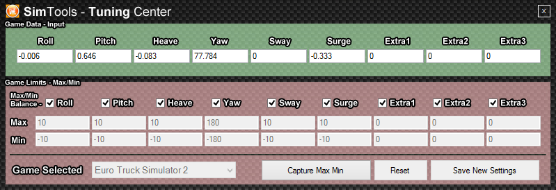

    Tried to picture everything while driving, Connected, SDK feature notification but no movement Nový rastrový obrázek.png

    Ah axis settings are a wee bit off, And what Interface have you set up and are using. ?

    For this picture i just tried preset all out. It´s same with mine surge and sway Axis1 a axis 2 which work on Rfactor, LFS, Project cars. I´m using Arduino Mega. As I said everything else I tried worked great except this game. Tried it on 5 PC´s now. Everytime same.

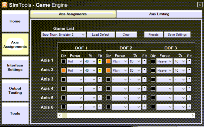

    As @eaorobbie says, your Axis setup looks a bit odd. I was advised by members to assign each DOF to an axis, it looks like you have assigned an Axis per DOF, but you only have two Axis. So in your setup, all that is being acted on is Roll, Pitch, Extra1 and Extra2. (??)
    This is my screenshot of my settings in ETS2. (Excuse the quality, I was remoted in to my home PC)
    However, regardless of settings I guess you should still get some numbers in the Tuning centre... so that is strange...
    I checked your patch path and that looks OK too...

    I just made it like in value1 picture of axis but still same like any other setup. No movement. Tried to disable Eset antivirus. Not a change. Tried to disable DLC. Tried to change game language to english. Loosing hope to get it done.

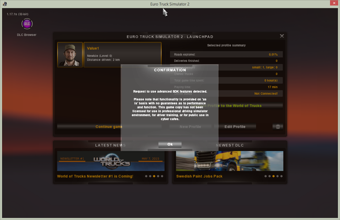

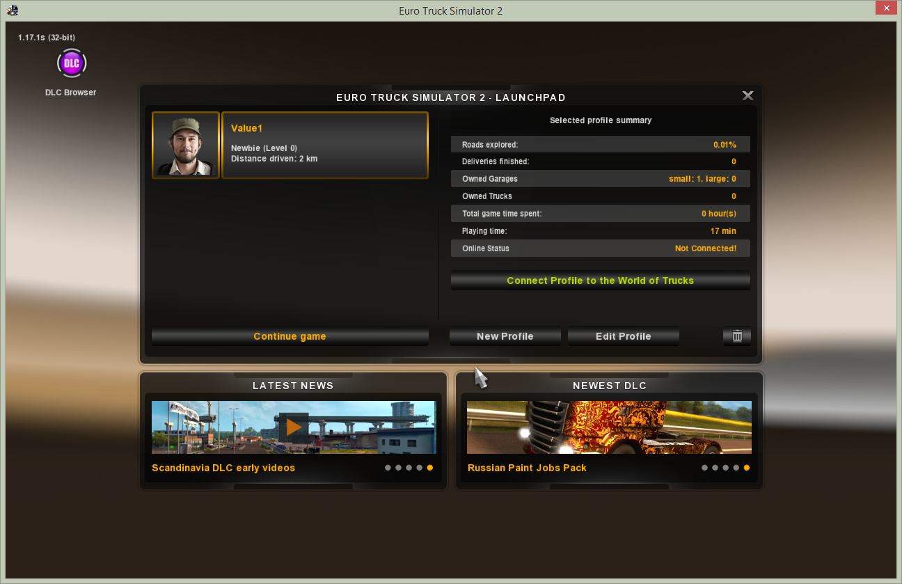

    @mabuam
    1.17 works fine:
    Do you receive a confirmation message during startup about the use of an "SDK"?
    If not, please re-install the plugin!

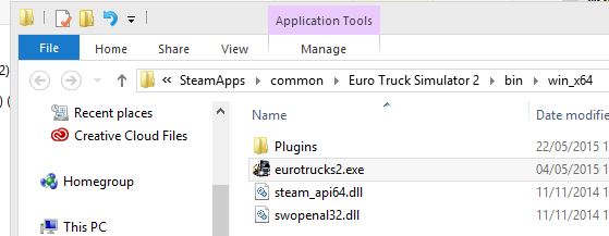

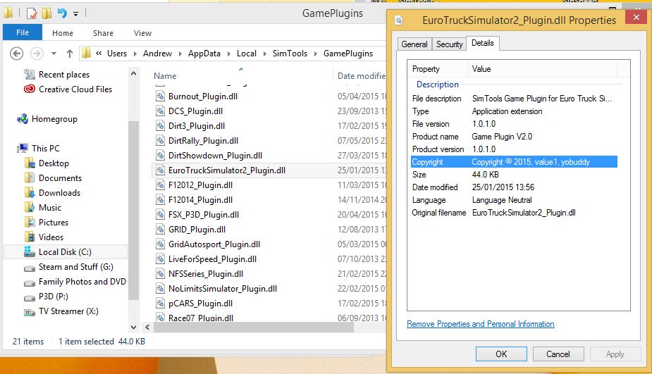

    @Scratch - I reinstalled the plugin and fired up ETS2, my version is stating 1.17, and without the Scandanavia DLC. I tried both 32bit and 64bit and the motion is working fine for me.
    These are the steps I took.
    Installed the plugin as normal and ensured it was present in the Simtools folder "GamePlugins". The Version Number is 1.0.1.0
    Then fired up ETS2 and the Sim responded (all blue)

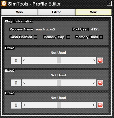

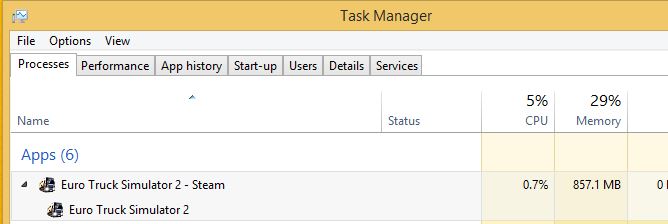

    Then I checked that the Simtools GameManager was seeing the correct
    process "eurotrucks2.exe". It is:
    Task Manager:
    File Location:
    Simtools Profile Editor: (Process name)

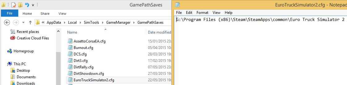

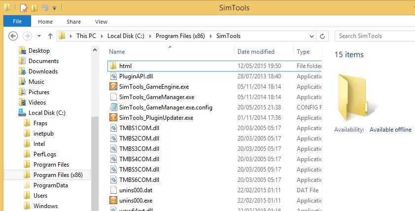

    Then I checked my GamePath was OK:
    And finally that my simtools directory was OK.
    (The cut off filename is wow64ext.dll)

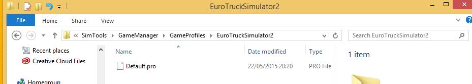

    And that GameProfiles had this file:
    And that is pretty much it.....
