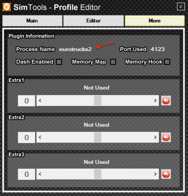

    I installed American T.S. but when I go to patch it, it says wrong folder. I even tried manually rename A.T.S folder to ETS2 making sure to match the exact spelling of the real ETS2 folder. Still says invalid folder. Any ideas..?

    @DaVinster - I think when patching a Game it looks for the .EXE rather than the folder. Try renaming the ATS .exe to match the filename of ETS2.
    You can check what .exe the Game Manager is look for here:
    Open it up and click "Profile Editor", then click more in the top right.
    For ETS2 it is eurotrucks2 (.exe)

    Good suggestions. I'll try those couple suggestions next..

    If you simply want to remove the Patch path, you can delete the .cfg file for the game here:
    C:\Users\<yourprofile>\AppData\Local\SimTools\GameManager\GamePathSaves
    For ETS2 it is EuroTruckSimulator2.cfg.
    Then the "Edit Path" button should become available again.
