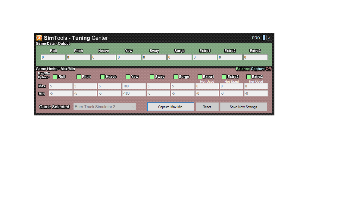

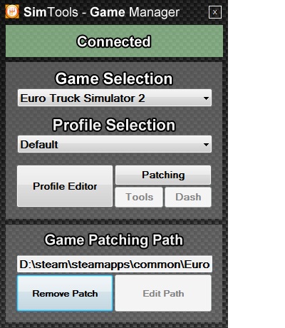

    hi all
    I'm in the same situation as many people
    I installed ETS2 with steam
    In game manager: patched the game in D: \ steam \ steamapps \ common \ Euro Truck Simulator 2
    The 2 patches 32 and 64 bits are present
    Game manager goes blue at the launch of the game and marks well game running
    The game clearly indicates the call screen to the SDK
    But no data passes in tuning center, everything stays at zero.
    I re-read all this topic and tested everything indicated, but nothing works
    I really like this game, but I would like it to work with the simulator
    I have assetto corsa, LFS and dirt Rally that work with the simulator game engine.jpg game manager.jpg

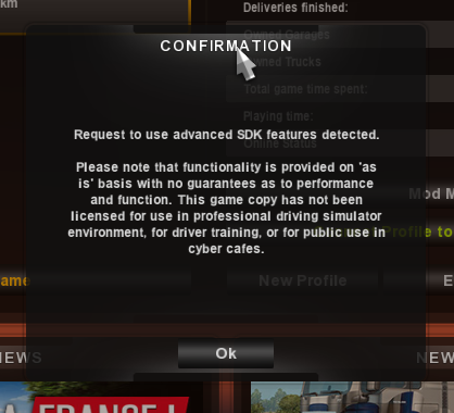

    Is there a message like this in the Launch Pad when you start ETS2
    If not you have to check, if you patched the game correctly.

    Thank you for your answer, and as indicated above, I have this screen that appears when I run ETS2

    There is a known language bug that may be the culprit: https://www.xsimulator.net/community/threads/euro-truck-simulator-2-plugin.4758/page-6#post-117813

    After having tested the language change of windows, deleted the patch
    Restart the PC and under game manager; Replacing the patch ...
    The simulator moves !!!!!!!:cheers
    The effects are completely bizarre at the moment but I think I still have adjustments to make
    I need to make an adjustment in the tuning center.

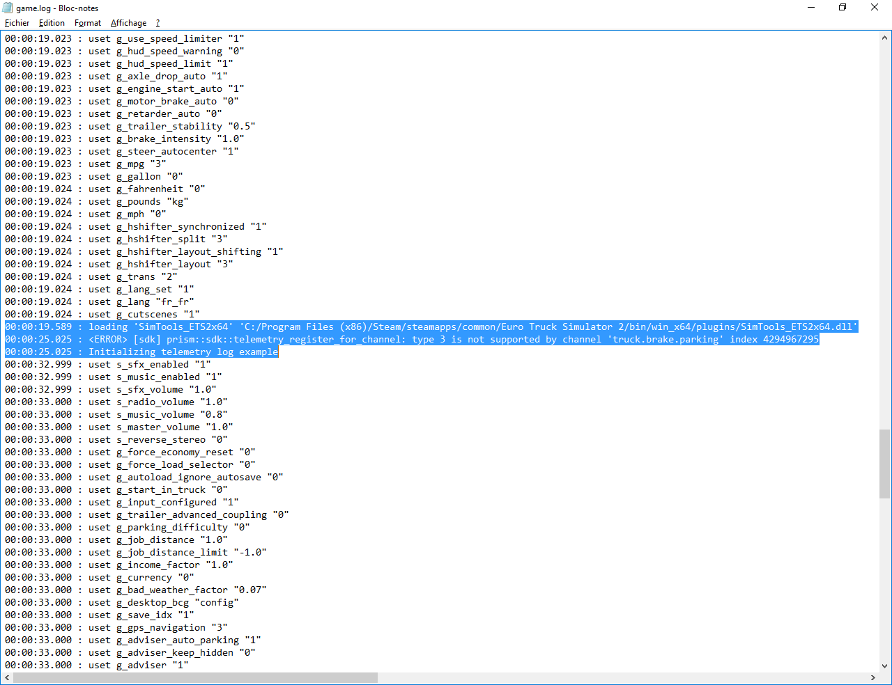

    Good evening after the installation of SimTools V2 and reinstall the plugins I have two games for the moment that does not work.
    GameEngine and GameManager changes color well but nothing happens on euro truck simulator 2 and NoLimits Rollecoaster Simulation if someone to an idea it would be nice thank you all
    bonsoir apres l'installation de SimTools V2 et réinstaller les plugins j'ai deux jeux pour le moment qui ne fonctionne pas.
    GameEngine et GameManager change bien de couleur mais rien ne se passe sur euro truck simulateur 2 et NoLimits Rollecoaster Simulation si quelqu’un à une idée ce serait gentil merci à tous

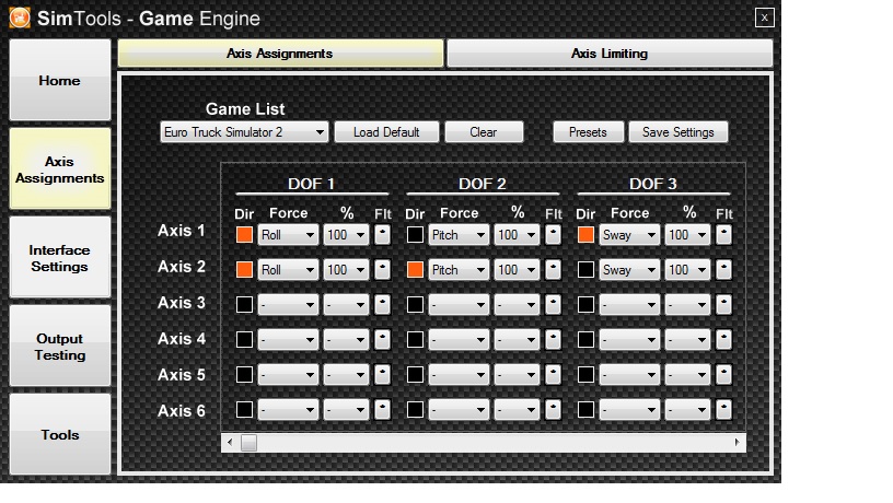

    SimTools 2.0 Input Settings - The difference from SimTools 1.3 to SimTools 2.0 in setup is that instead of axis defined like this <Axis1> it is now like this to designate grouping for a or b <Axis1a>

    Have you tried a base run for your Tuning Center values and can you post a picture of your Tuning Center while the game is running: https://www.xsimulator.net/community/faq/set-base-tuning-motion-values-in-the-tuning-center.122/
  17. DE CASTRO
    DE CASTRO Gaby SimAxe Beta Tester Gold Contributor
    Mar 19, 2015
    116
    Cahors France
    611Coins
    +24 / 1 / -0
    2DOF, 3DOF
    That's what happens
    voila ce que ça donne
  18. noorbeast

  19. DE CASTRO
    Mar 19, 2015
    116
    Cahors France
    611Coins
    +24 / 1 / -0
    2DOF, 3DOF
    I have that too if it can help thank you
    j'ai ça aussi si ça peut aider merci
