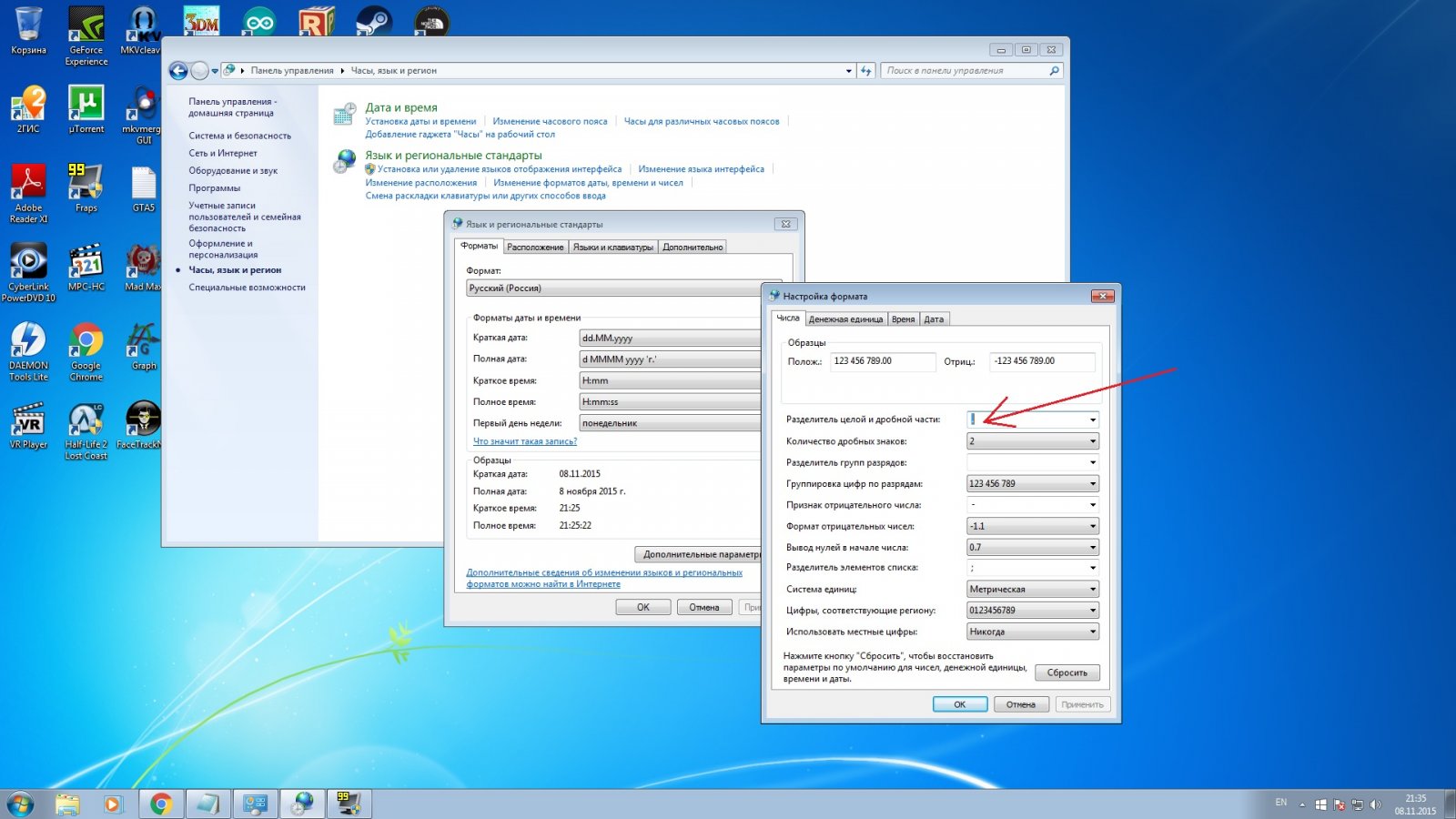

    i succeed with ATS and ETS2 , the both games works now but simvibe don't work anymore, conflict maybe ?
    i only changed the virgule for a decimal point in windows like here :
    ps : i re-patch the game too

    super it works thank you
    super ca fonctionne merci
