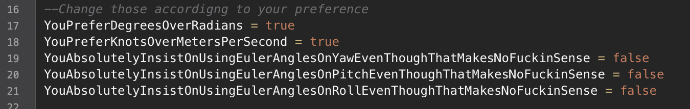

    you need to edit the script. Change the "false" argument to "true" .
    If you absolutely insist on using Euler angles instead, you can open the export script that resides in SavedGames/DCS/Scripts/Hooks and set these three variables to true:
    Code:
    YouAbsolutelyInsistOnUsingEulerAnglesOnYawEvenThoughThatMakesNoFuckinSense = true
    YouAbsolutelyInsistOnUsingEulerAnglesOnPitchEvenThoughThatMakesNoFuckinSense = true
    YouAbsolutelyInsistOnUsingEulerAnglesOnRollEvenThoughThatMakesNoFuckinSense = true
    It will give you Euler angles exported (Yaw, Pitch, Roll).

    Hey @janio,
    At first glance it may seem like the joystick input is sent to the platform, but that is NOT the case :) It is the roll rate of the aircraft that is used to drive the rig. In normal flight those are somewhat correlated (because it is the control input that eventually generates the roll rate), still not the same.
    Option 1: (for men)
    Try to understand what a person in the cockpit actually feels. You cannot feel bank (Euler angle), at least not while flying in an aircraft. You can also not feel the angular rate of the vehicle directly. What you CAN feel very well are angular accelerations. The change of the change of the angle around the vehicle axises. Yes, there are two "changes" in that sentence :) However, this data is not directly available for export, so what a motion cueing software does is this: Use the angular rate, which is available, send it through a high pass filter (aka "washout", to get a signal that fades back to zero after a while), then use a single LP to convert the angular rate into an angular position for your rig to use. It might seem counter intuitive at first glance, I understand.
    Option 2: (for chicken)
    Go to SavedGames/DCS/Scripts/Hooks and open the export script in a proper code editor. Change the three long variables called "YouAbsolutelyInsistOnUsing......" to "true".
    It will give you Euler angles exported, so you will get the behaviour you're looking for, but at the very least you should do a full 360° roll and a full 360° loop to be aware that Euler angles come with some severe ...well... artefacts, for lack of a better word. Try it out.
    AFAIK, @value1 in his plugin has implemented some "anti-rollover" functionality, that mitigates the problem.
    Your Choice :)
