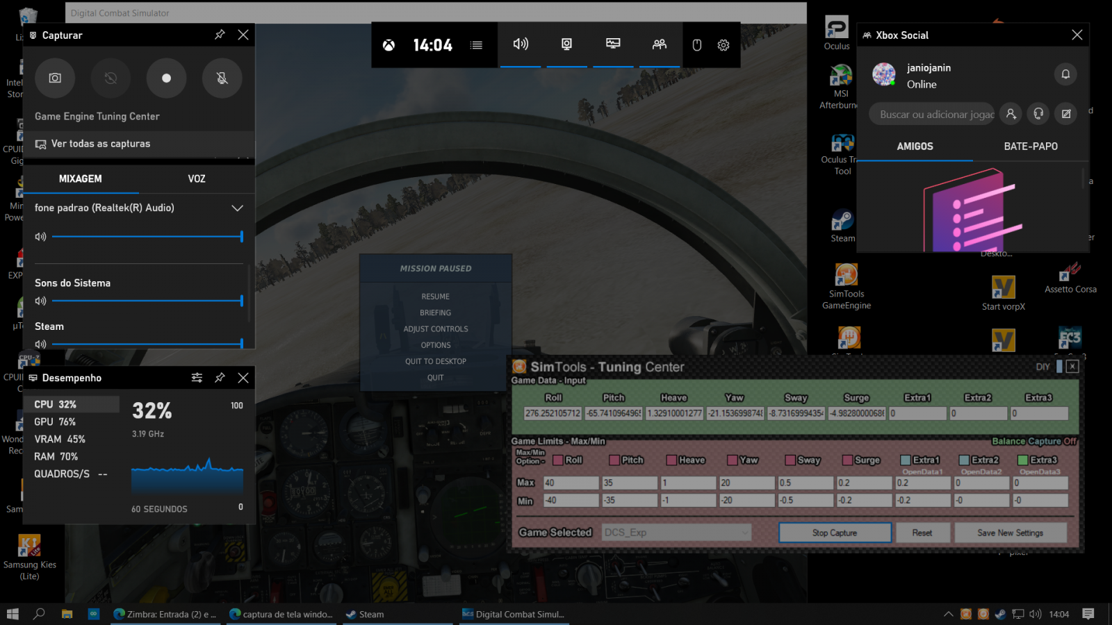

  1. janio
    janio janio from brazil
    Feb 28, 2020
    81
    state employee
    belo horizonte
    184Coins
    +35 / 0 / -0

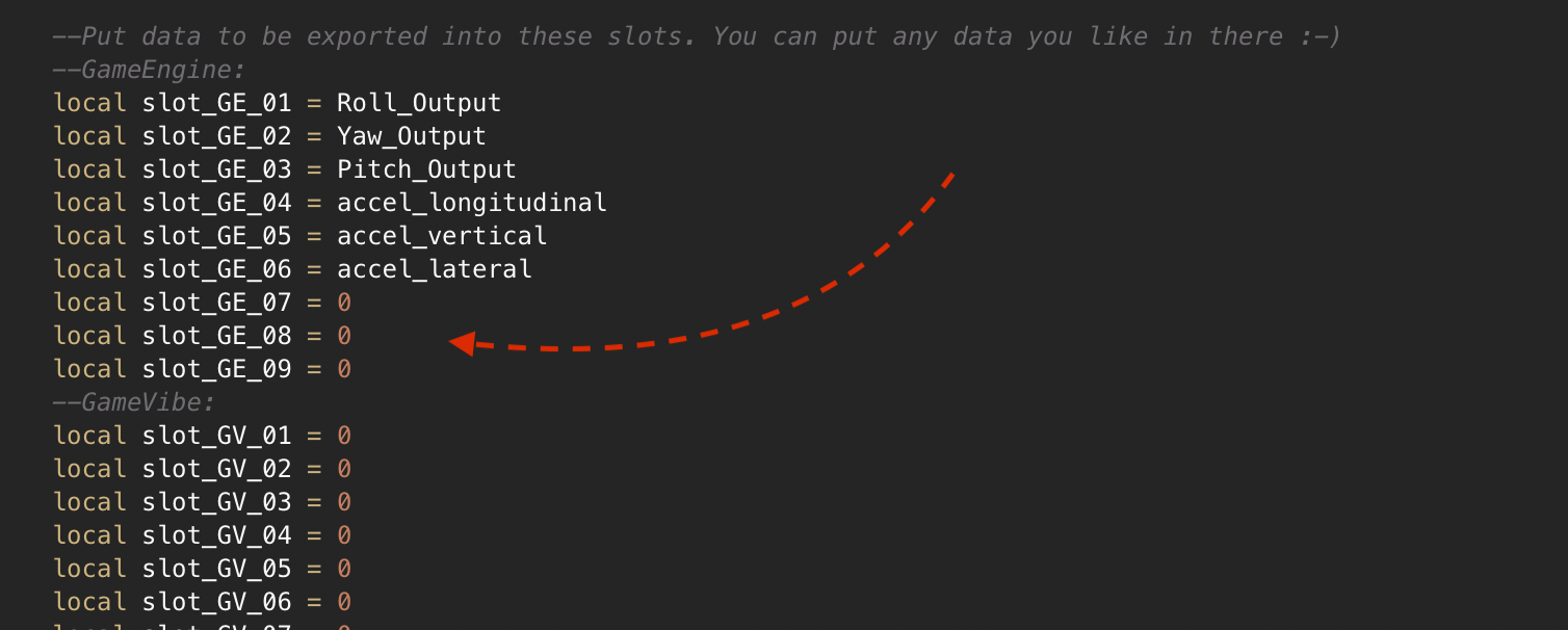

    By default Extra1,2,3 are unused and show only zeros.
    You can open the export script (in a proper code editor!) and assign values to those slots if you know a little Lua.

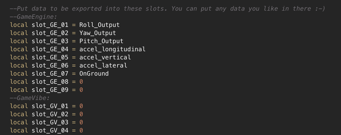

    hi dirty, what should i write in slot 07 to receive touchdown data on any of the landing gears?
    --GameEngine:
    local slot_GE_01 = Roll_Output
    local slot_GE_02 = Yaw_Output
    local slot_GE_03 = Pitch_Output
    local slot_GE_04 = accel_longitudinal
    local slot_GE_05 = accel_vertical
    local slot_GE_06 = accel_lateral
    local slot_GE_07 = 0
    local slot_GE_08 = 0
    local slot_GE_09 = 0
    grato.

    just try "OnGround"
    ...I can't test it right now, but it should give you a zero in flight and a 1 while on ground.

    hi dirty, I tested what you indicated and it was good for me, I configured to use only 15% of my pitch axis, and in the tuning center configuration I left 1 for maximum and 0 for minimum.
    thanks again.

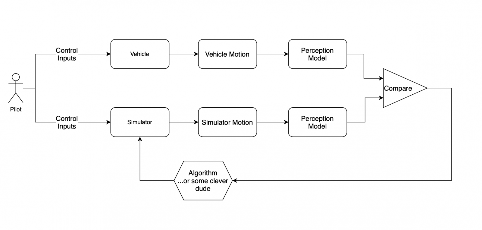

    I read this in a paper somewhere about a year ago. Unfortunately I don't have it anymore and it was in German anyways. So, I'm trying to convey the ideas with these diagrams:

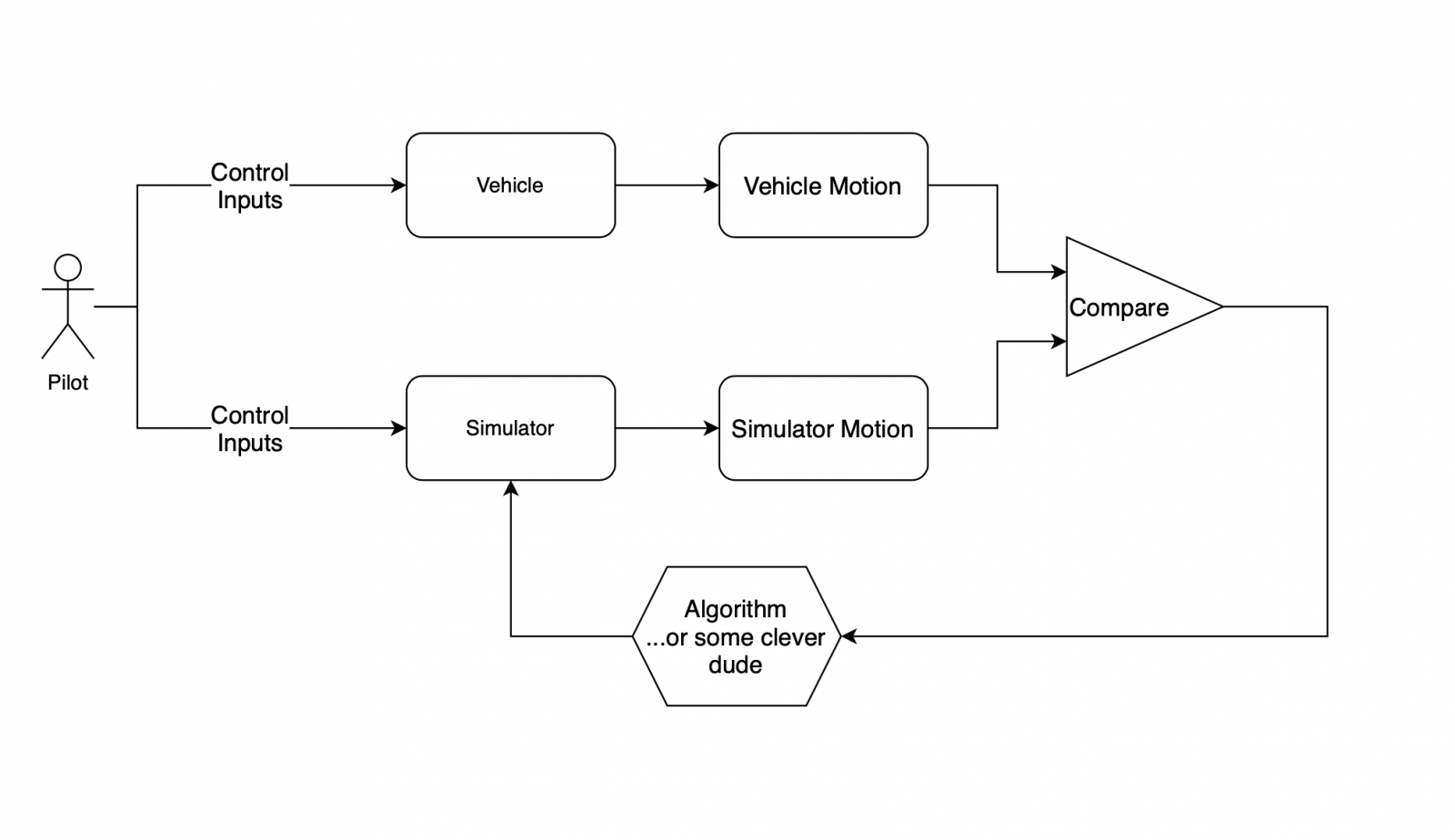

    Initially, the idea is to optimise the motion cueing algorithm by comparing accelerometer and gyro data from the rig with the same data from the vehicle and try to minimise the gap.
    In a nutshell: This model tries to please your iPhone (assuming it is strapped to the rig).

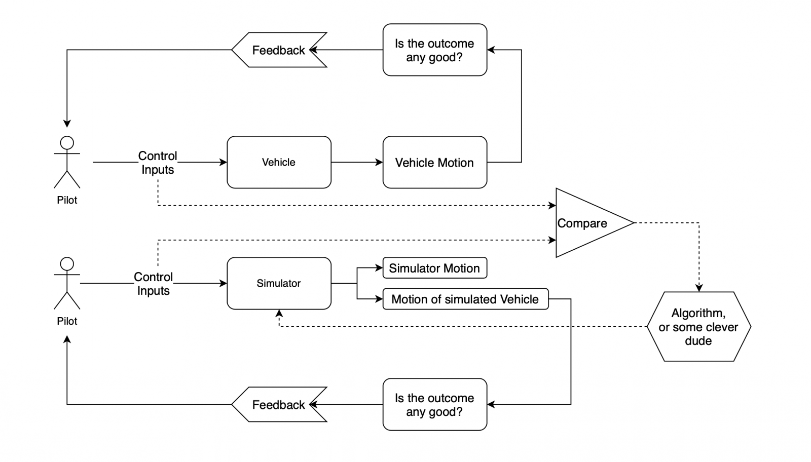

    Then they went one step further and separated the vehicle-feedback-cycle from the simulator-feedback-cycle into two distinct feedback loops.
    They no longer compared the motion of the platform with the motion from the vehicle. They did not even look at the motion of the platform. They provided the pilot with feedback on the outcome, so that in the end a test subject was "very well trained" to perform a task in the vehicle. Another was "very well trained" to perform the same task in the simulator.
    The only thing they really compared were the control inputs. The question was: "Does the feedback from the training in the simulator lead the pilot to adopt the same habit patterns as training in the vehicle would?
