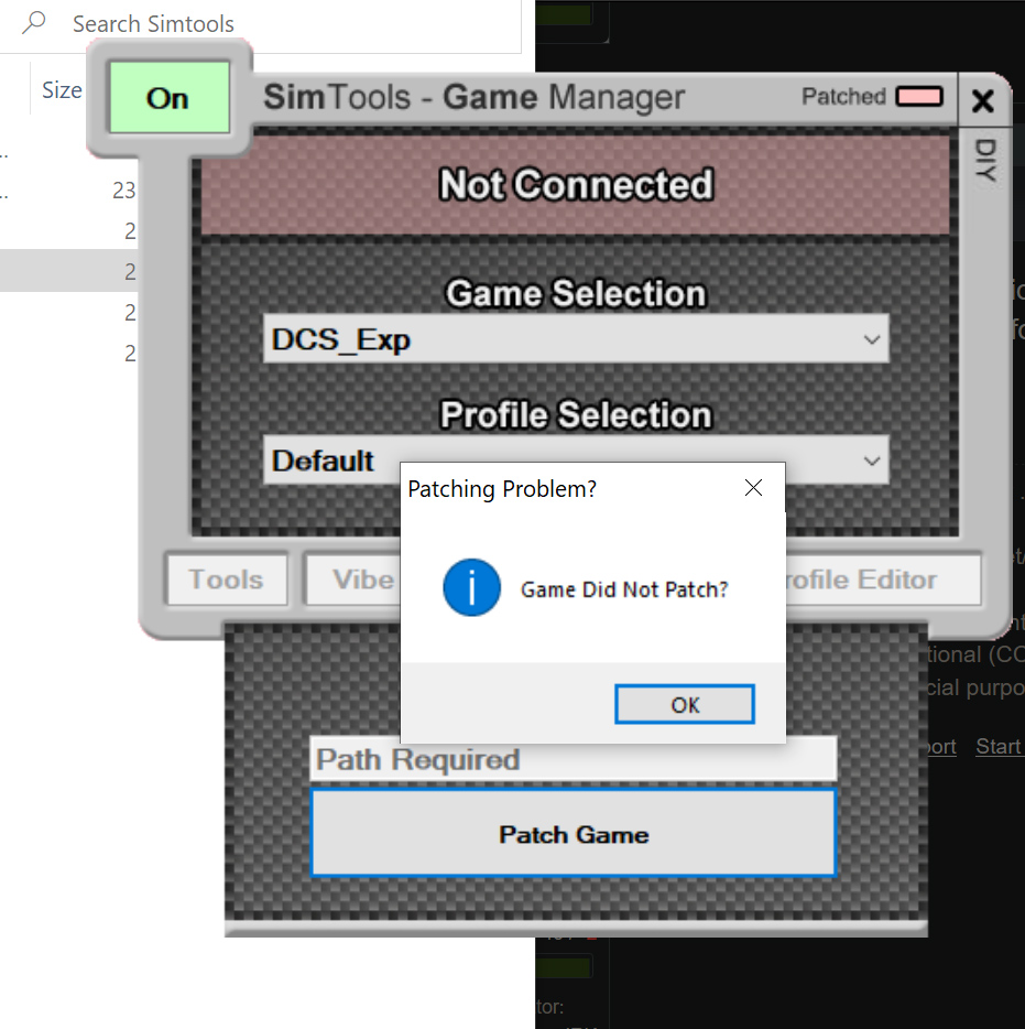

    New I cannot patch DCS. I select the right folder and it says Cannot Patch? I have selected the right folder because if I select any other folder it tells me that's the wrong place to patch it. I originally patched the DCS non experimental plugin just fine and I thought maybe that was the issue so I went and deleted all files out of the Scripts folder and that didn't help at all.

    You should remove a patch using Game Manager, though you can also do it manually, to do so remove the old path file by deleting the relevant game file in: c:\user\Your_User_Name\AppData\Local\SimTools\GameManager\GamePathSaves

    I had this same issue because I manually deleted the files, so you'll have to restore the deleted files to remove the patch automatically. However, if it won't then re-patch, just manually create the folders /Scripts and /Hooks. Mine would not patch until I created these folders, but as soon as they were done it all worked fine.

    Afaik, the "Game Did Not Patch?" message doesn't come from my plugin. At least not from the code I wrote directly :)
    You can have both plugins installed in SimTool. That's no problem, but you should only use one game patch at a time. So, unpatch DCS through the original plugin and then re-patch using my plugin.
    You can manually unpatch DCS by renaming "SavedGames/DCS/Scripts/Export.lua".
    You can manually remove plugins from SimTools by deleting their .dll file in "C:\Users\[UserName]\AppData\Local\SimTools\GamePlugins".
    You can PM me anytime and we will go through the usual suspects of possible errors step by step.

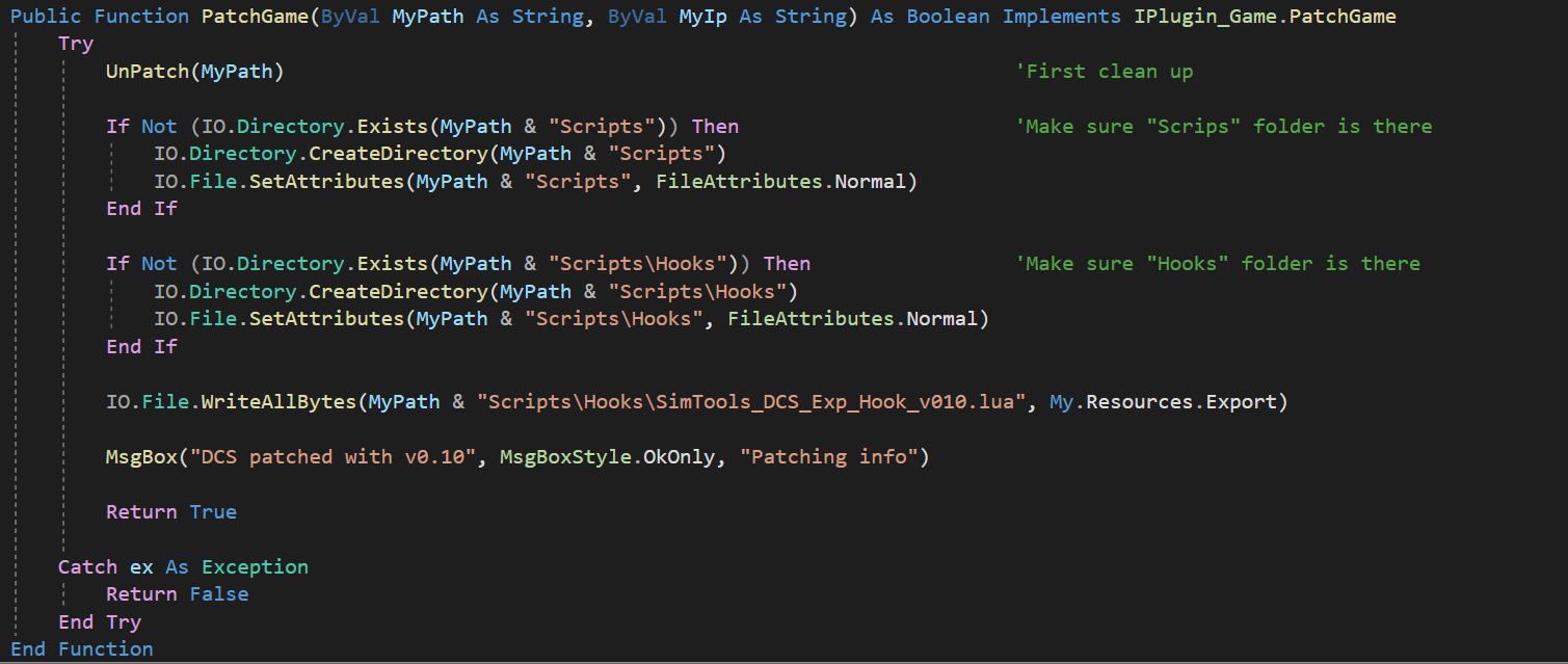

    I will take a look at the code, because I thought it would create that "Hooks" folder, if it wasn't already there. At least that was my intention. I think in the patching process you only have to specify the [username]/SavedGames/DCS folder. I will check...

    As far as I can tell, the "PatchGame" method should create the Scripts and Hooks folder for you: upload_2021-4-18_11-2-38.png
    "MyPath" is the path that you specify for patching, so most probably ".../[UserName]/SavedGames/DCS".
    Either this method is not working correrctly in all cases or there might be another reason why you had problems before. If you run into those problems again, let me know. Maybe I can reproduce it and get to fix a bug.
