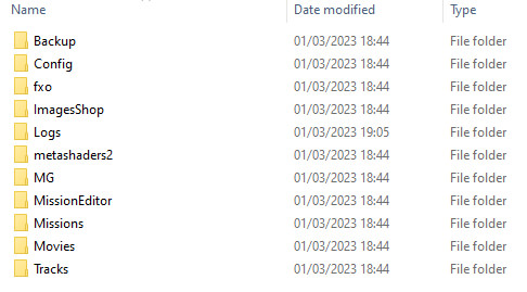

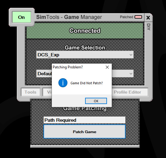

    Hi! As a YawVR1 owner I am eager to try out Simtools and this plugin. However when trying to patch the game, I always get a 'Game Did Not Patch?' error. I tried running as administrator but no dice. As a last resort I uninstalled DCS (beta) altogether and installed the regular DCS from scratch but I still get the same message. What am I missing here?

    During the patching process you have to point to your "SavedGames/DCS/" folder. Sometimes people point to the installation folder (C://Program files/...)instead by mistake.
    Can you post a screenshot of the error message? Also, what are the contents of "SavedGames/DCS(openbeta)/Scripts/Hooks/" after patching?

    Sure! I did select the saved games folder as per the instructions popup before path selection. Attached are the error message and the 'C:\Users\<username>\Saved Games\DCS' folder contents after (failed) patching. Also I ran and closed DCS before patching, set the windows value seperator to a dot and have .NET 6.0.301 (x64) installed.

    Hmmm,.... that message is not coming from the plugin itself, but from SimTools (I assume). I can't verify where exactly the patching process goes wrong, just that it does.
    But no worries, there's a simple workaround:
    All the patching routine really does is copy a little script to "C:\Users\<username>\Saved Games\DCS\Scripts\Hooks\'
    If you are using the openbeta branch, then the path is "C:\Users\<username>\Saved Games\DCS.openbeta\Scripts\Hooks\'
    I have attached a .zip fiile that contains a .lua script. Copy that script to the location described above. If the ..\Scripts\Hooks\" folder does not exist, just create it.
    You will have to restart DCS from the desktop for the changes to take effect.
    Let me know if that fixed it.

    Thanks for your support! I just got it to patch after creating the Scripts/Hooks folders myself so I guess that's where the script breaks.

    Looking at your script, perhaps a trailing slash is needed in the if statement?
    if Not (IO.Directory.Exists(MyPath & "Scripts")) Then
    if Not (IO.Directory.Exists(MyPath & "Scripts\")) Then
    You might not even need those if statements as according to the docs Directory.CreateDirectory "Creates all directories and subdirectories in the specified path unless they already exist."
    Anyways, just a wild guess. Thanks for this plugin!

    That's odd, because the scrip should create those folders. It shouldn't crash just because they're not there :-/ At least that was my intention :) I would love to be able to recreate this. Do you have anything else called "Scripts" in that SavedGames/DCS folder?

    My guess is that without the trailing slash, the path is evaluated as a file (without an extension) causing the Directory methods to throw an exception and breaking out of your try block. I would log any errors in your catch to confirm this.
    Edit: on a second thought, if that was the case it should be crashing for everyone so I guess I' m wrong there
    Edit 2: maybe it has something to do with write privileges? On the DCS folder itself to create the directories
