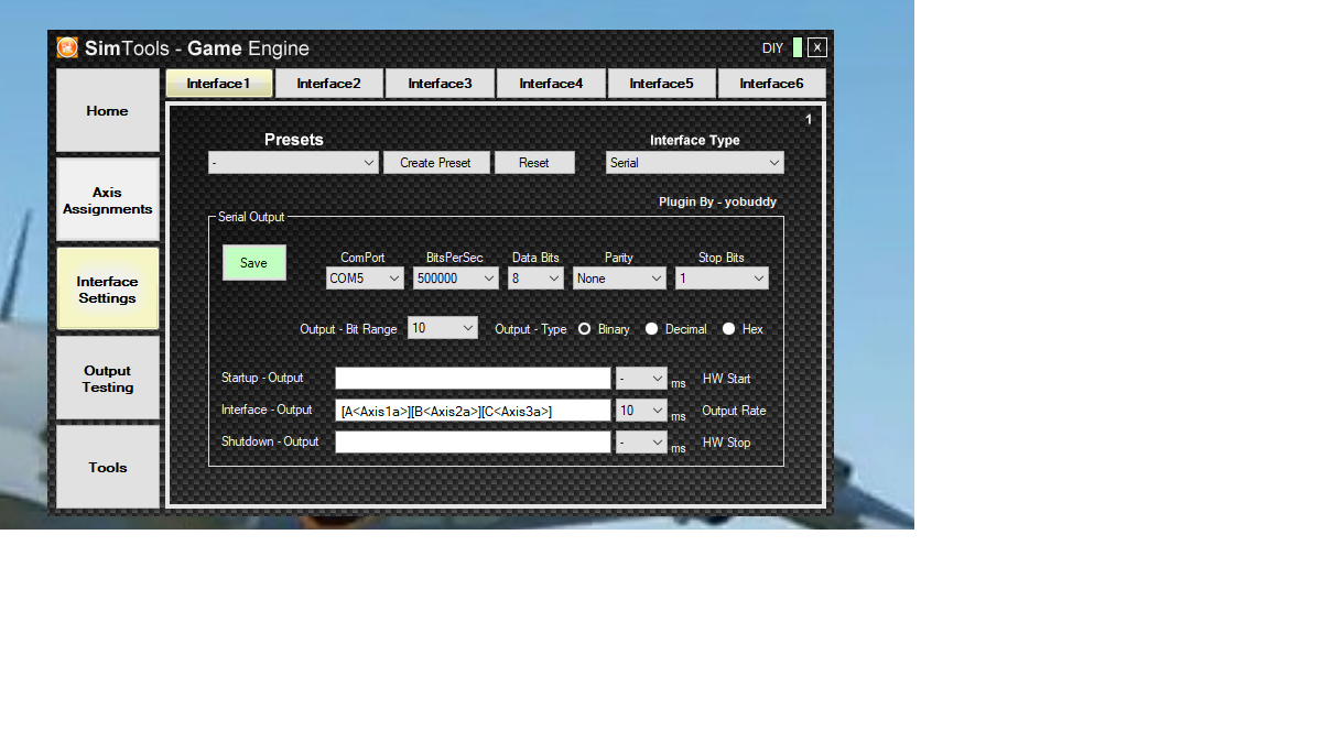

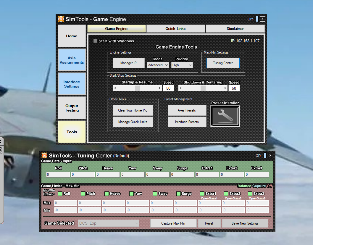

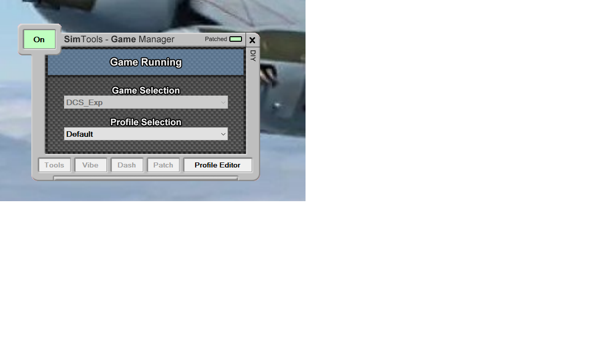

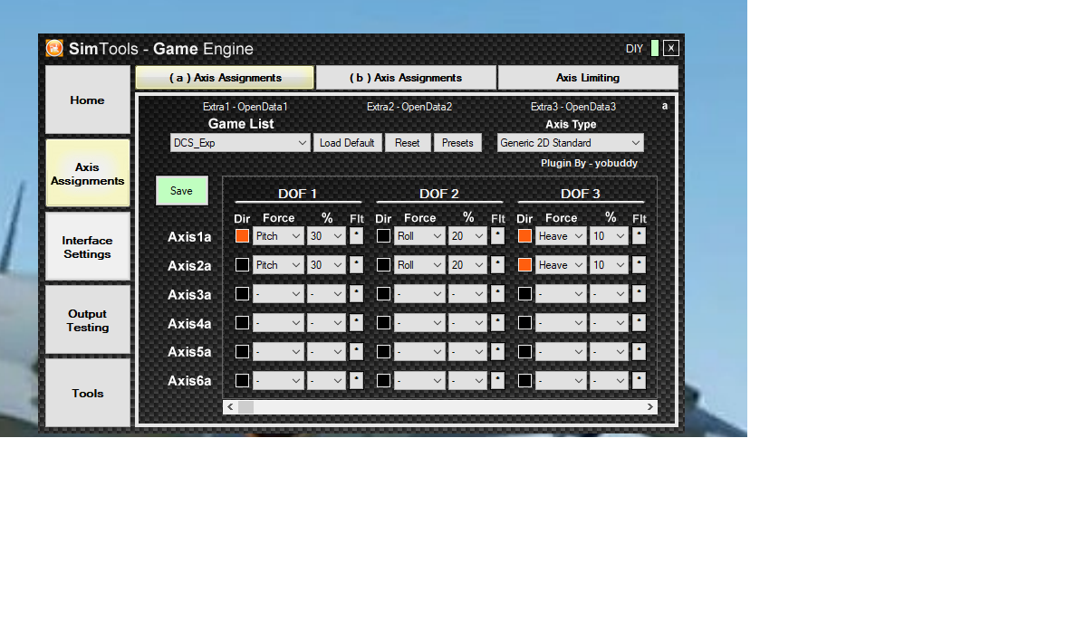

    Is there anything else I can add beyond this thanks
    22,230
    154,849Coins
    +11,228 / 57 / -2
    There are no Max/Min values assigned in the Tuning Center, but can I check was there an aircraft in flight when the picture was taken, or was DCS paused:

    It makes no difference if the plane is flying or paused the tuning center does not change . I have tried pushing Capture Max min but nothing changes. Thanks

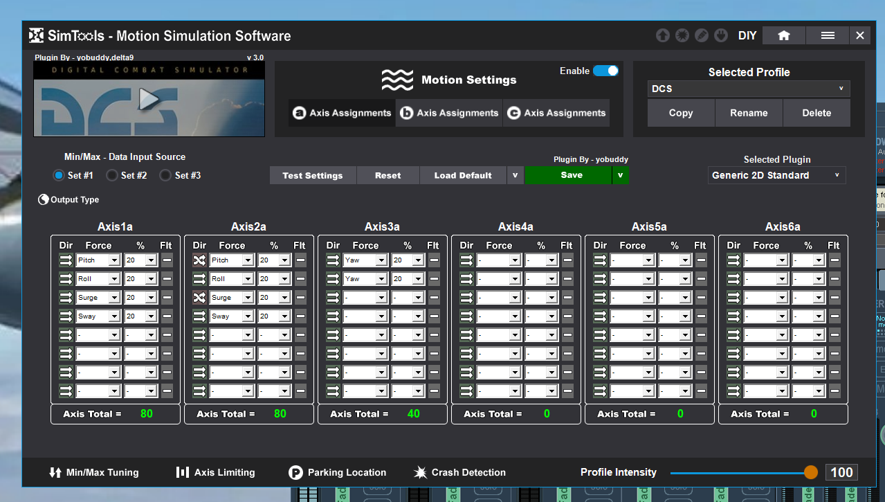

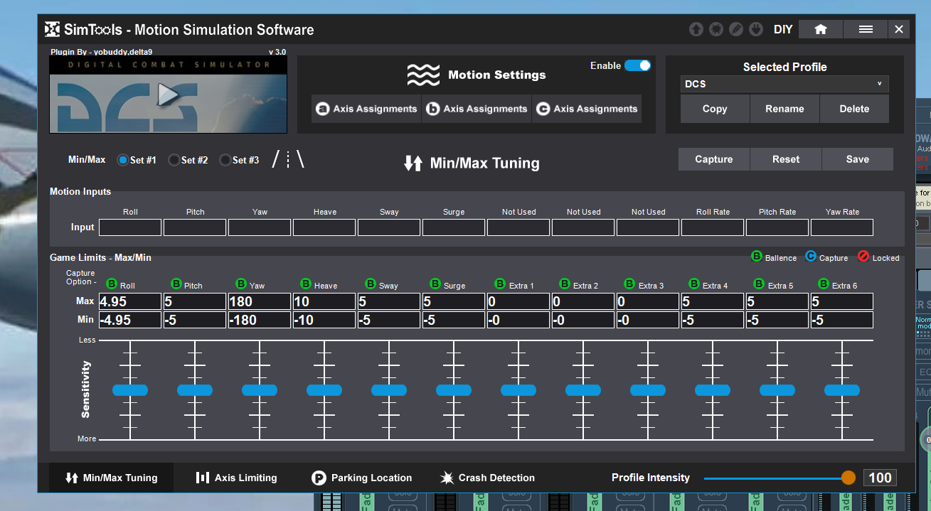

    I have installed V3 and all the games are fine but DCS has no input data and no movement. Testing works fine in Axis assignments. Also in V2 I had yaw assigned to extra1 .This is not available in axis assignments in V3 but does show in max min tuning. What should I use. Thanks Denis
