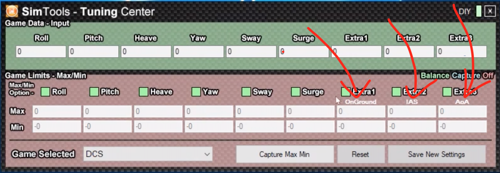

      You should see "OnGround", "IAS", and "AoA" under the three extra slots. If you see those, then that's a very good sign all went smooth :)

    I followed all your steps and can confirm the Onground, IAS and AoA is in the tuning center. My Roll is close to zero as you described, as well I copied Export.lua to the correct scripts folder.
    However still no motion... I am using Xplane 11 perfectly, so something is up - I am assuming on my setup end...
    I should mention I am using DCS through Steam....

    Well the key word in your last sentence was "valid max/min values" - so I went digging and i found this:
    https://www.xsimulator.net/tuning-centre/
    As of right now I have the pitch axis working on Extra 3 in the plugin for the 4 actuators, working on roll, heave, sway, surge. I don't have traction loss so I can't use yaw... I am doing this on 4 of the homebuilt sfx-100 actuators. Hopefully by end of today I will have it all figured out.

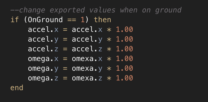

    Hey :)
    The three Extra slots (OnGround, IAS and AoA) are not actually supposed to be used for anything. I just included them to show that you can export really anything in these three slots. Be creative! Or ignore them :)
    Inside the Export.lua file you can set different gains for when the aircraft is on ground, but if you don't it will work just as well. Just leave the values at 1.00.

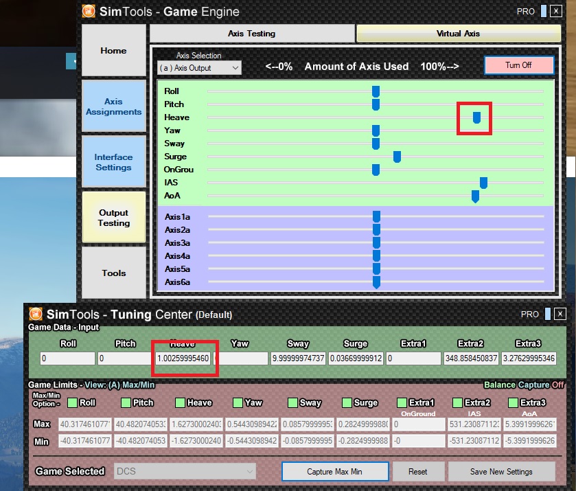

  10. SeatTime
    2,572
    +2,854 / 40 / -0
    Hi, any reason for the heave gravity offset?

  11. hexpod
    hexpod http://heXpod.xyz
    Apr 18, 2016
    1,228
    berlin
    7,900Coins
    +381 / 5 / -0
    DC motor, 6DOF

  17. hexpod
    Apr 18, 2016
    1,228
    berlin
    7,900Coins
    +381 / 5 / -0
    DC motor, 6DOF
    Yes, it’s recommended to use the values above 1 in Tuning center. Try to set it at -+2 and apply simtools washout.
    This should work. The question is: do you really need the sensitivity close or below 1 ?
  18. hexpod
    Apr 18, 2016
    1,228
    berlin
    7,900Coins
    +381 / 5 / -0
    DC motor, 6DOF
    @SeatTime ,
    I mean whatever you do inside the plugin, between normal and inverted flight we have 2G difference which seems perfectly logical.
    Scenario 1 (starting with heave at 0)
    Now, if you output in the plugin the vertical G with a “center value 0G”, (your platform will start cantered) and you will get -2G while inverted.
    Imagine, in this case, if you scale your platform intensity -+ 1 you will get the motion scaled up to 1G in normal conditions. Than if you will do an inverted flight, your cue will clip and you’ll not get any heave motion. Everything below -1 will be skipped and will provide heave clipping cuts while going above -1.
    Scenario 2 (starting with heave +1)
    In this case you might want to scale your heave +- 2 and apply a High Pass filter (washout)
    The washout will bring the heave to the center and you will have 1G travel up and 1G travel down. (I mean 1G room for normal flight and 1G room for inverted flight before Tuning Center will clip)
    In this scenario you will still receive heave cues in inverted flight.
    What do you prefer: scenario 1 or 2 ?
