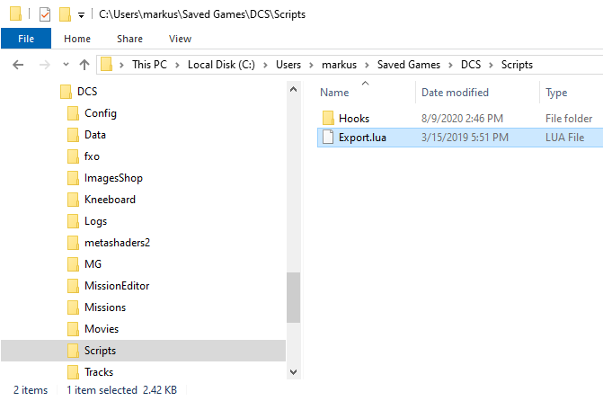

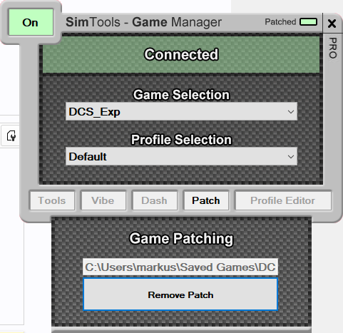

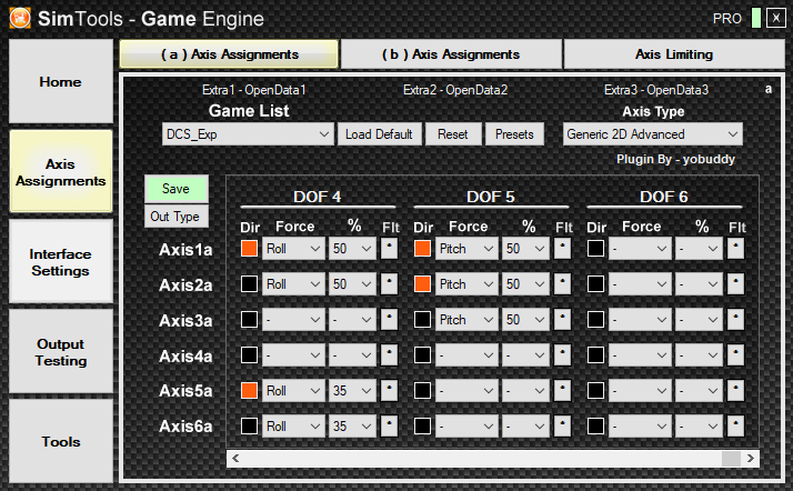

    Hi All,
    I don't manage to get the DCS Experimental Plugin v0.08 running.
    According to the message below, the patch has been installed correctly:
    Now the PlugIn shows up correctly in Game Manager:
    I have set up a motion profile in Game Engine:

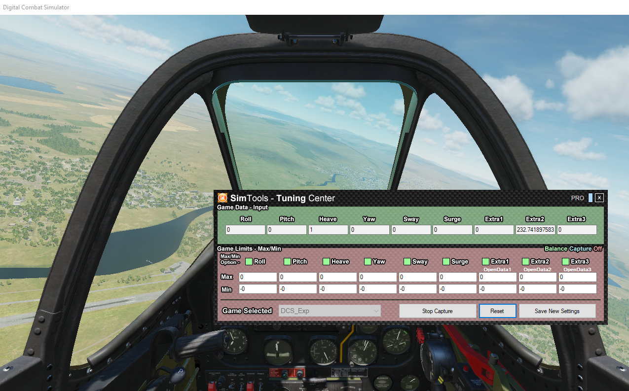

    When starting DCS via Steam, Game Engine seems to regognize the game, because the buttons "Axis Asignment" and "Interface Settings" turn blue as expected:
    The Tuning Center shows the DCS-specific Extra1-3 labels "OpenData1", "OpenData2", and "OpenData3".
    But: When flying, all Tuning Center values remain zero and I don't get any motion.
    The "non-experimental" DCS PlugIn works correctly, and so do the P3D and NL2 PlugIns. Also output testing in Game Engine works without any problems.
    I also uninstalled the other DCS PlugIn, but this did not solve the issue.
    Any ideas what I am doing wrong?
    Best regards,
    Markus

    @Dirty, thanks a lot for your immediate help! Now that I get motion values into the Tuning Center, my rig is moving with your plugin. Fantastic! Within the next days I hope to find some time for tuning my configuration and for remembering how to fly this TF-51.
    @All: My problem was caused by an old "Export.lua" file that belonged to the original DCS plugin:
    After renaming this file, everything works perfectly.
