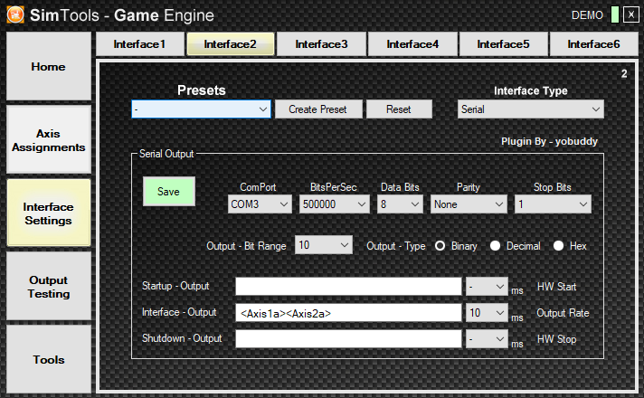

    Make sure a Default Axis Allocation is configured, as that is what Output Testing uses.
    If that is not the issue try temporarily turning off any anti-virus and firewall, then try Output testing again.
    When you get Output testing sorted make sure you run a race in LFS using first person mode before patching it for motion, as that generates some required files.
    Also be aware that total Axis Assignment percentage total should be around 100%, you can go a little over but as you have it now for LFS will likely result in clipping: https://www.xsimulator.net/community/faq/axis-assignment-percentage-totals.120/
  2. Ekain Lopez
    Ekain Lopez New Member Gold Contributor
    May 17, 2019
    29
    Basque Country, Spain
    - 11Coins
    What do you mean with a Default Axis Allocation?
    Where cana I configure it? The Arduino code has to be changed? (Now I am using the SMC3 code.
    Thanks in advance
    21,191
    148,826Coins
    +10,920 / 54 / -2
    In Game Engine -> Axis Assignments -> Game List drop down at the to is the Default allocations.
    No you don't need to change the Arduino SMC3 code if everything there works as expected.
  4. Ekain Lopez
    May 17, 2019
    29
    - 11Coins
    Thanks so much, now it works well. The following days I will try to configure everything, and then I'll start building a base for the electronics. :thumbs

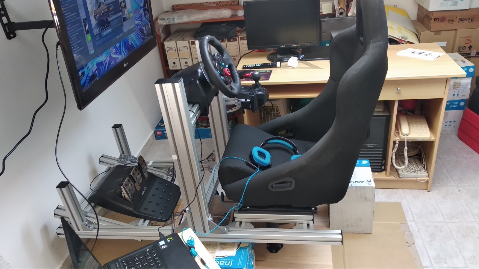

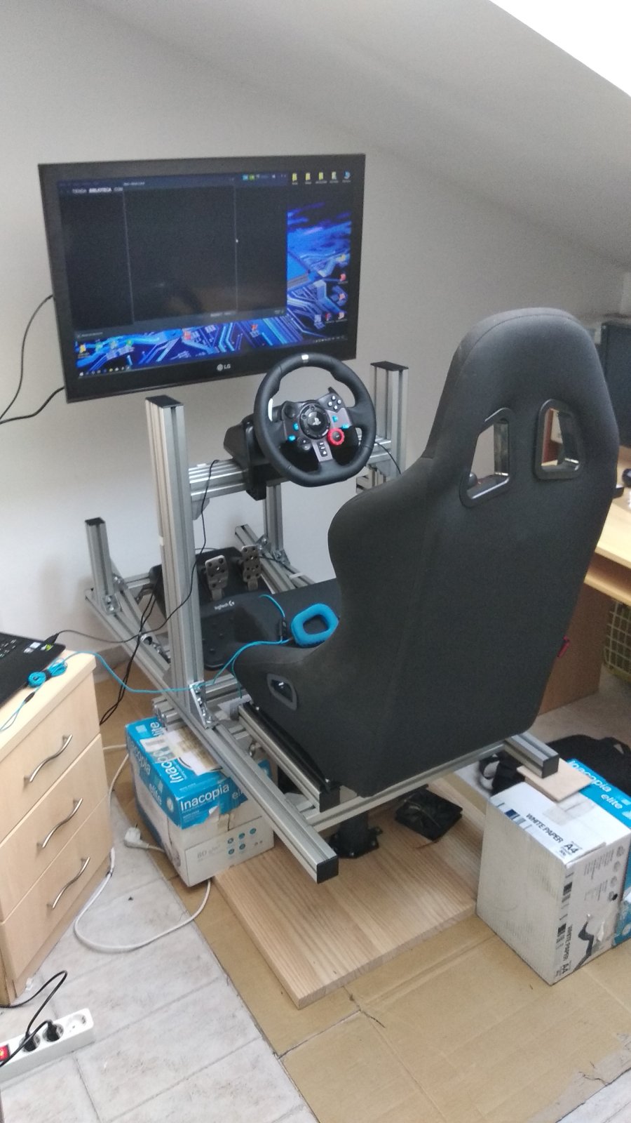

  16. noorbeast
    21,191
    148,826Coins
    +10,920 / 54 / -2
    Do you have some updates and photos of the frame and associated construction phase?

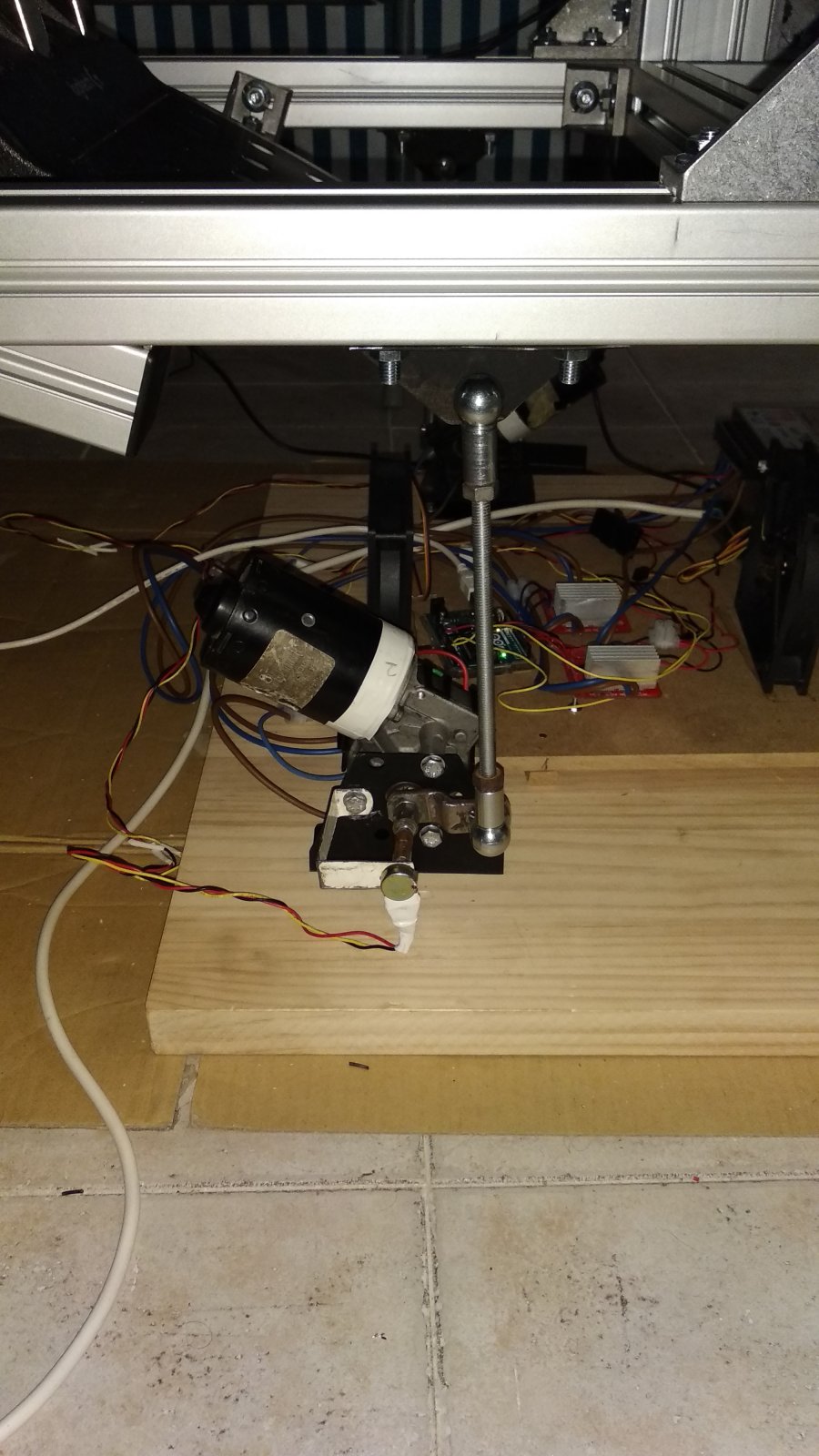

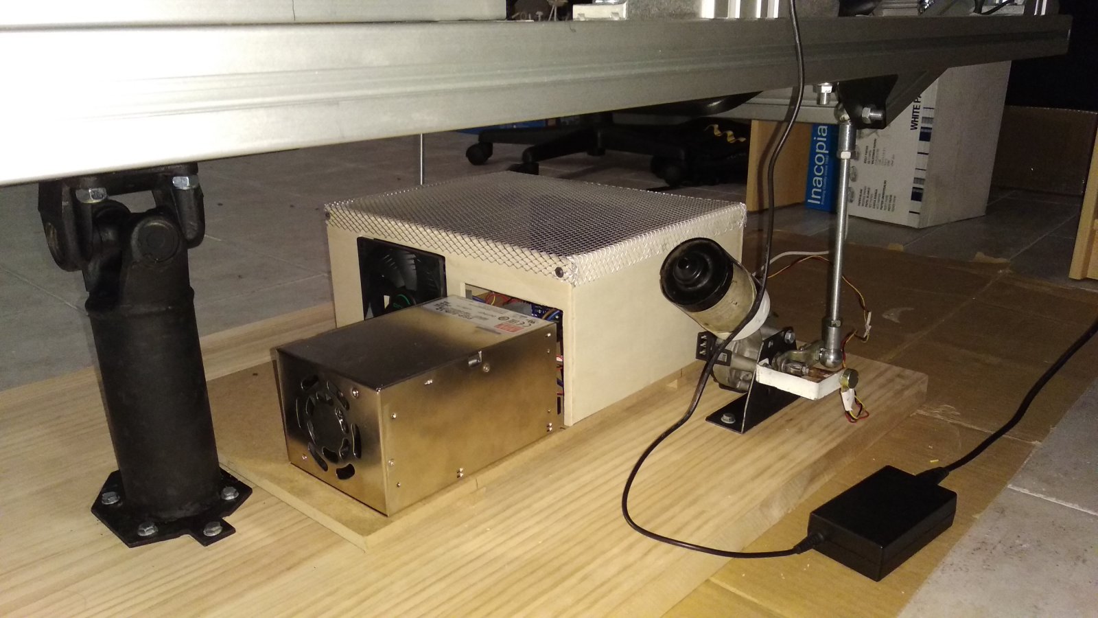

  17. Ekain Lopez
    May 17, 2019
    29
    - 11Coins
    Yes!!
  18. noorbeast
    21,191
    148,826Coins
    +10,920 / 54 / -2
    Where are the motors going to mount?
  19. Ekain Lopez
    May 17, 2019
    29
    - 11Coins
    The motors are in front of the universal joint, under the frame. Those photos are a bit old, 2-3 months, I was adjusting the motors (thats why there are two boxes holding the frame) but now the motors are mounted, and the motion works fine.
