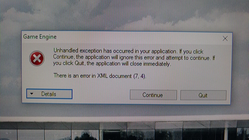

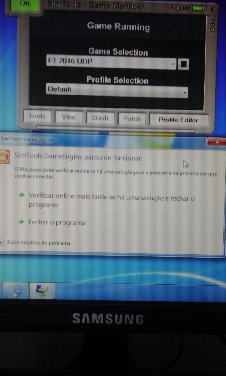

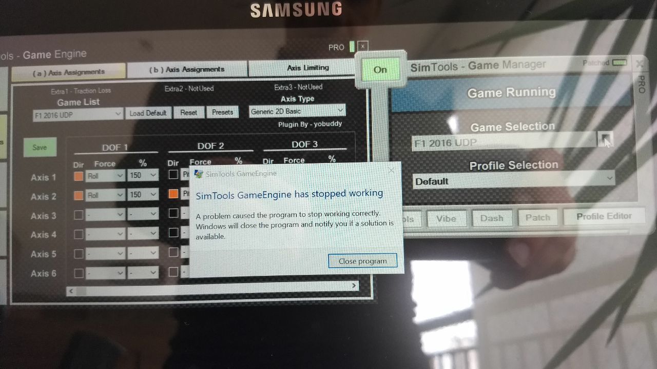

    Now on my PC too. UDF F1-2016 error.
    An image of each PC

  4. Leandro Kemp
    Leandro Kemp Active Member Gold Contributor
    Oct 14, 2015
    161
    Brasil
    - 10Coins
    +34 / 0 / -0
    Silves.
    I downloaded the plugin again.
    It was some error during the first download.
    Thank you.

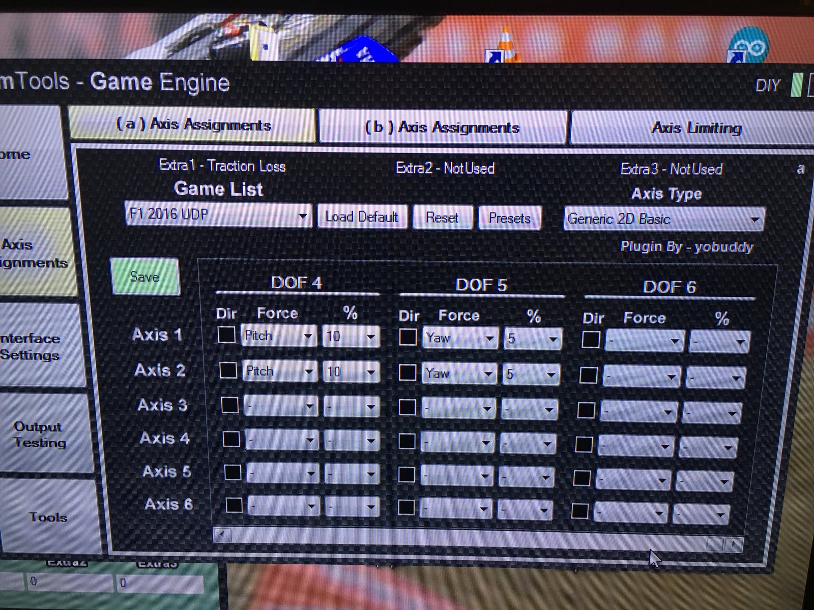

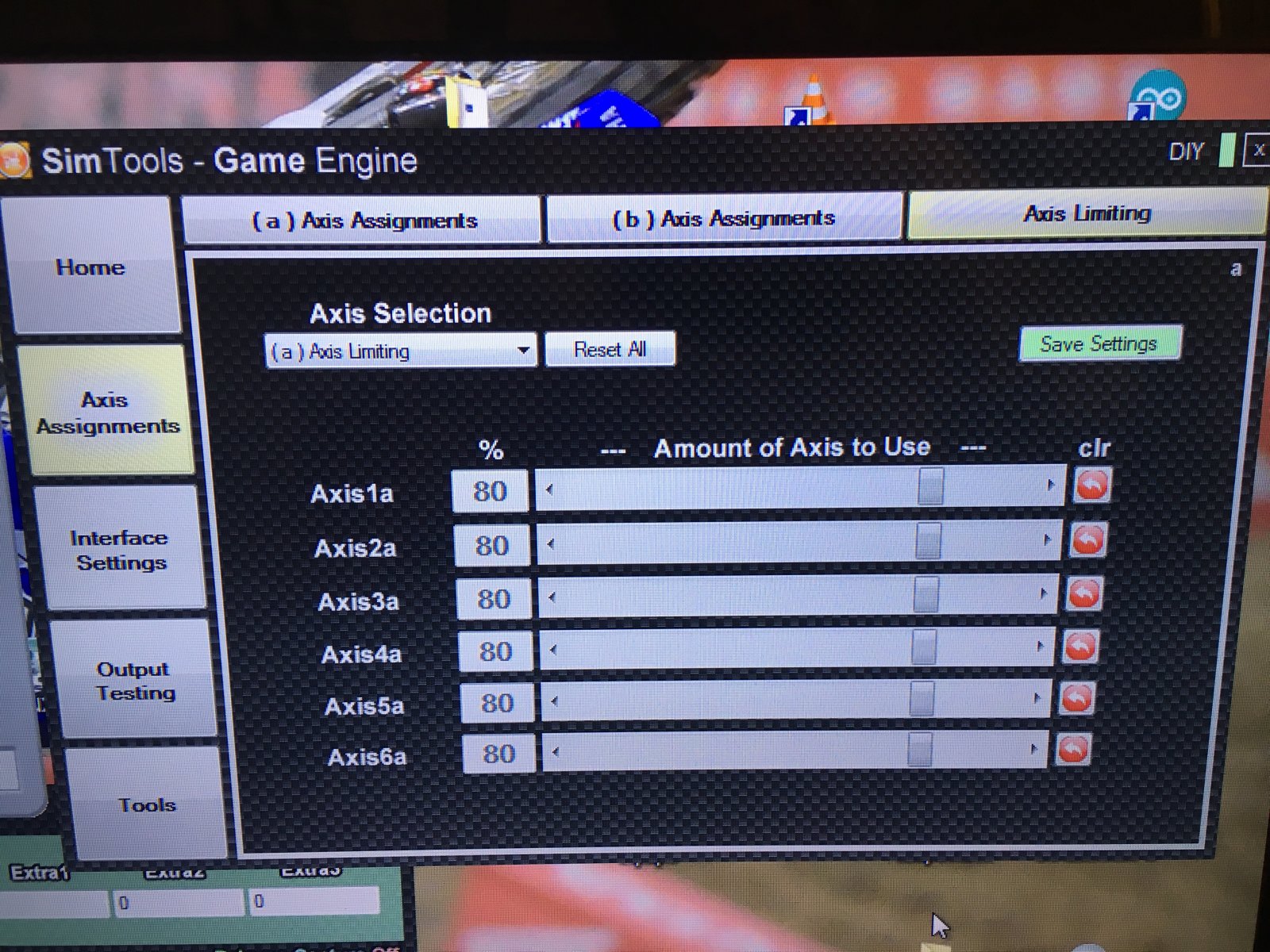

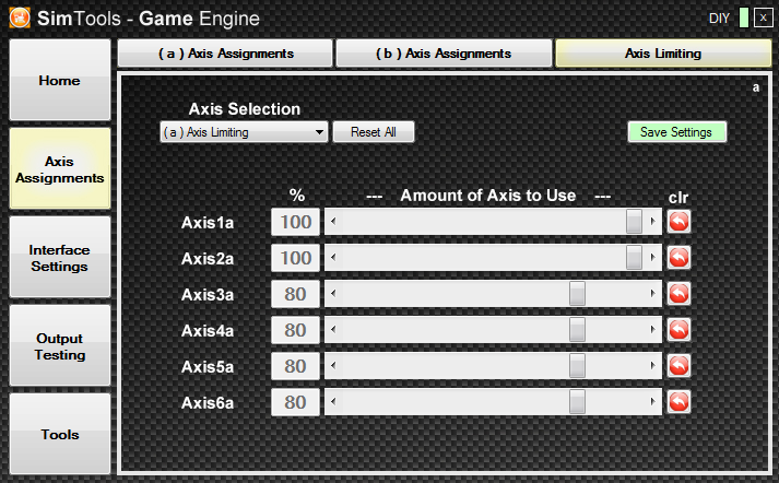

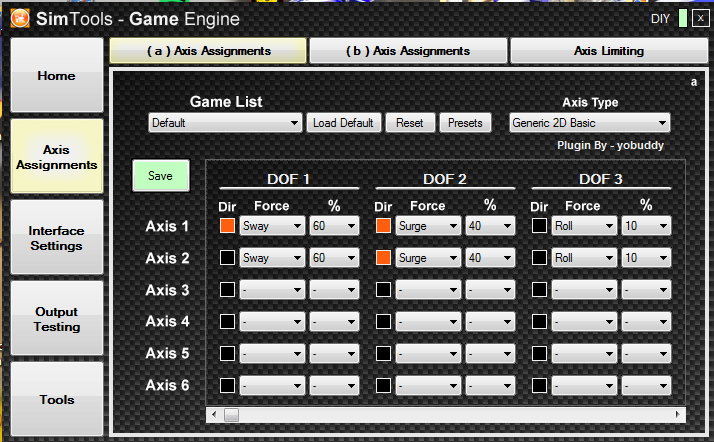

    @vthinsel , Today I tried everything again, and I only have problems with Sway, help .. I attached my configuration (this was the last of several ...)
    thanks , I need G force... :(

    You say you have a problem with sway but don't say or show what that problem is, does it move in the wrong direction or something else?
    Your settings do look a bit odd.
    Normally the Dir settings for roll would be the opposite to sway. Yaw should not be needed at all on a 2DOF rig.
    Here are the steps to creating and refining a motion profile: https://www.xsimulator.net/community/faq/steps-to-create-a-motion-profile.228/

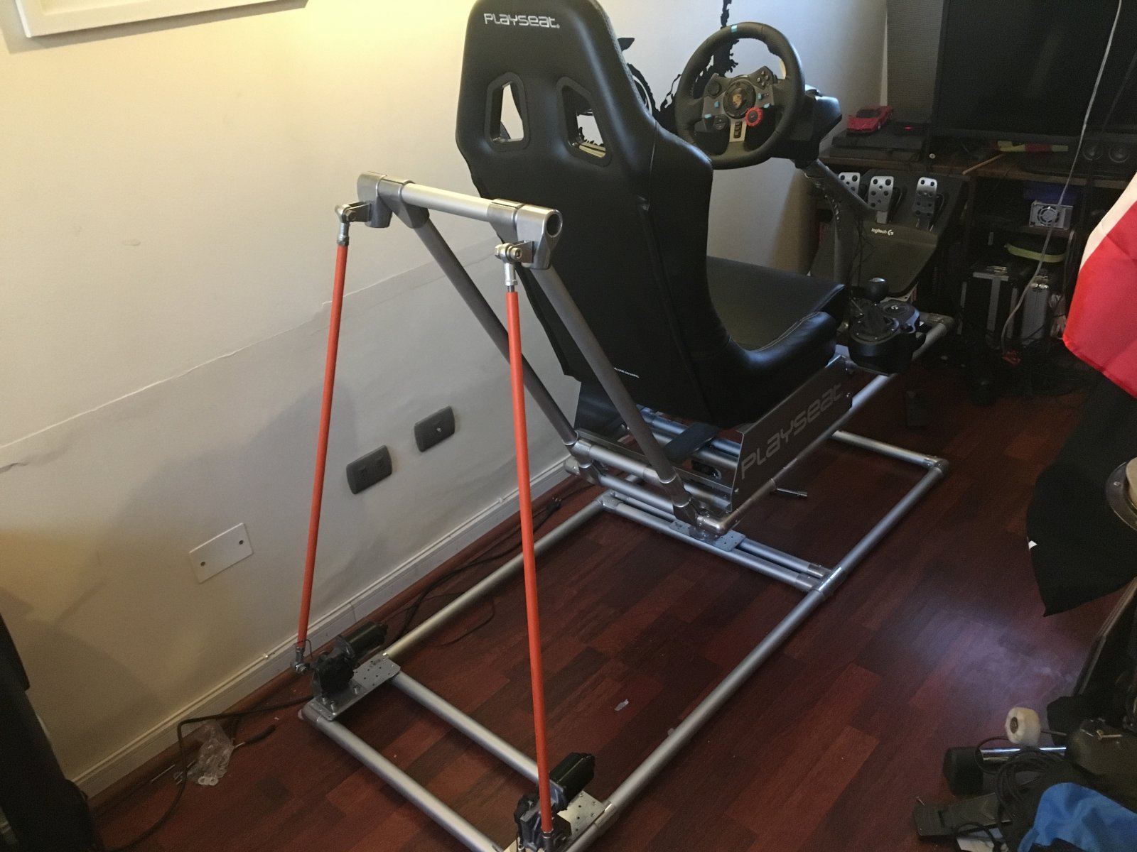

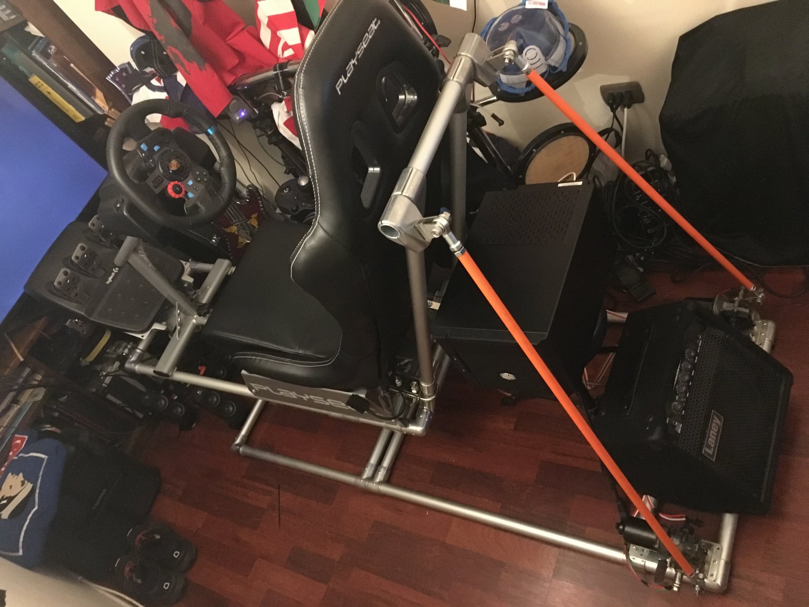

    @santanadany, can we see a pic of your simulator buddy?
  11. santanadany
    santanadany Member
    Aug 30, 2017
    60
    Chile
    605Coins
    +19 / 0 / -0
    @noorbeast ,
    I have all the other movements in my simulator, but no sway, and I only have problems with f12016 UDP, with projectcars UDP everything works perfect, I put all the others motion in off and I just leave sway and I don´t have movements in my simulator.
    Only don´t have sway...
    I already did 4 times: https://www.xsimulator.net/community/faq/steps-to-create-a-motion-profile.228/
    @yobuddy this is my simulator : https://www.xsimulator.net/communit...2dof-for-playstation-4-from-chile-2017.10844/
    attachment picture.
    best regards.

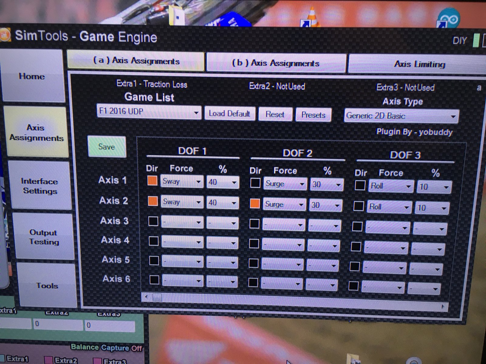

    Do you have sway in Output Testing?
    If so can you post a picture of your f1 2016 Axis Assignments, as the earlier one is the default.

    Dear @noorbeast , f1 2016 Axis Assignments is the same to default.

    Unfortunately there is too much camera movement on the video for it to be of any use, it needs to be stationary where we can see the movement of the rig and the game screen at the same time.
    As an aside it did seem like the seat itself could flex a fair bit from the frame, which if so means you loose a lot of the fine motion detail.
    You really don't need Yaw allocations in your settings.
