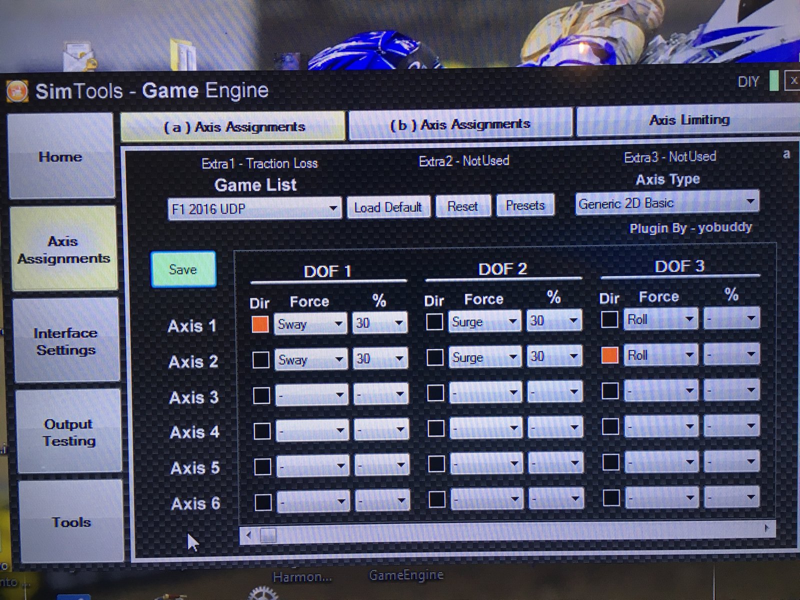

    Dear @noorbeast I turn off all other forces axis, only sway is on, and the movement I get is the same as that of the Surge! (o_O:think) I think the plugin needs to be reviewed.

    You can change the direction by checking or unchecking the Dir boxes orange, so your sim moves in the correct direction @santanadany.

    @noorbeast that I know, what I mean is that when braking and accelerating .... not when turning the steering wheel, Surge = Sway , You understand me?

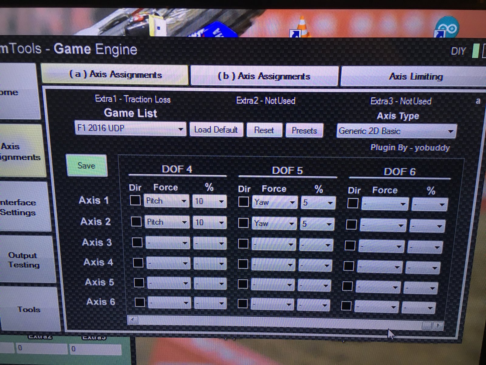

    22,172
    154,648Coins
    +11,191 / 57 / -2
    I have said from the onset that your settings seem odd: https://www.xsimulator.net/community/threads/f1-2016-udp-plugin.10070/page-2#post-142057
    And in the last posted picture they still were:
    Can I suggest that you post to your project page, instead of here, and first fix your axis and Dir settings so that they conform to what SimTools expects: https://www.xsimulator.net/community/faq/which-way-to-set-simtool-axis-movements.230/
    Then post pictures of all of your settings and a video that shows the sim movement and game screen at the same time, doing a lap.
    That will make it much easier to assist with troubleshooting.

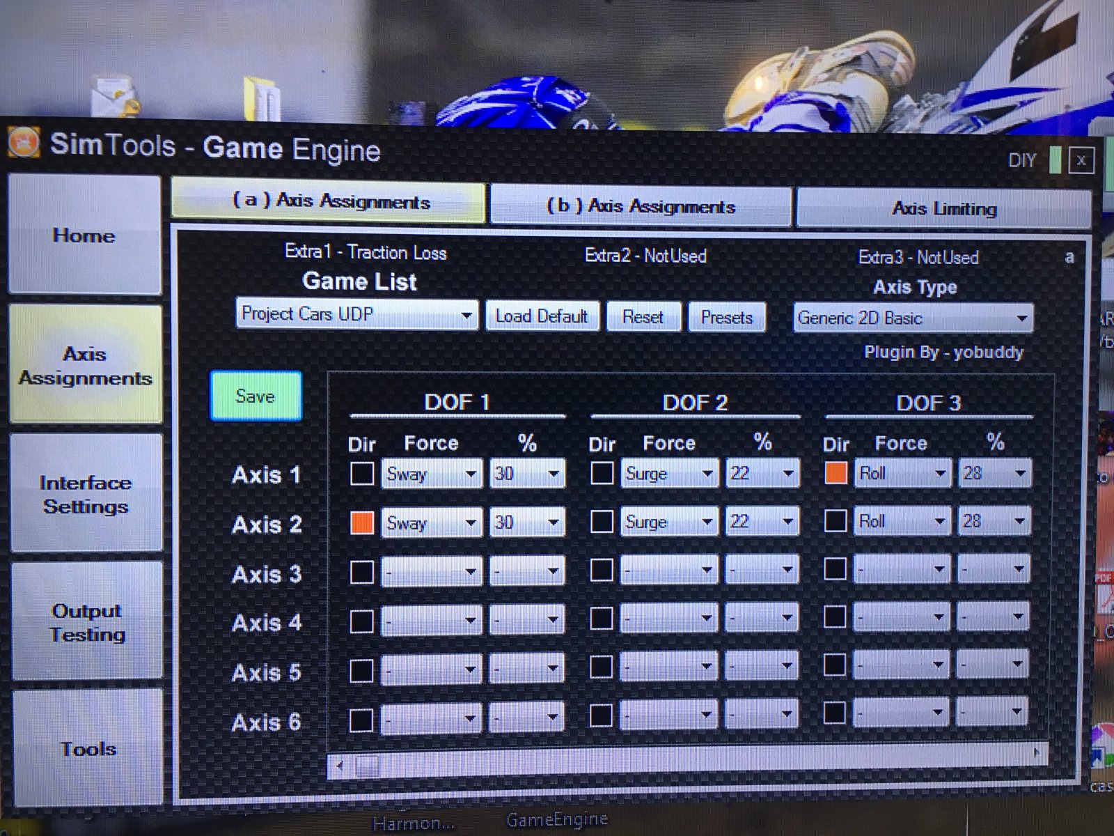

    OK, I have 3 things to show :
    Pcars 2 UDP , 100% working well :
    https://photos.app.goo.gl/rWFsVLEvzsQz4zZM2
    (Question : why does everything work right here? )
    F1 2017 UDP all axis on , don't work correct :
    https://photos.app.goo.gl/bzBOYY4nYfvCUlIo2
    (no Sway correct)
    F1 2017 UDP Only Sway is on, turn off all other force :
    https://photos.app.goo.gl/RaCbZuxDsvGZUZCC2
    (when the brake or throttle is actuated, not when turning , there is no force G to the turn)
    best regards

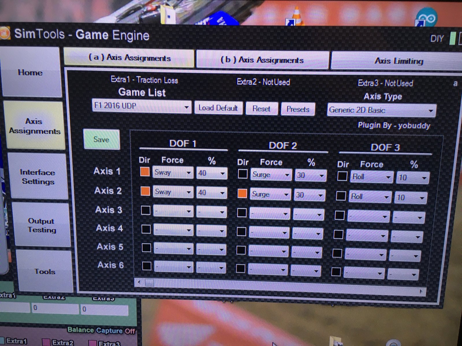

    22,172
    154,648Coins
    +11,191 / 57 / -2
    You may think Pcars is 100% working but on a 2DOF your Dir setting cannot possibly be correct, as roll is the opposite of sway but in your settings roll is the same Dir as surge.
    I can only keep repeating myself, you need to fix your Dir settings: https://www.xsimulator.net/community/faq/which-way-to-set-simtool-axis-movements.230/
  8. santanadany
    santanadany Member
    Aug 30, 2017
    60
    Chile
    605Coins
    +19 / 0 / -0
    ok, I can change, roll
    but and the video F1 2017 UDP only with Sway?
  9. santanadany
    santanadany Member
    Aug 30, 2017
    60
    Chile
    605Coins
    +19 / 0 / -0
    ok, I changed it, the PCArs works even better, and the F2017, when I brake now I'm going to the side ... Sway continues to drive when I brake or accelerate.no when I turn :(

    22,172
    154,648Coins
    +11,191 / 57 / -2
    I can see there is sway data in the Tuning Center, so it is a question of settings. But unfortunately until the Dir settings are correct it is not really possible to make firm recommendations, as SimTools mixes allocations on the fly and the incorrect Dir setting will have a significant impact.

    But now Dir settings are correct, and sway working with he acceleration of the car in longitudinal direction [g] , No with acceleration of the car in lateral direction [g], is it possible that the plugin has an error?

    The plugin is described as potentially buggy, see the early thread history, and also note @yobuddy's advice re clipping.
    If your Dir settings are now correct then a temporary fix is to set the Dir for sway so it behaves correctly and notify @vthinsel so he can check the plugin itself.

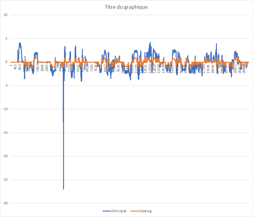

  14. vthinsel
    vthinsel Well-Known Member
    Feb 20, 2015
    439
    FRANCE
    6,057Coins
    +570 / 2 / -0
    Arduino, 4DOF

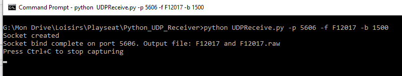

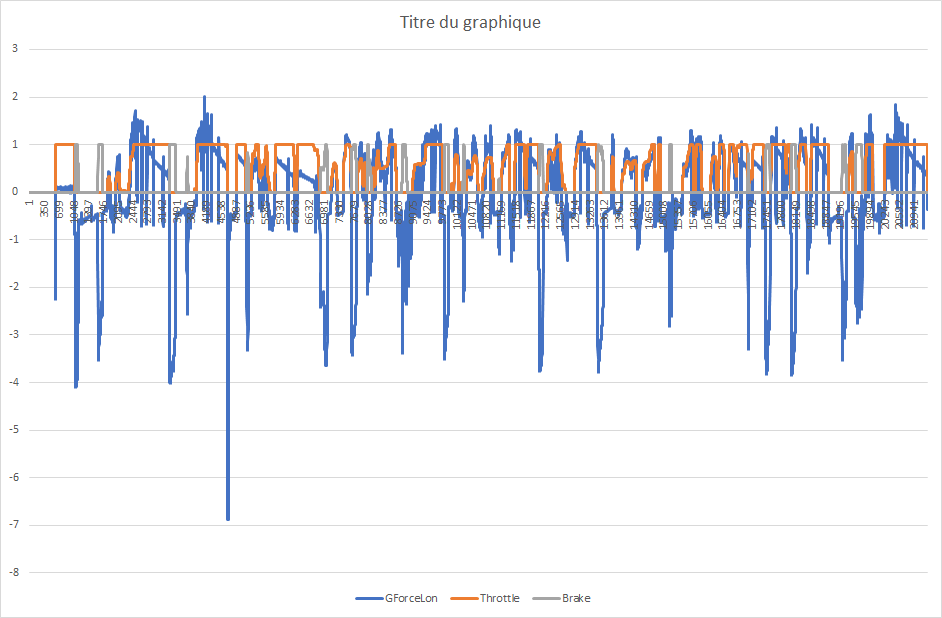

    I have checked the plugin, and sway is extracted directly from the UDP playload with no additional calculation.
    Specs here: http://forums.codemasters.com/discussion/46726/d-box-and-udp-telemetry-information/p1
    I have attached to this mail a small zip/exe file which you can start and that will write to a CSV file interesting values.
    This app listens on UDP port 20777. I also included a SPA run with a couple of graphics. (should work with all codemasters game)
    It looks to work : gforcelat is correlated to steering, and gforcelon is correlated to accelerate/brake
    Let me know your thoughts on the values.
    I noticed a nice thread for F1 2017 http://forums.codemasters.com/discussion/53139/f1-2017-d-box-and-udp-output-specification which provides direct values, but as I do not have the game I cant do much right now for F1 2017.

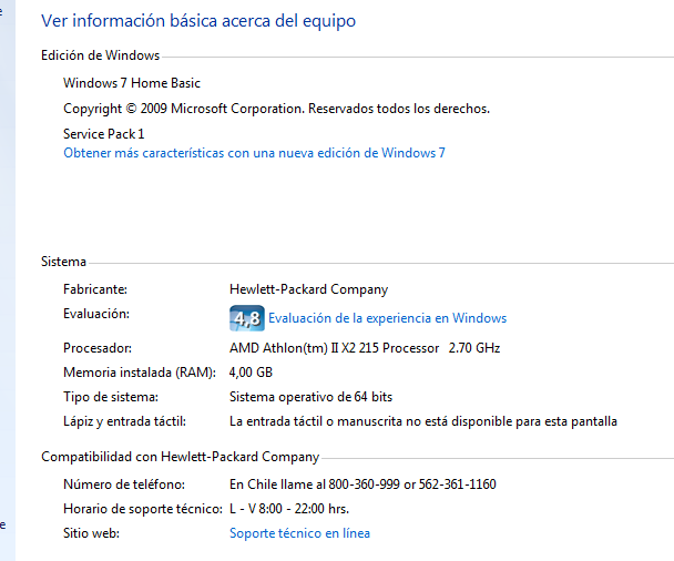

    My system

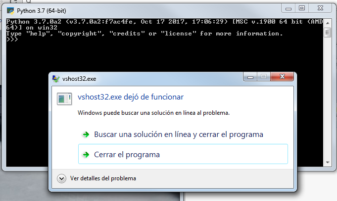

    Arduino, 4DOF

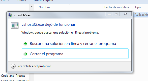

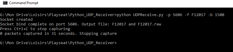

    The python application to capture UDP you mean ? Strange. Python should work on any PC windows/linux/whatsoever. You installed version 3.x ?
    Output should look like this:
  20. santanadany
    santanadany Member
    Aug 30, 2017
    60
    Chile
    605Coins
    +19 / 0 / -0
    yes, 3.7 Version
