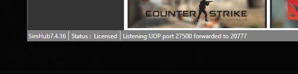

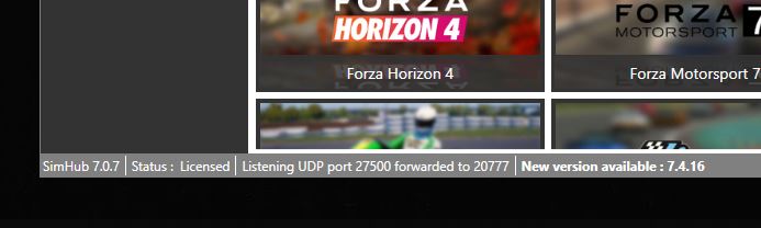

    2DOF, SCN5
    It works as they say. Simhub 2018 and forward it. Also change it in F1 2021 Telemetry from 2021 to 2018
    Many thanks guys I like it a lot...
      File size:
      18.3 KB
      Views:
      433
  12. hideki
    hideki Active Member
    Feb 3, 2014
    169
    Spain
    - 208Coins
    +54 / 1 / -0
    2DOF, SCN5
    IMPORTANT My Simhub detects that I am playing F1 2021 and connects to it in the midle of the game so I had to install an old Simhub version with no F1 2021 support to make it work with no problems, In the Games window of SimHub click once on F1 2018 it will turn blue and it wont move from there, New versions will go back to 2021 window so it stops "listening" the game. Maybe I am doing something wrong but this is ok to me and the plugin is really good for my liking
