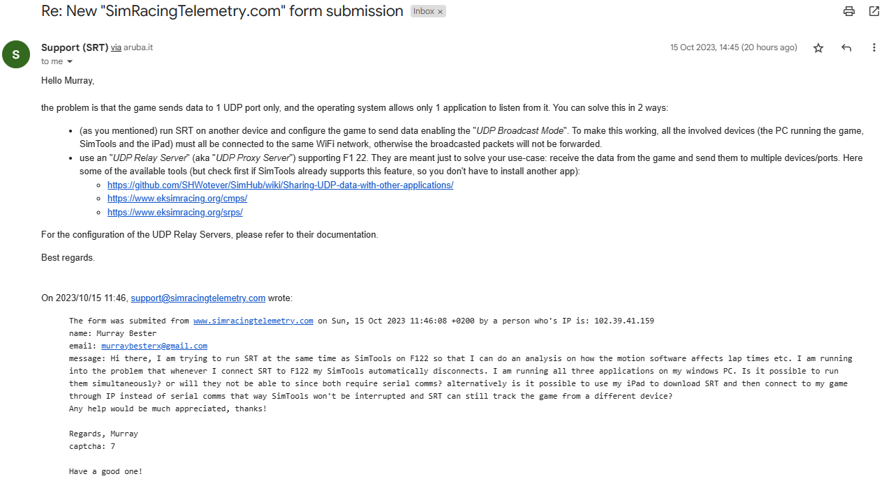

    Hi all, I am trying to use Sim Racing Telemetry (SRT) and SimTools at the same time so I can run analysis on the motion software but whenever I open and connect SRT my motion output on the tuning center shows no input. The recommended telemetry setting on F122 require the 2022 version to connect to SRT but when I do this my SimTools doesnt work. Would someone mind explaining to me how UDP works? I assume that it runs serially which is why SimTools and SRT won't work together unless they have the same year version right? or am I missing something?

    You can't have both trying to access the same data at the same time. One would have to pass on the data to the other.

    So my aim is to basically run a number of laps on different tracks within F122, some laps will be run using the motion outputted from SimTools and my motor, and some laps will be run without any motion at all. What I would like to do is have SRT recording these laps/sessions so that I can then do an analysis between running motion software and not running any software to determine what effect having motion in a sim rig has. The issue I am running into is that when I try to record a session on SRT my SimTools doesn't read any inputs from the game.
    I am trying to figure out how I can run both applications simultaneously. I contacted the SRT team to try figure out a solution and this is the reply they sent me:
    I am currently trying to run SRT on my Laptop and have it communicate to the F122 game on my PC to see if that will work. Will post an update if I get anywhere, otherwise I will try passing the data through a UDP relay however I am unsure how SimTools will react to that.
  18. noorbeast
    22,124
    154,370Coins
    +11,179 / 57 / -2
    SRT has given you the same reason as provided here regarding UDP and seems to indicate that SimHub can be used with SRT. As s already advised here, SimHub can be configured to port forward UDP when used with SimTools, please see the FAQs here: https://xsimulator.net/community/faq/simhub-port-forwarding.356/

    UPDATE!! I managed to get the two applications to work simultaneously. Firstly, because SimTools does not communicate via UDP 2022 format I had to use the free trial for the 2018 F1 game on SRT, this lets me keep my UDP format on 2018 in-game for SimTools. I tried running both software apps on my PC but this would not work since they cannot both listen in on UDP port 20777.
    What I then tried was running SRT on my laptop and giving it the same UDP settings as SimTools. This works perfectly as long as you enable broadcast mode. I tested this by running a few laps with the tuning center open where I saw inputs coming in while I was driving, I then also hit record on SRT on my laptop and it recorded my driving session and let me analyse once I was finished.
