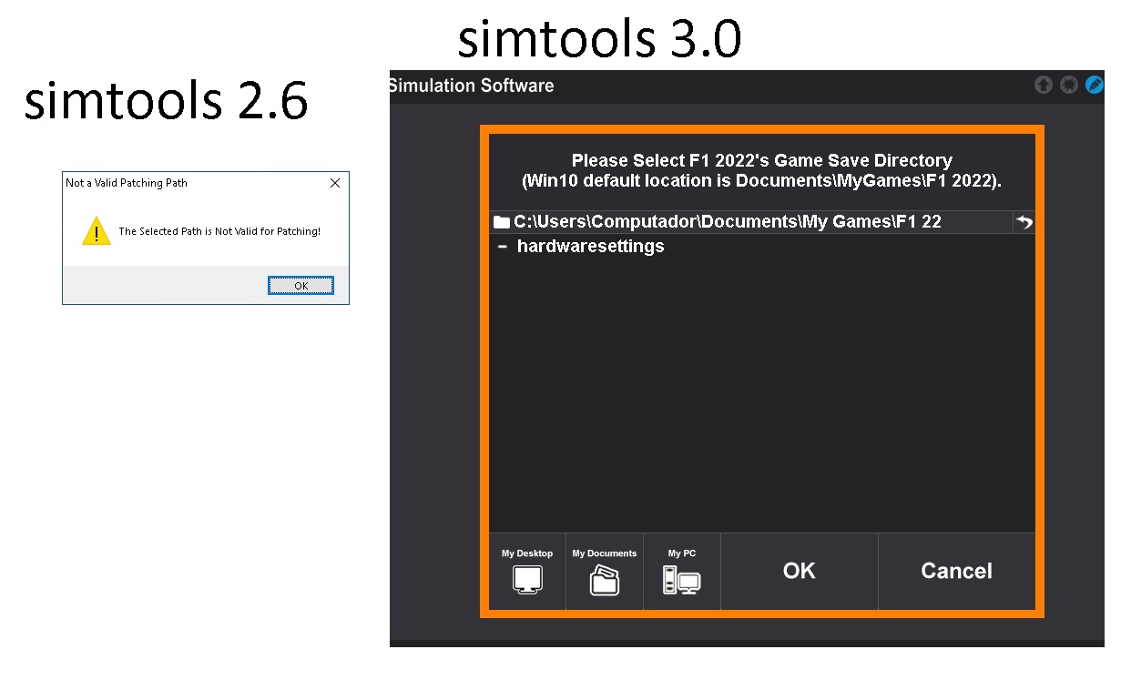

  5. Rodrigomarcos1978
    Rodrigomarcos1978 New Member
    May 13, 2022
    24
    Brasil
    103Coins
    +18 / 0 / -0
    2DOF, 3DOF, DC motor, Arduino
    Can someone help me ?
    I formatted and reinstalled everything on my computer. Now I can no longer install the plugin for this game.
    I already played for hours, doing several complete laps.
    I am selecting the correct game SAVE folder, but it does not accept it. C:\Users\Computer\Documents\My Games\F1 22
    I tried both Simtools version 2.6 and version 3.0.
    Can anyone help?
  6. yobuddy
    51,739Coins
    +5,205 / 19 / -0
    What is the error logging message you have in v3?
    I can see a little blue pen in the pic is all.
    Also, what's in the hardware settings folder I see in the pic buddy?
  7. Rodrigomarcos1978
    May 13, 2022
    24
    Brasil
    103Coins
    +18 / 0 / -0
    Hello..
    The only error message is the one in the attached image.
    Inside My Games there is the F1 22 folder and inside there is another folder: hardwaresettings \
    where there are two files:
    hardware_settings_config_VR.xml
    hardware_settings_info.xml
  8. yobuddy
    51,739Coins
    +5,205 / 19 / -0
    Do you only have VR or something, no monitor hooked up?
    Usually there is a 'hardware_settings_config.xml' file in that folder also is why I ask.
    I should be able to push an update to the plugin to make it work thou.
  9. yobuddy
    51,739Coins
    +5,205 / 19 / -0
    @Rodrigomarcos1978,
    The F1 2022 plugin has been updated, and should work for you now.
    Let me know if you have problems buddy.
    Take care,
  10. Rodrigomarcos1978
    May 13, 2022
    24
    Brasil
    103Coins
    +18 / 0 / -0
    Hello.. Yesterday, after your tip I was able to use it. Thank you very much !!! What I did was just play a game using the monitor. I usually play using VR only, so I hadn't done any monitor-only racing. It worked perfect!! thanks
