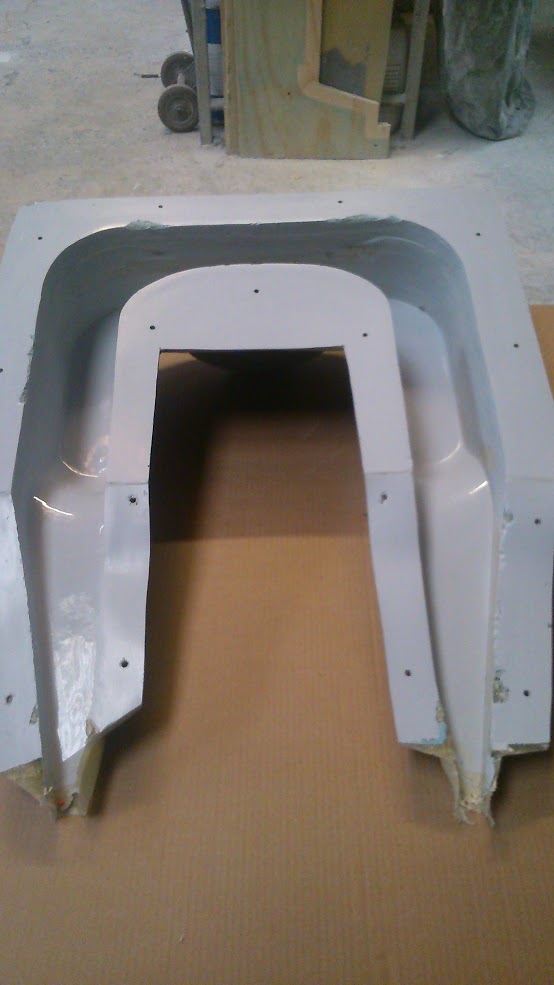

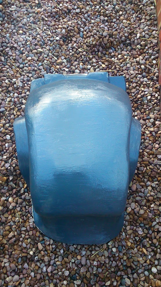

    So two more pictures to try and keep you all interested
    on the left the mould for the head cockpit surround and on the right the seat mould. There is alittle bit more refinement required on them both but hopefully ishould be able to get a mould from both soon. As I am waiting on the seat to progress with the whole project.

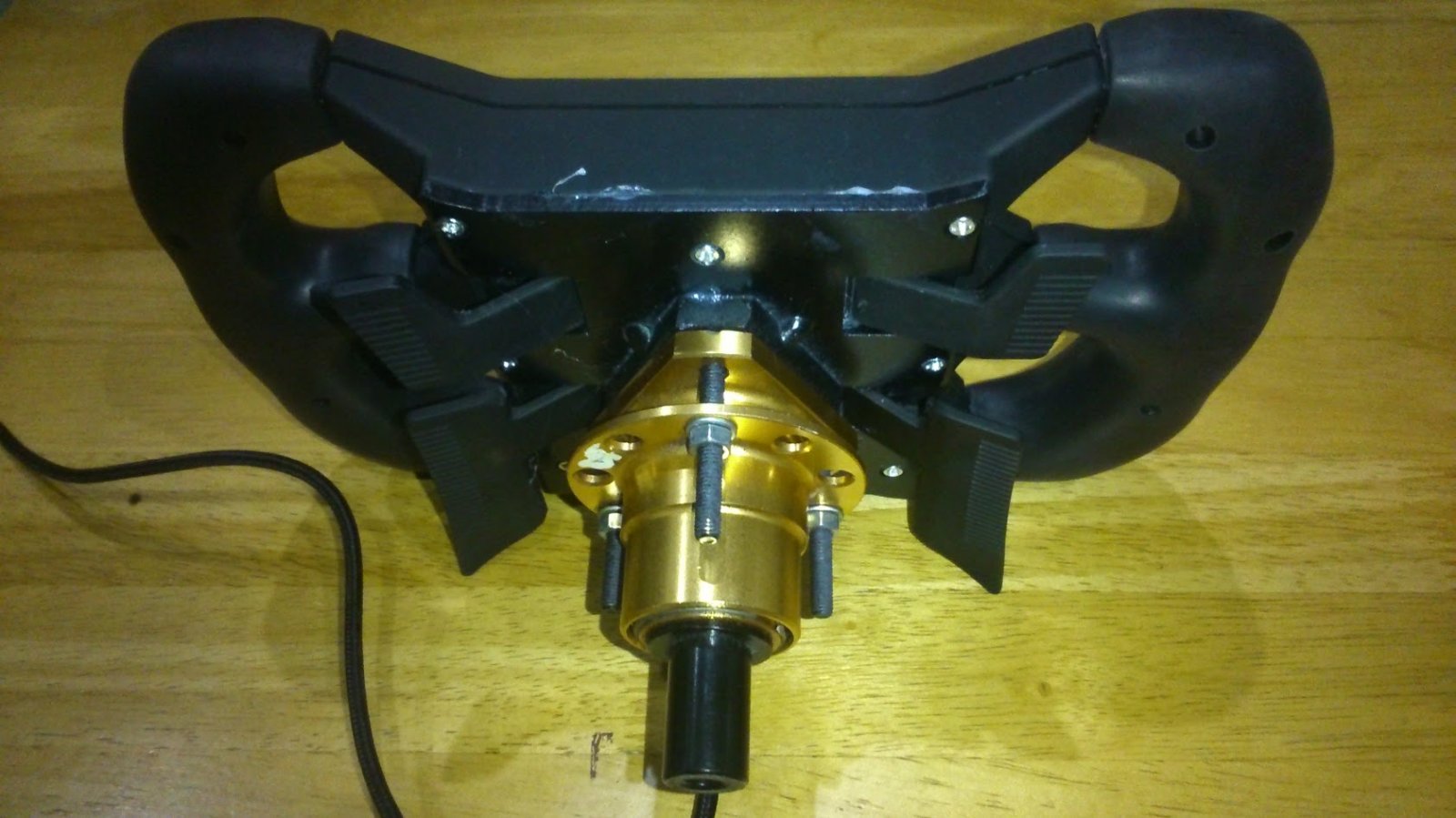

    so finished making the bracket for the quick release for the srw-s1 wheel and have mated them together. Just need to cut down the bolts and use some nylon nuts.

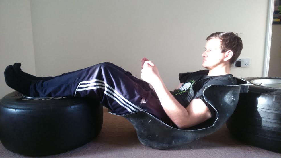

    @SeatTime me
    So heres the seat . Alttle more worked required but now i can look at how it will be secured in the monocoque. ham1.jpg seat1.jpg

    Hi. Great job. Real f1 wheels??? The comparison to the seat hamilton is sitting is a great idea. Depending on playtime you may like a little more lumbar support, also it seams you have some kyphosis in thorax. Looks confortable anyway. Sorry for talking smart, your diy skills are obviously way above mine, pls take no offence! As i broke my spine twice with snowboarding backpain is a good friend of mine.

    Hi yes they are real f1 wheels :)
    The photo might be aa bit misleading as i am quiet a bit taller than Lewis Hamilton and much heavier. If it wasnt for my big backside which is pretty much on the floor i presume it wouldnt look like my back is curved some much. Although it is pretty comfortable to sit in. self adhesive padding could be added to aid comfort. Plus with changes to regulations of the monocoque my legs might not be as high as they are in the photo.
    I also think seat belts would aid in comfort so i will bear that in mind.

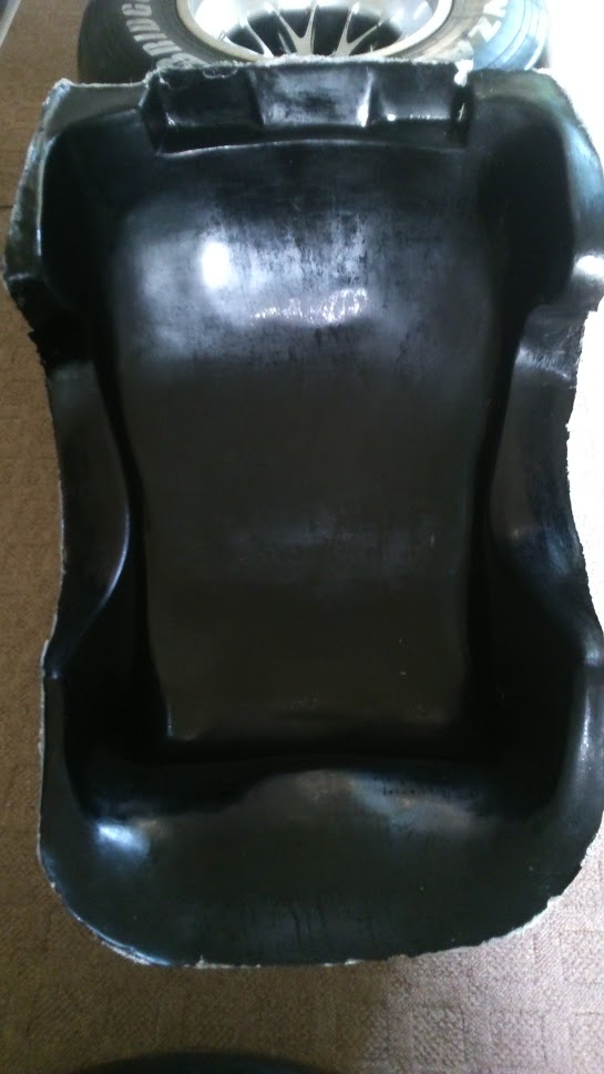

  13. mrt
    mrt Member
    Aug 31, 2013
    74
    United Kingdom
    719Coins
    +62 / 0 / -0
    3DOF, SCN6
    Another view of the seat

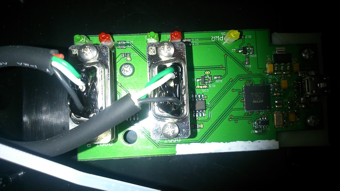

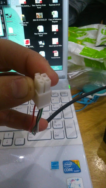

    Hi @mrt Would you happen to have a wiring diagram and a couple of pictures of how you connected the hyperaxis 100 and the scn6 to the boards. Im fine with the power but its just this part i'm struggling with. I have order 5x db9 cables to cut one end off but need to connect this end to the actuators and dont want to connect the wrong wires
    thanks
    Jay
  15. mrt
    mrt Member
    Aug 31, 2013
    74
    United Kingdom
    719Coins
    +62 / 0 / -0
    3DOF, SCN6
    Hi Hope these help. I dint have the hyper axis on me so you would have to look at the shape of the plastic connector. Although i will tru and get a picture of the hyper axis later. DSC_1234.JPG DSC_1235.JPG
    on the plastic clip the black wire is on the bottom left and green on the bottom right and white on top right.
    on the rs232 connector the green is on the first pin on the top ( looking at my photo) followed by white and on the bottom of the top row is the black

    Thanks @mrt . That is absolutely spot on. That should be all i need. I see you made your Wires to go into the 485 board. I have bought the other halfs of the connectors your are holding which should be here today. so i will get them put together tonight and if my db9 fittings arrive tomorrow i should be good to go.. I got some rs232-rs485 convertors to get the boards below for easy connection but i may cut down some rb9 cables at a later date for neatness which i also ordered.
    Just knowing the pins i would of got away with just cutting down some cables, but thought i would rather have stuff not needed, that need stuff that i dont have
