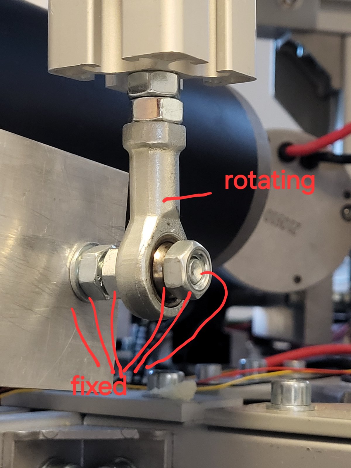

    @_cOdaC_
    I might have gotten lost in translation, too, so please forgive me if I misunderstood something. To me it looks like you have not held on of those ball joints in your hand and you don't really know that the "inner" part (the "ball") of the ball joint can freely rotate around the axis if the hole. Please see the attached pictures.

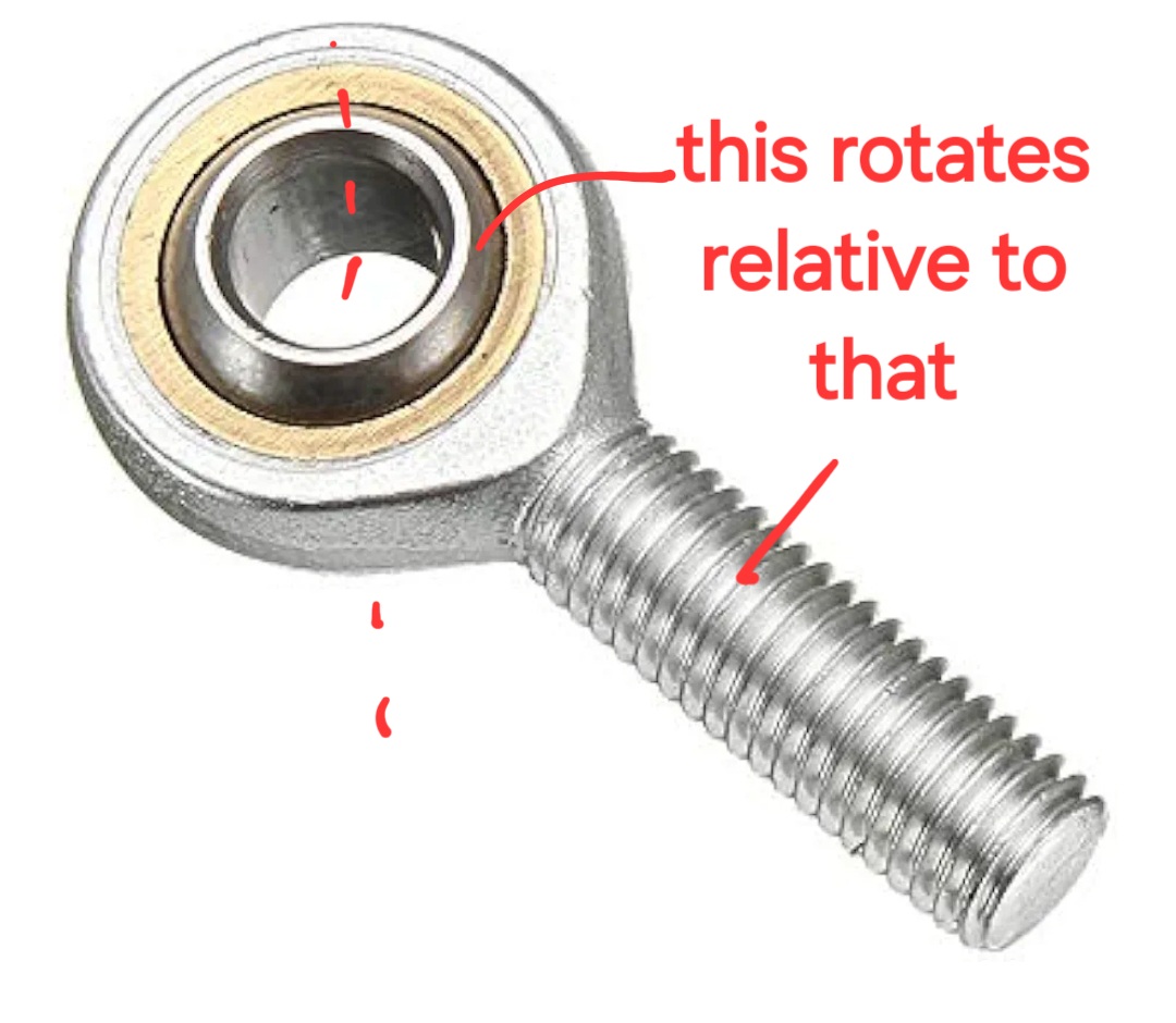

    No lubricant is needed here. The screw doesn't turn inside the lever or inside of the "ball" part of the ball joint. Instead, the ball turns inside the joint. See section above and attached pics.
    Correct. I'm a little confused about the "only", though. What else could be done to secure a screw, besides tightening a nut? Are you talking about counter-nuts, self-locking nuts, loctite etc. or is this about something else?
    This shouldn't be much of an issue. You could use a threaded rod to connect the ball joint to the brackets (like I did) and use firmly tightened nuts to hold everything in place. The friction from the nuts should easily be strong enough to keep the rod in place, even though the hole is not circular.

    Thank you for clarifying that (the screw rotation bit) @Sebastian2, Yes I havent had a ball joint in my hands yet, but now I do. I‘ve built a lot of other DIY lrojects but nothing compared to that, so I‘m a total novice.
    By the way the „only“ was meant to be a „there is missing this and that“ it was more like a: „I would not habe thought that these bits are going to hold such a movement“, like being positively suprised.
    I‘ve ordered the nuts with oval holes now.

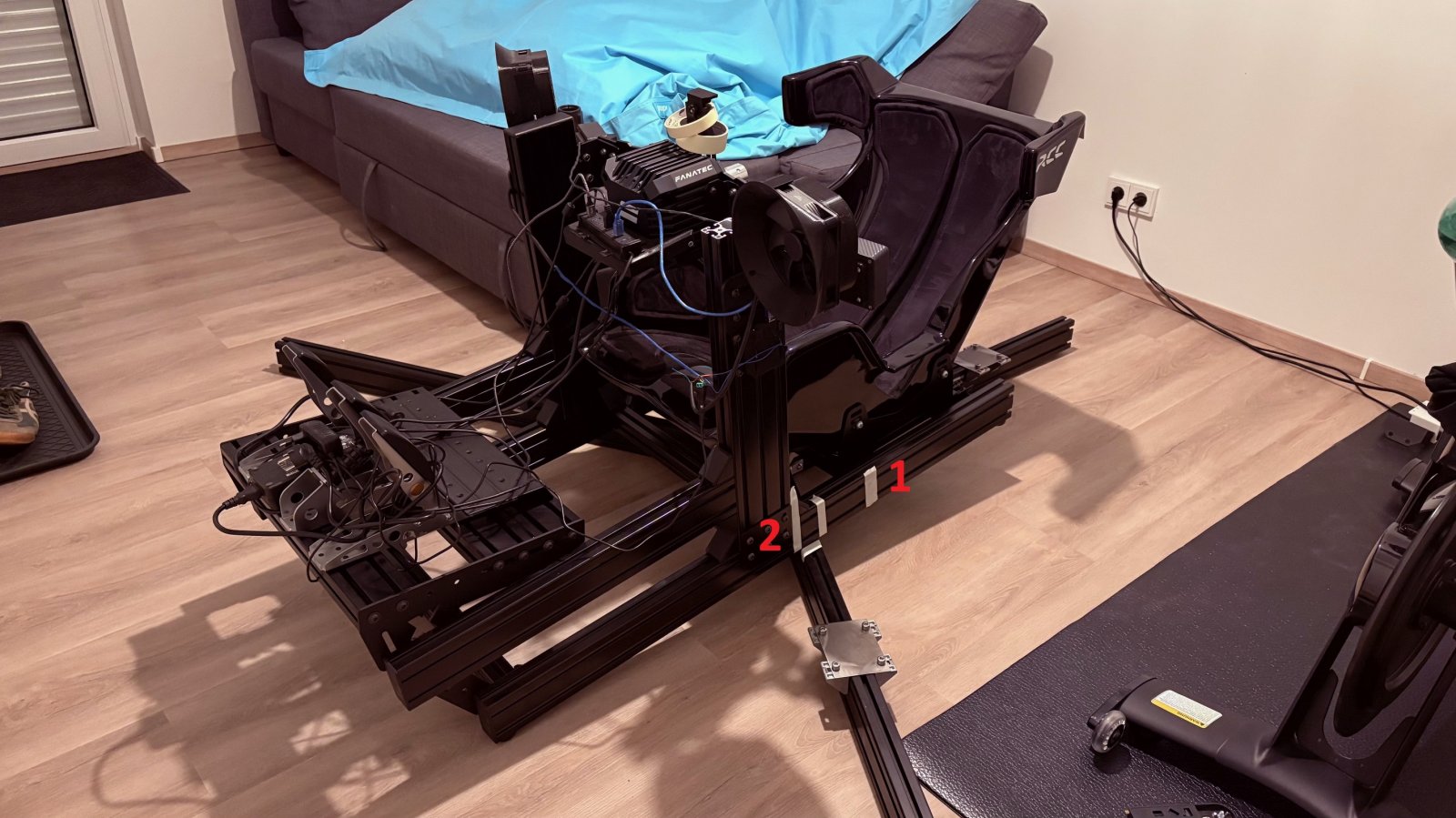

    Anyways, I have worked as much on the project as I could and happy to give an update.
    I have marked the Center of Gravity following the FAQ which is the "1" marking on the first photo.

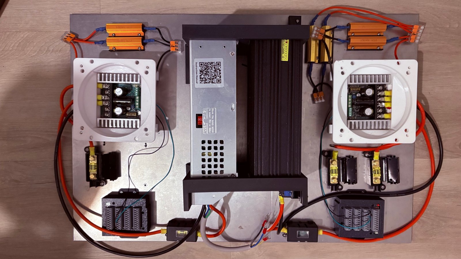

    Underneath the upper rig you can see 40x80 profiles that are connected in the center with 120° connectors. The center of the three profiles connecting to each other is right underneath the CoG. As the connectors are M6, I simply drilled them up to M8. On the "2" marking you can see where the upper rig meets the lower frame. I take this marking to better assume where the motors are going to be placed and to guess where to cut the profiles as they are 120cm long and standing out too far. From the "2" marking, currently I think I'll take another 20cm to the end and cut them. The rest of the frame (the leftovers) I'm gonna take to attach it at the ends of the the Y-Frame as a cross-connection to make it more stable.
    Further more I have build the control plate. It's not all finally wired up, but if you take a look at the wiring diagram you might get the idea behind it.

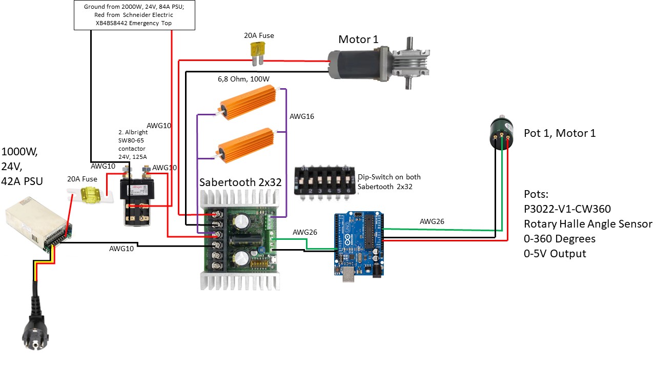

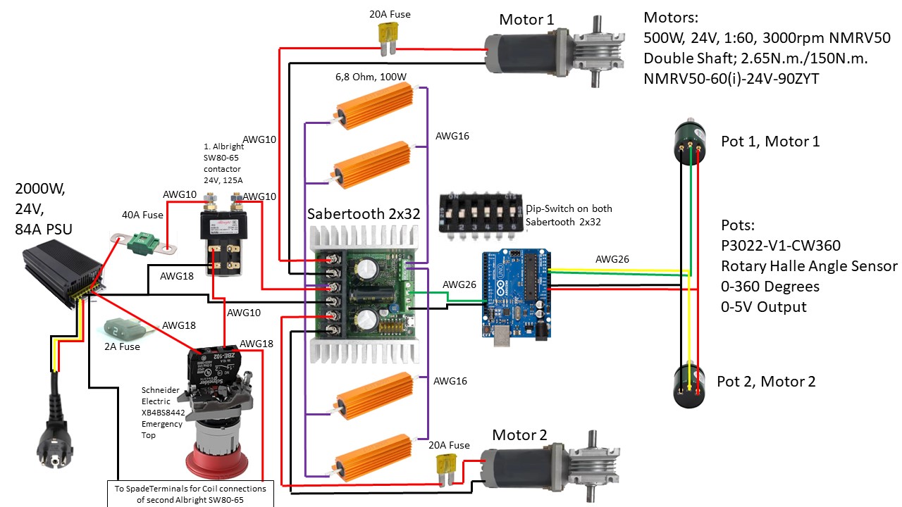

    On the right hand side you see a 2000W PSU (the black one) going over a 40A fuse (yes its not 60A as I followed @Sebastian2 recommendation), going into the right hand side sabertooth. This Sabertooth is meant to control two motors, which is why I have attached 2 x 2 6,8 Ohm/100W resistors. I'm going out of the Sabertooth with two 20A fuses and from there I'm going to connect the motors.
    On the left hand side you see basicly the same thing, just set up for one motor. the only difference is the PSU which is 1000W and the fuse right behind the PSU which is a 20A fuse.
    the lower black boxes with the green and black wire are two Arduino Unos controlling the Sabertooths. Later on I'm gonna connect the potentiometers to the Arduinos.
    Happy to get your feedback.

    The Arduino Nr1 is connected to the 2x32 Sabertooth Nr1 like this:
    Sabertooth 0V to Arduino GND
    Sabertooth S1 to Arduino PIN 13
    This Sabertooth is connected to two motors.
    The Arduino Nr1 is connected to the two POTs (I have changed them to 180 POTs instead of the former 360)
    POT1 GND to Arduino GND
    POT1 5V to Arduino 5V
    POT1 VOUT to Arduino A0
    POT2 GND to Arduino GND
    POT2 5V to Arduino 5V
    POT2 VOUT to Arduino A1
    The Arduino Nr2 is connected to the 2x32 Sabertooth Nr2 like this:
    This Sabertooth is connected to only one motor.
    The Arduino Nr2 is connected to one POT (I have changed it to a 180 POT instead of the former 360)
    POT3 GND to Arduino GND
    POT3 5V to Arduino 5V
    POT3 VOUT to Arduino A0

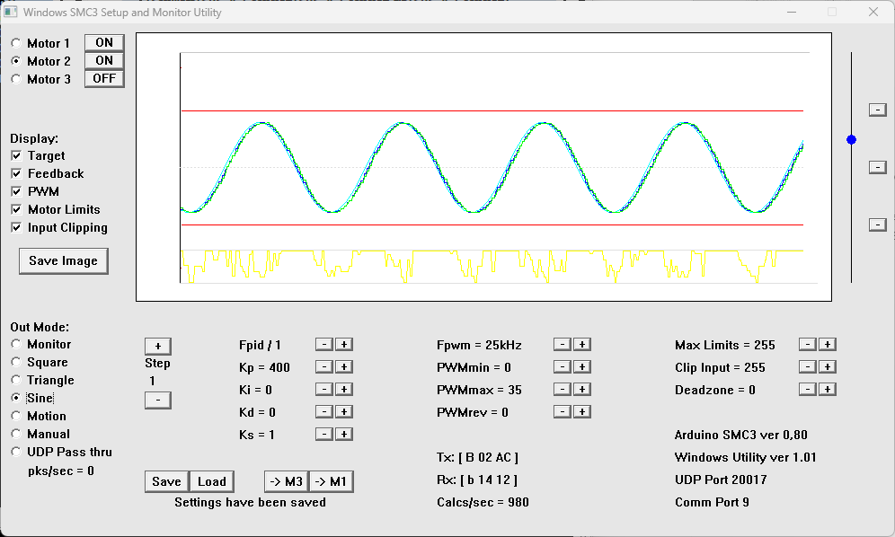

    Now, The first Motor on Arduino Nr 1 and 2x32 Sabertooth Nr 1 and POT1 works fine.
    The second Motor on Arduino Nr 1 and 2x32 Sabertooth Nr 1 and POT2 has the same problem like the third Motor on Arduino Nr 1 and 2x32 Sabertooth Nr 2 and POT3.
    In both cases, using SMC3 (v. 0.80), when increasing PWMmax, the PWM 8yellow line) goes up. The green line (Feedback) stays where it is unchanged. It seems like the POTs (2 and 3) are not giving any Feedback, but POT1 does.
    Is there anything I need to set as a parameter in the Arduino code?
    Is there any way how to check if the cable connection is working (especially the VOUT Signals)?
    Any help is appreciated.

    As far as I understood, the green POT value displayed in SMC3Util does not change, when you physically turn POT2 and POT3?
    Are you aware that you have to switch between the motors to see the different pots in SMC3Util? Look at the buttons in the upper right corner of SMC3Util.
    Also, are you sure your SMC3Util is connecting to the Arduino thats connected to POT2 and POT3?
    You can check by only connecting the POT2/3 Arduino to your PC.
    There is some ini file in the SMC3Util folder where you configure the COM port SMC3Util should use.
    I recommend having a sepearte copy of the SMC3Util folder for each arduino. Each folder can have it's own config file with a different COM port.
    If the issue persists, i recommend checking the pot with a multimeter in voltage mode. Connect it to GND and the cable you would put into the arduino. Then pyhsically turn the pot. The voltage displayed by the multimeter should change from about about 0 to about 5 V.

    Hey Sebastian, correctly understood. And yes I am aware, that I need to change the Motors in the upper right.
    The weird thing is: POT1 and POT2 are connected to the same Arduino. POT1 works, POT2 doesnt.
    POT3, which is connected to another Arduino, doesnt work as well.
    And yes I have changed the COM port to the correct Arduino(s). I am sure about that because all three motors rotated (separately) when I increased the PWMmax.
    Thank you for the hint with the multimeter. Thats the next thing I'm going to test.

    Thank you @Sebastian2, while I measured the Volts, I recognized that the 3D printed gear that I put on the Pots were too lose and didn't turn the Pot. I'm finalizing the 3D prints now and fix them onto the Pots or Motors so that everything sits tight.

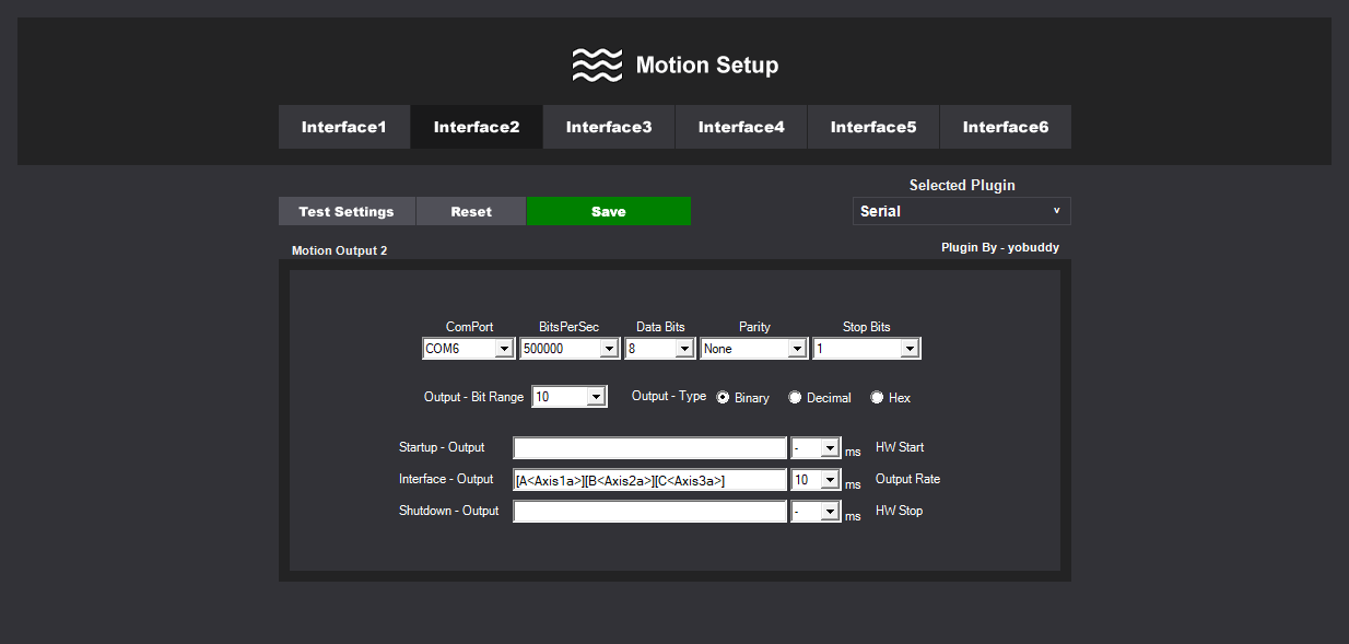

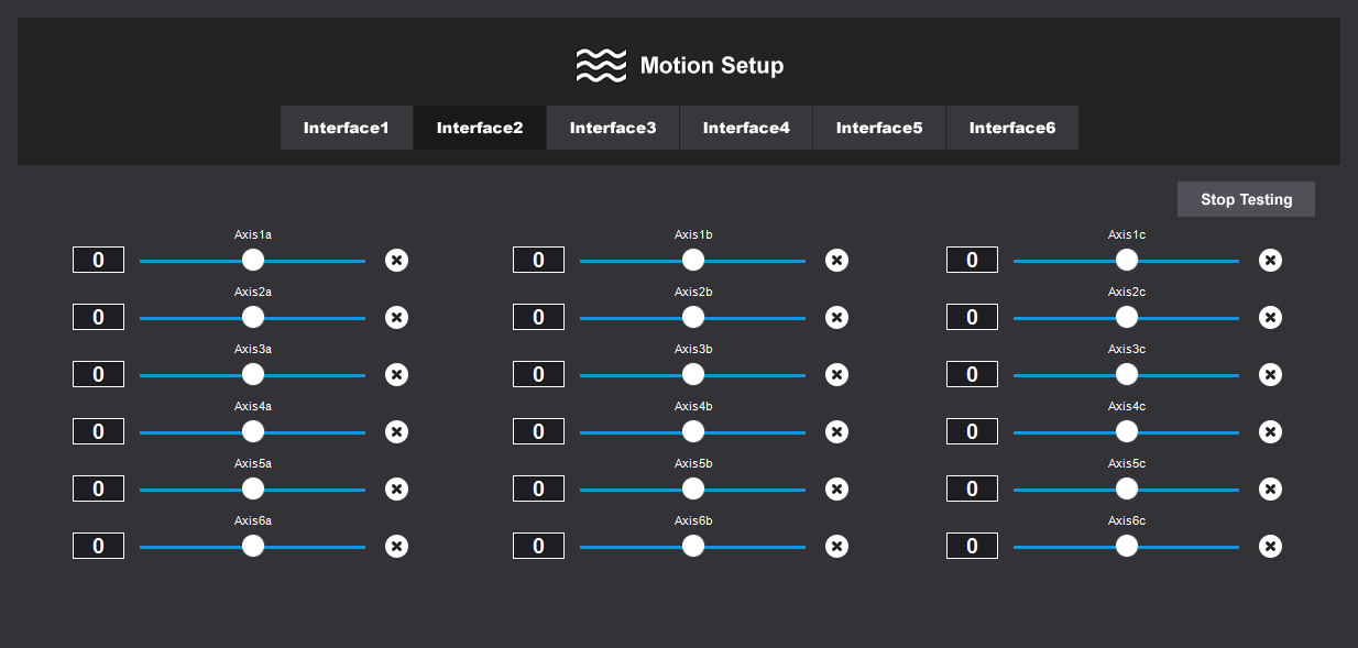

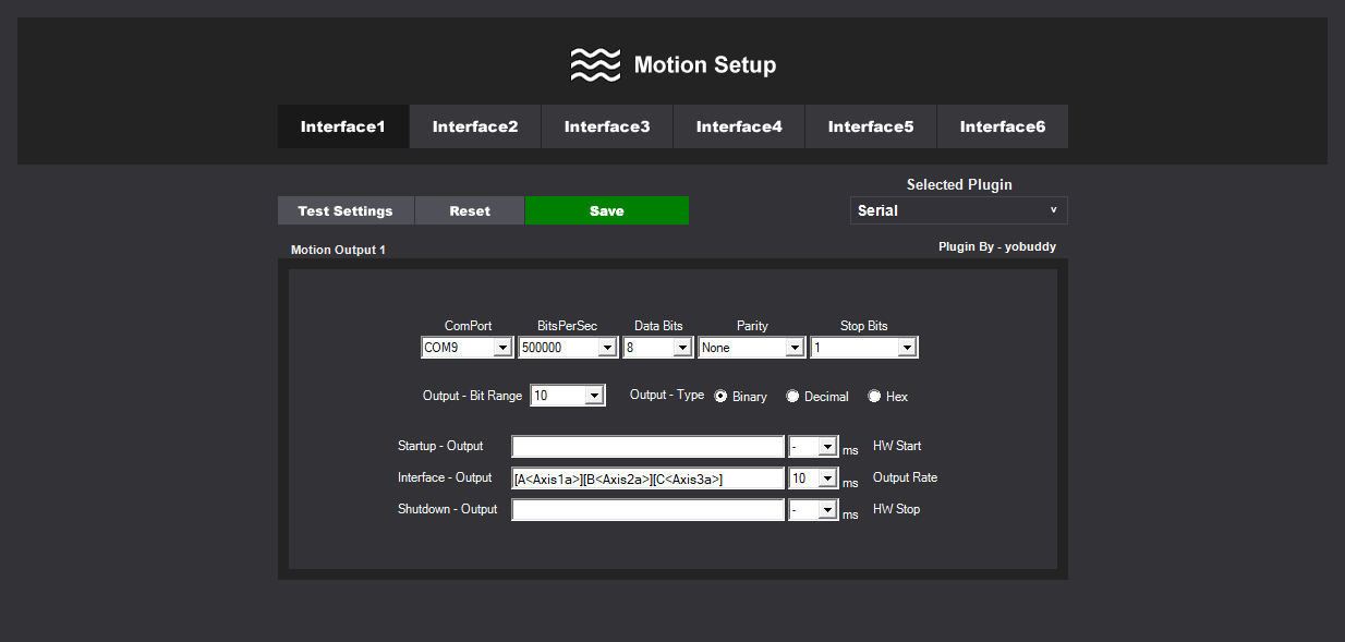

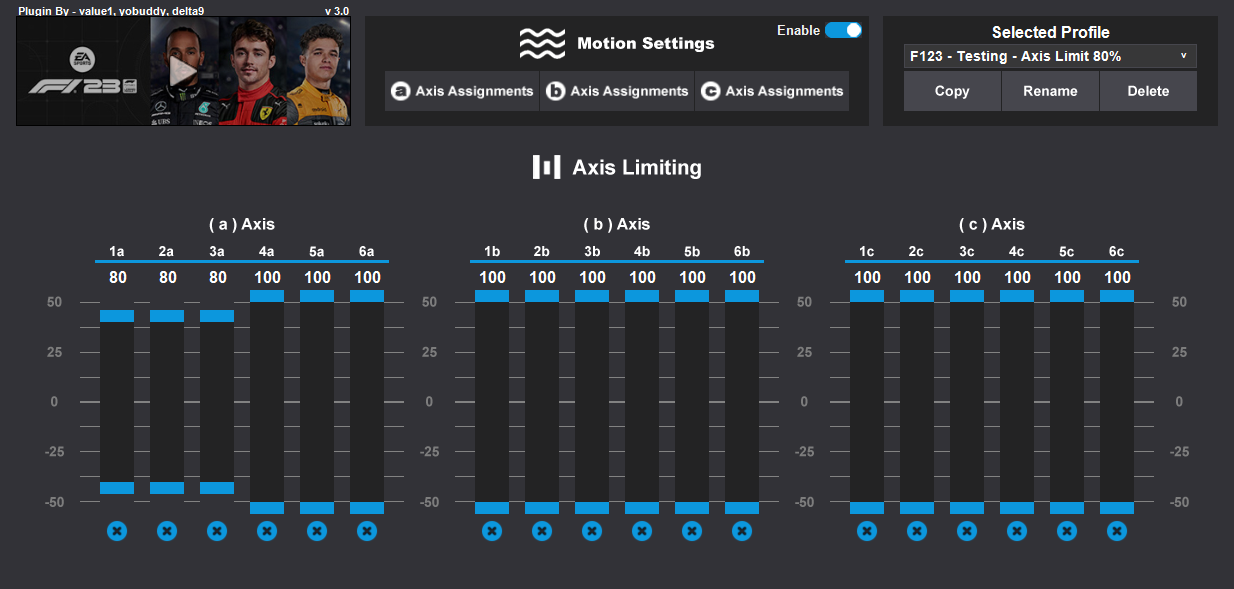

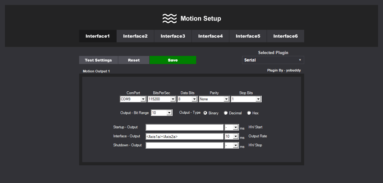

    Now, I'm working my way through SIMTools and Testing wont get the motors moving.

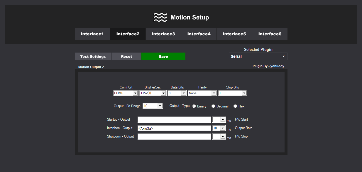

    I have installed the PC Game Plugins for ASsetto Corsa Competizione, Assetto Corsa Evo and F1 2023.
    I have installed the Axis Plugin "Generic 2D Standard".
    I have installed the Interface Plugin "Serial".
    Here are my settings:
    I have connected the two Arduinos via USB to the PC.
    When going to the Test Settings and changing the Axis1a, Axis2a or Axis3a values, nothing happens.
    ==============PLEASE FIND THE SOLUTION HERE ==============

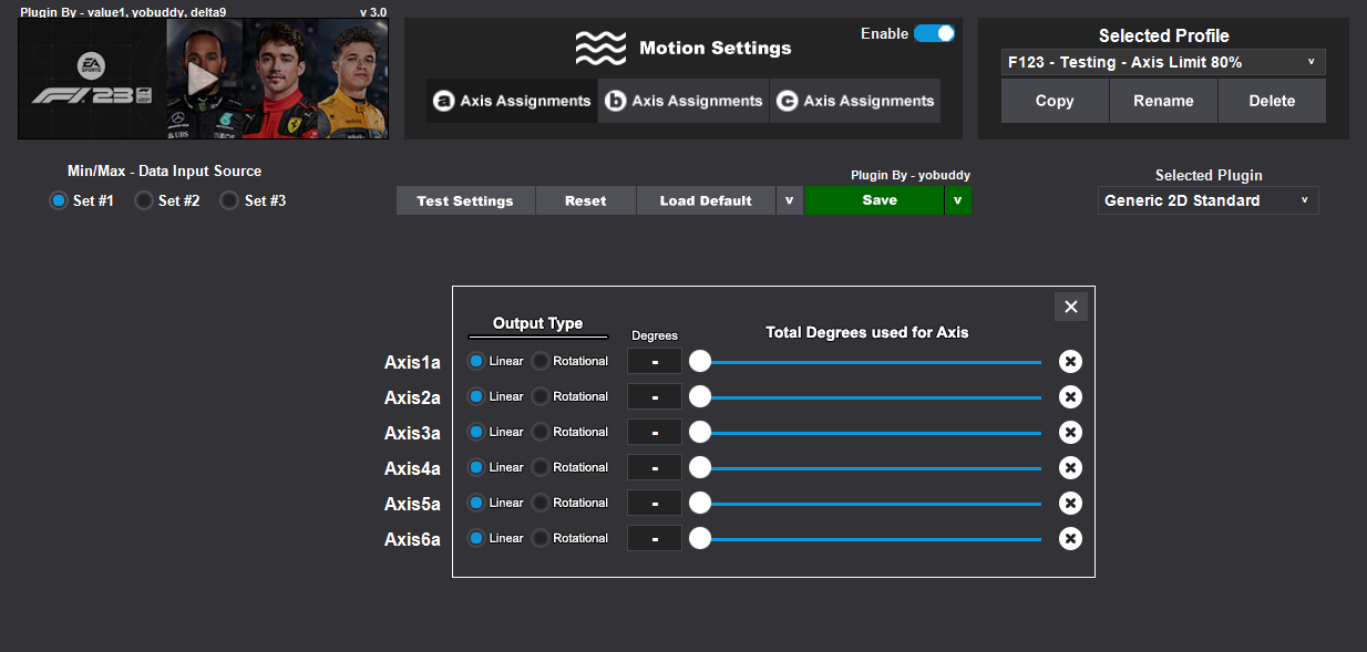

    22,185
    154,750Coins
    +11,196 / 57 / -2
    What are your Axis Assignment settings?
    Your Interface settings are configured for 6 axis.
    Do check out the Quickstart guide: https://simtools.us/wp-content/uploads/2024/02/QuickStart-Guide-for-SimTools3.pdf
    And SimTools manual: https://simtools.us/wp-content/uploads/2024/02/SimTools-v3.pdf
  12. _cOdaC_
    _cOdaC_ Member
    Dec 20, 2023
    70
    348Coins
    +9 / 0 / -0

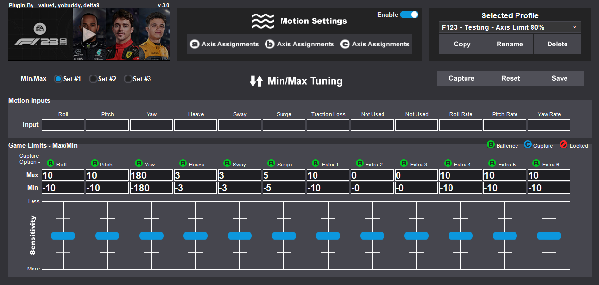

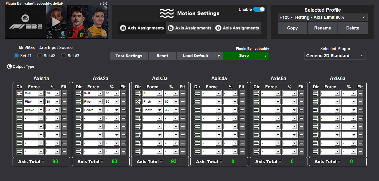

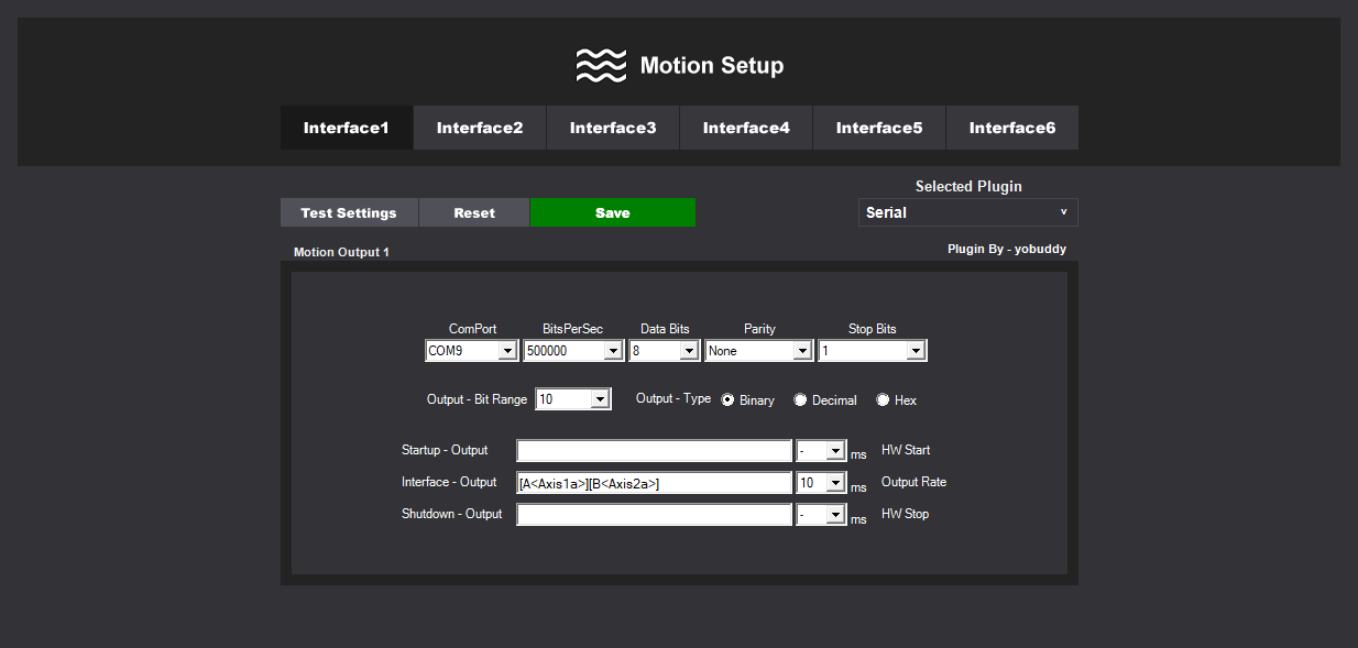

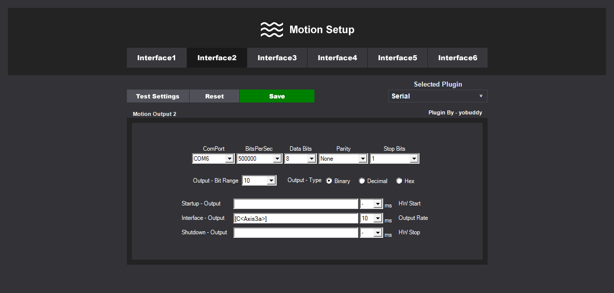

    Thank you @noorbeast for the docs. After reading them all, watching numerours Youtube Videos, the best to my knowledge I could come up with is this (screenshots). But still the motors are not moving with SimTools v3.0 Beta. It all works in SMC3 Utils though.
    Screenshot 2025-03-10 155518.png Screenshot 2025-03-10 155529.png Screenshot 2025-03-10 155546.png Screenshot 2025-03-10 155603.png Screenshot 2025-03-10 155610.png Screenshot 2025-03-10 155628.png Screenshot 2025-03-10 155641.png Screenshot 2025-03-10 160106.png
    I've tried it with BitsPerSec 115200 and 500000, as well as [A<Axis1a>][B<Axis2a>) (Interface 1) and [C<Axis3a>] (Interface 2) or <Axis1a><Axis2a> and <Axis3a>.
    I've tried the Test-Settings in Motion Setup (Interface Setup) and Test Settings in the Game Plugins.
    I even disbaled the firewall and antivirus.
    I just don't get why the motors are not moving in Simtools with SPS 8.2 softstart.
  13. noorbeast
    22,185
    154,750Coins
    +11,196 / 57 / -2
    The settings should be:
    BitsPerSec - 500000
    Interface Output - [A<Axis1a>][B<Axis2a>]

    I've tried it already, but took your settings again and I just cant get the motors moving at all (besides SMC3).
    I have disabled Windows Defender, Disabled the Firewall, reinstalled Simtools on my Windows 11 PC, nothing seems to work. The Arduinos are Clones.
    What else can I check?

    It seems that SimTools v3.0B gets a connection with the motors on COM Ports 9 and 6 (as I get no error messages in the Error Log).
    BitsperSecond = 500000
    Data Bits = 8
    Parity = None
    Stop Bits = 1
    Output Bit Range = 10
    Output Type = Binary
    Interface - Output = [A<Axis1a][B<Axis2a>] (for Com Port 9) Interface - Output = [C<Axis3a>] (for Com Port 6) Output Rate = 10ms
    When entering Test Mode and I move the axis, no motor is moving.
    I've read the manual, FAQs, watched several hours of Youtube videos, but I just can't find the root cause, why the motors are not moving.
    I debugged today so hard to find the root cause. I dont know, but maybe I found something?!
    I have created a virtual COM-Port so that on the same PC, I can use SimTools using Port 9 and Putty using virtual Com Port 13. So I am able to use SimTools sending Data and Putty to read the sent data of the same Port (both Ports are paired). Otherwise Port 9 would be blocked by SimTools and I would not be able to read the traffic with Putty.
    I mean, I know that SimTools uses Binary Output but the Output I get looks really weird, which I think is the reason, that the SPS 8.2 softstart Sketch cant interprete the values and so nothing moves.
    The Output of SimTools I can read via Putty is:
    ▒][A▒][A▒][A▒][A▒][A▒][A▒][A▒][A▒][A▒][A▒][A▒][A▒][A▒][A▒][A▒][A▒][A▒][A▒][A▒][A▒][A▒][A▒][A▒][A▒][A▒][A▒][A▒][A▒][A▒][A▒][A▒][A▒][A▒][A▒][A▒][A▒][A▒][A▒][A▒][A▒][A▒][A▒][A▒][A▒][A▒][A▒][A▒][A▒][A▒][A▒][A▒][A▒][A▒][A▒][A▒][A▒][A▒][A▒][A▒][A▒][A▒][A▒][A▒][A▒][A▒][A▒][A▒][A▒][A▒][A▒][A▒][A▒][A▒][A▒][A▒][A▒][A▒][A▒][A▒][A▒][A▒][A▒][A▒][A▒][A▒][A▒][A▒][A▒][A▒][A▒][A▒][A▒][A▒][A▒][A▒][A▒][A▒][A▒][A▒][A▒][A▒][A▒][A▒][A▒][A▒][A▒][A▒][A▒][A▒][A▒][A▒][A▒][A▒][A▒][A▒][A▒][A▒][A▒][A▒][A▒][A▒][A▒][A▒][A▒][A▒][A▒][A▒][A▒][A▒][A▒][A▒][A▒][A▒][A▒][A▒][A▒][A▒][A▒][A▒][A▒][A▒][A▒][A▒][A▒][A▒][A▒][A▒][A▒][A▒][A▒][A▒][A▒][A▒][A▒][A▒][A▒][A▒][A▒][A▒][A▒][A▒][A▒][A▒][A▒][A▒][A▒][A▒][A▒][A▒][A▒][A▒][A▒][A▒][A▒][A▒][A▒][A▒][A▒][A▒][A▒][A▒][A▒][A▒][A▒][A▒][A▒][A▒][A▒][A▒][A▒][A▒][A▒][A▒][A▒][A▒][A▒][A▒][A▒][A▒][A▒][A▒][A▒][A▒][A▒][A▒][A▒][A▒][A▒][A▒][A▒][A▒][A▒][A▒][A▒][A▒][A▒][A▒][A▒][A▒][A▒][A▒][A▒][A▒][A▒][A▒][A▒][A▒][A▒][A▒][A▒][A▒][A▒][A▒][A▒][A▒][A▒][A▒][A▒][A▒][A▒][A▒][A▒][A▒][A▒][A▒][A▒][A▒][A▒][A▒][A▒][A▒][A▒][A▒][A▒][A▒][A▒][A▒][A▒][A▒][A▒][A▒][A▒][A~][A|][A{][Ay][Aw][Au][Au][As][Aq][Ao][Am][Ak][Ai][Ag][Ag][Ae][Ac][Ab][A`][A^][A\][AZ][AZ][AX][AV][AT][AR][AP][AN][AL][AK][AK][AI][AG][AE][AC][AA][A?][A=][A;][A;][A9][A7][A5][A3][A2][A0][A.][A,][A*][A*][A(][A&][A$][A"][A ][A][A][A][A
    ][A ][A][A][A][A][A][A▒][A▒][A▒][A▒][A▒][A▒][A▒][A▒][A▒][A▒][A▒][A▒][A▒][A▒][A▒][A▒][A▒][A▒][A▒][A▒][A▒][A▒][A▒][A▒][A▒][A▒][A▒][A▒][A▒][A▒][A▒][A▒][A▒][A▒][A▒][A▒][A▒][A▒][A▒][A▒][A▒][A▒][A▒][A▒][A▒][A▒][A▒][A▒][A▒][A▒][A▒][A▒][A▒][A▒][A▒][A▒][A▒][A▒][A▒][A▒][A▒][A▒][A▒][A▒][A▒][A▒][A▒][A▒][A▒][A▒][][A}][A{][Ay][Aw][Au][As][Ar][Ap][An][Al][Aj][Ah][Af][Ad][Ab][A`][A`][A^][A\][A[][AY][AW][AU][AS][AQ][AO][AM][AK][AI][AG][AE][AC][AB][A@][A>][A<][A:][A8][A6][A4][A4][A2][A0][A.][A,][A+][A)][A'][A%][A#][A!][A][A][A][][A][A][A][A][A▒][A▒][A▒]
    You can see that in the lower middle the [A with many spaces was when I moved the Axis1a to the right. After that I stopped (X-Button) the movement and the Test.
    Furthermore I have double and triple checked tha the DIPs on the Sabertooth are ON/ON/OFF/OFF/OFF/OFF.
    The Config says 8-N-1. I have testet everything on 9600, 115200 and 500000 Baud, no change in behaviour.
    I have checked that Arduino 13 is correctly connected to Saberooth S1 and Arduino GND to Sabertooth 0V.
    I have testet Port 12 instead of 13. And many more.
    Another thing I found was, using some Debugging Code that Serial.available() > 0 is true and the void loop () runs once and after that the code seems to be stuck.
    I am SO lost.

    Can you please post a picture of your SMC3 settings, running the Sine Test.
  18. _cOdaC_
    _cOdaC_ Member
    Dec 20, 2023
    70
    348Coins
    +9 / 0 / -0
    Yes of course.
    Motor 1:
    Motor 2:
    Motor 3:
  19. _cOdaC_
    _cOdaC_ Member

    I might have found the solution in this post of @Miszor for why the motors are not moving in SimTools. It's gonna be the next thing I test out as soon as I have the time for it.
    I did the same thing and turned PWMmax to zero after each test in SMC3Utils.
    So PWMmax for SimTools is set to zero, hence no motor movement.
    You can see the solution quite well in this video at 49:47 when DMAX closes SMC3Utils, after switching to Manual mode and closing the App, he keeps the settings (PWMmax 200, etc). After that he openes SimTools:
    Another next step is PID tuning.
    It's hard for me as a novice to understand how the step by step procedure works.
    In this FAQ, the mentioned video is private now, so no possibility to watch it.
    In this tutorial, the terms are explained, but not how to find the right settings for your individual rig.
    Any suggestions on where to start and how to end the PID tuning?
  20. _cOdaC_
    _cOdaC_ Member
    Dec 20, 2023
    70
    348Coins
    +9 / 0 / -0
    Another update to this post.
    First of all: My assumption was correct. The fact that I set the PWMmax parameter to zero in SMC3Utils after each motion test and then started SimTools resulted in no movement in SimTools.
    Therefore, it makes sense to first perform PID tuning and determine the optimal values and save them in SMC3Utils.
    PID Tuning:
    I'll be honest: It was almost impossible for me to understand or deduce from the posts or tutorials in this community how to best perform PID tuning for my motors. For this reason, I used ChatGPT for support. I aligned the levers horizontally and ensured that the green feedback line was positioned as precisely as possible on the blue target line in SMC3Utils.
    Next, I started "Motion" mode and waited until the lines had horizontally passed through the SMC3Utils window once. I then took a screenshot of it and put it with the parameters from SMC3Utils into the ChatGPT prompt, requesting PID tuning. I also shared the feedback, as my motor, for example, was stuttering heavily at the beginning.
    In the end, I ended up with settings that worked well.
    Please note that these settings are specific to each motor manufacturer and type. Please do not copy/paste them to your motor setup.
    My values are (These values are still for testing purposes only and not the final settings):
    PWMfreq: 25kHz
    Kp: 235
    Ki: 2
    Kd: 9
    Ks: 6
    PWMmin: 0
    PWMmax: 115
    PWMrev: 0
    Limit: 255
    Clip: 255
    Deadzone: 4
    I saved these values in SMC3Utils, so you can see that PWMmax is not zero and SimTools should work fine now.
    I then opened SimTools and performed the first tests, and lo and behold: The motors were moving.

    I added an emergency stop switch to the wiring diagram (pls see below).
    Here, too, I had a lot of trouble figuring out how to implement this solution from the posts and tutorials in this community.
    I bought a Schneider Electric XB4BS8442 Emergency Stop. When purchasing, make sure you buy suitable products for AC or DC, depending on your needs.
    The product should also be rated for 24V in this setup. However, emergency stops in a lower price segment have a lower amperage rating. In my case, it's 10 amps. That's significantly too little for my setup. So I can't simply install the emergency stop in my wiring.
    The solution is the Albright SW80-65 Contactor, which is rated for 24V and a maximum of 125 amps (significantly more than necessary). However, the switching mechanism only has a coil power dissipation of 11.08 watts and 0.46 amps. For safety, I installed a 2 amp fuse in front of it (you could also use a 1 amp fuse also). Since this mechanism only uses 0.46 amps, it works perfectly with the Emergency Stop.
    I had another challenge, though. I have two PSUs. When I connected both PSUs in parallel and thus only plugged in one Schuko plug for the socket, there was an inrush current peak that tripped the 16 amp house fuse. Increasing the house fuse to prevent the fuse from tripping is not an option. The cables and DIN standards in Germany are designed for 16 amps.
    So I now have two Schuko plugs (one per PSU) and plug them into sockets with two different power phases.
    This led to another problem with the Emergency Stop. Because I didn't want to activate two emergency stops to interrupt both circuits, but only one.
    The wiring diagram shows the solution: how I use one emergency stop to trigger both Albright contactors and thus interrupt the power supply between the PSUs and the Sabertooth 2x32.
