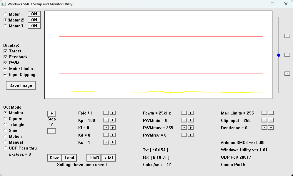

    I've tried that before, cause as soon as I put a cable from PIN8 to GND on the Arduino Uno, SMC3Utils won't beable to open up a communication "Could not establish comms with Arduino SMC3, Abort, Retry, Ignore".
    Thats weird, cause the Sabertooth is set to 115200 baud with DEScribe.

  4. _cOdaC_
    _cOdaC_ Member
    Dec 20, 2023
    63
    325Coins
    +9 / 0 / -0
    Ok, so I could prove that jumpering PIN 8 and GND leads to the Baud rate getting set to 115200.
    Testet it with a simple Outut to the Serial Monitor in Arduini IDE. 115200 was readable, 500000 not.
    The Code works, but still, SMC3Utils won't connect with a Baud rate set to 115200 but only with a Baud rate of 500000.
    Do I need to use another version of SMC3Utils? I'm using version 1.01 of the mentioned thread.
