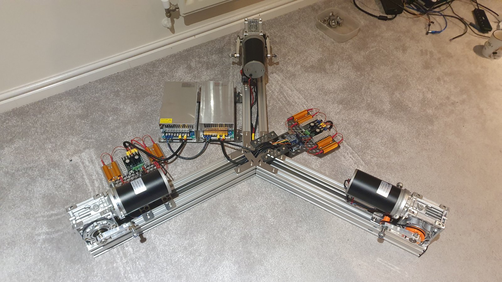

    I built my 2DOF F1 motion sim many moons ago and it has been an absolute joy to use. I've been tweaking it over the years and I'm very happy with it's performance.
    The 2DOF came about as a learning tool, with the end goal of building a 6DOF. The 6DOF is still the dream but I wanted to see if I could create a 3DOF by reusing as much of the 2DOF as possible, which I've managed to achieve.
    The design is complete in 3D, so now the fun begins....

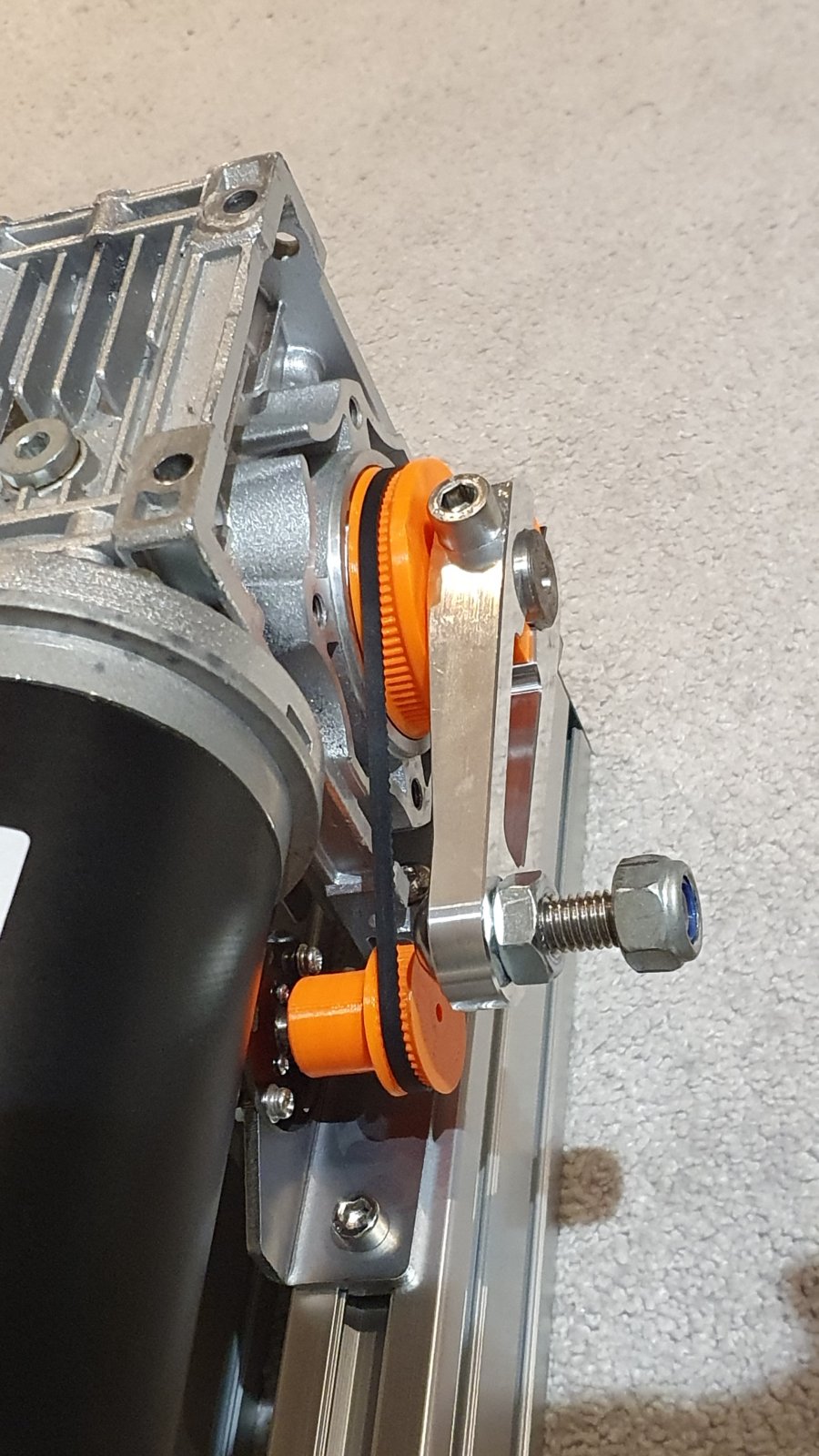

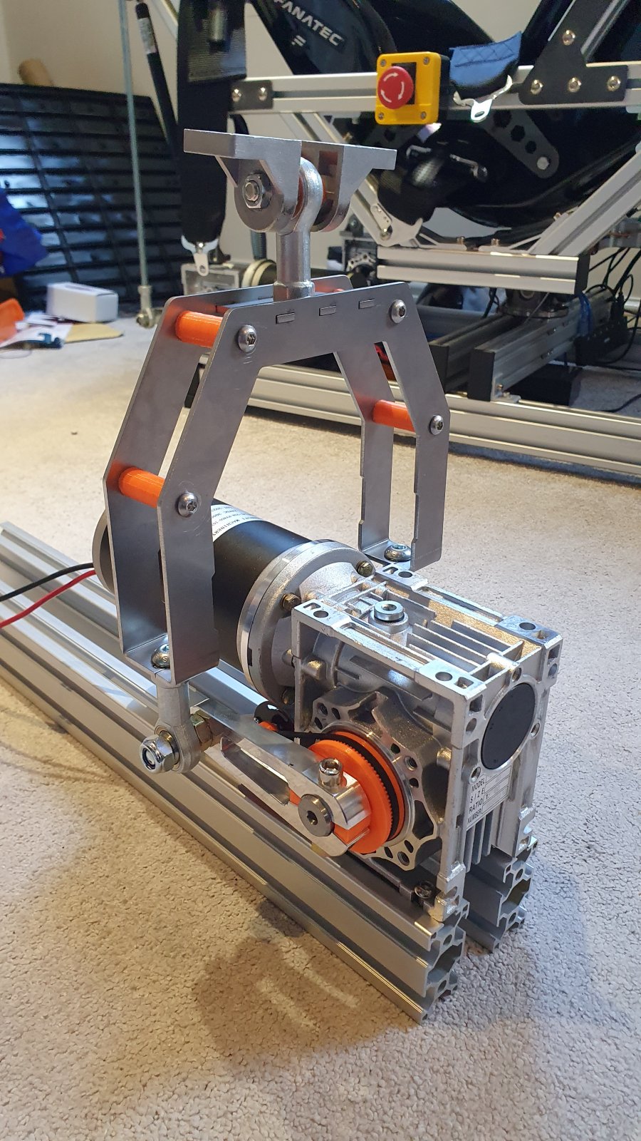

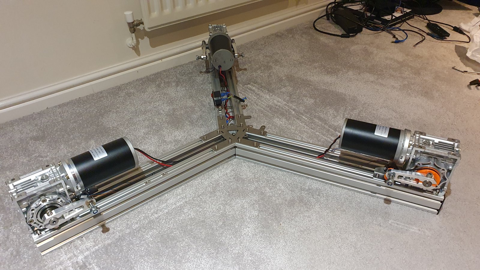

    This is the base setup, in a 120 degree Y orientation for maximum stability
    The motors now have levers both sides to distribute weight across the motor, with a 'n' shaped bracket to span the motor
    The pot feedback method has been changed from gears to belt drive to allow for the additional lever

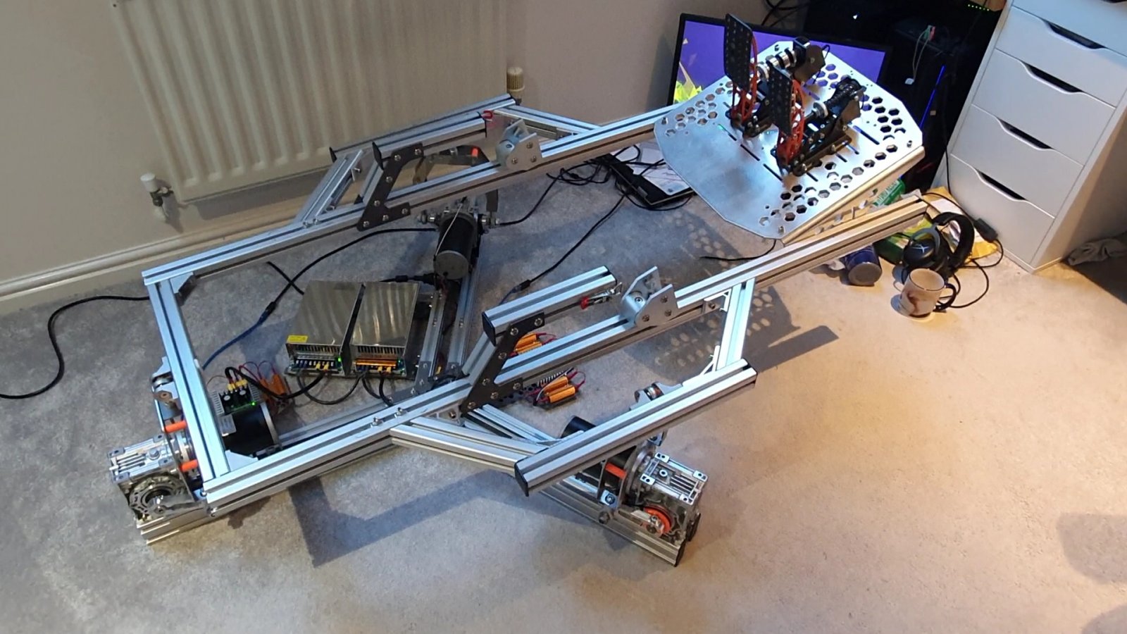

    Wired up

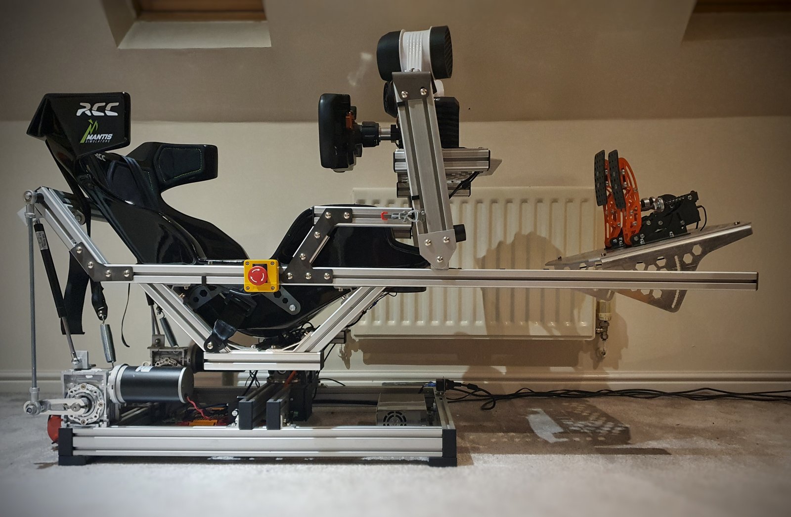

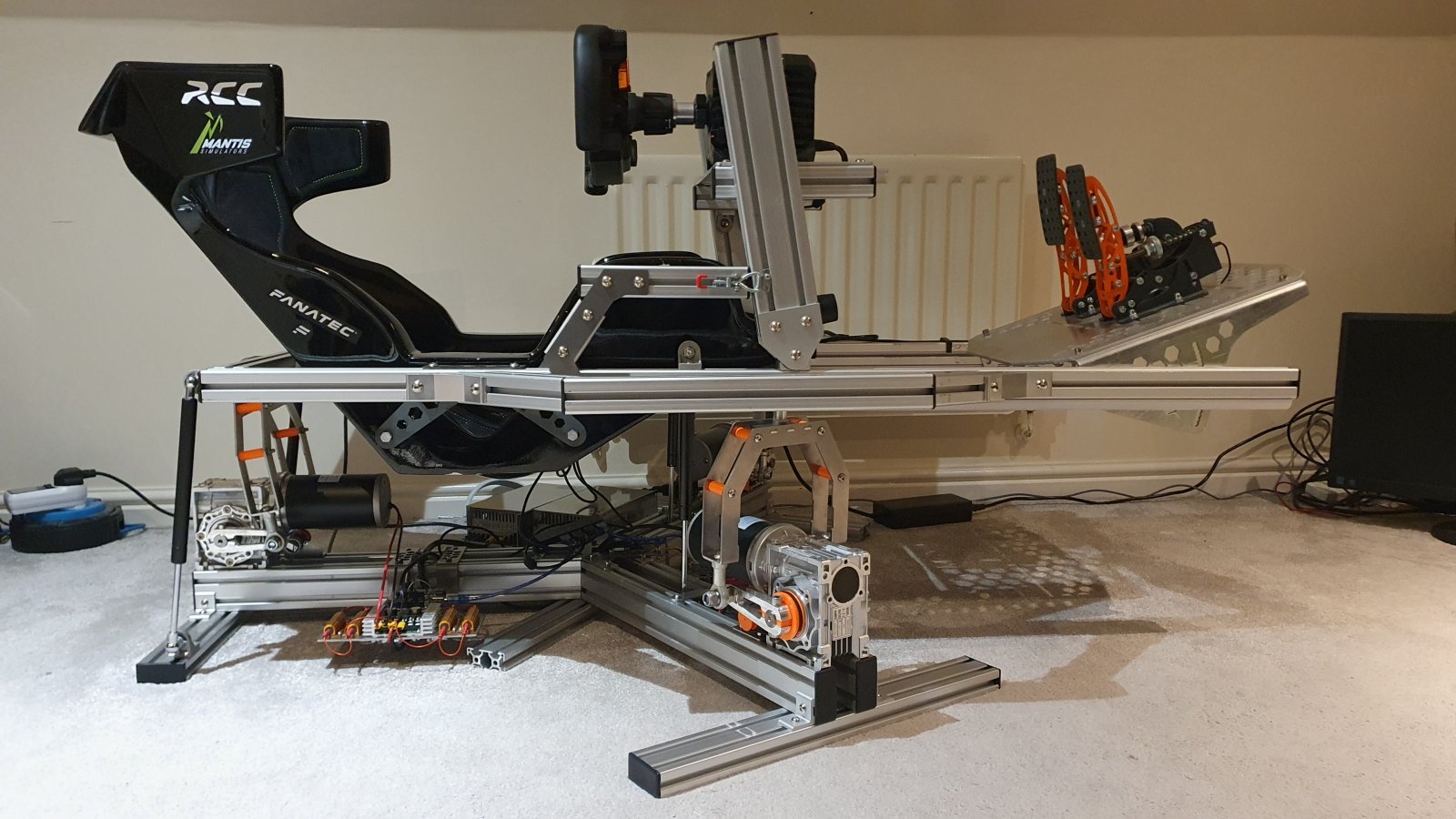

    Cockpit installed.
    The bottom part of the frame (previously used for the u-joint) is no longer required, so is reused and repositioned on the sides for the motor mount

    27
    327Coins
    Hello, congratulations, great job. I wanted to ask you how many kilograms of gasolifts you have? And one more question. How do you get in and out of the seat? If you can take a photo or video? Thanks.
  14. early_m
    early_m Active Member
    Jul 28, 2016
    336
    Chelmsford
    845Coins
    +357 / 5 / -0
    I use 200N on each motor which works well for my 75kg body weight.

    Got them off Amazon. No calcs, just trial and error

    420 total length - 170 stroke.
