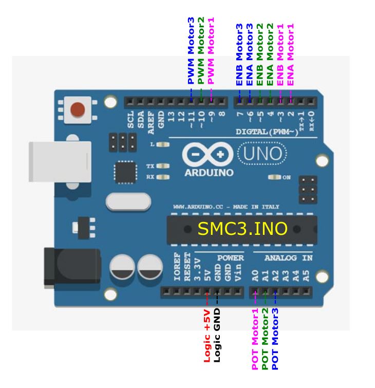

    After about a month of other projects, i've started with my simulator again.
    I have build a small test setup to get a the settings right
    This worked great, after that i rebuild al the electronics on the simulator. Everything worked but I am not really satisfied with the result. The motors will get really hot when the load is high, and cooling doesn't seem to do the trick. We've also noticed that the acceleration isn't that great.
    After changing some settings and some more testing was decided that some stronger motors are needed. BUT... I dont like these smaller, incremental changes. Later pneumatic cylinders crossed my mind. Those react a lot faster so the movement will be more realistic. And on top of that I can get a bigger stroke, what means more movement. I've done some reseach on the forum and found out that a large number of the members doesn't recommend pneumatic cylinders, but I want to test it anyway. It is my hobby to build and engineer stuff haha.
    That was quite a story, now I am left with one question:
    This photo, from the SMC3 tutorial, show that each motordriver recieves one PWM signal, enable left rotation and enable right rotation. I've checked that with my drivers (that was the reason why they didn't work the first time). And there the pwm signal goes to both enable left en right. And the enable left goes to pwm left, and enable right goes to pwm right. In my opinion it doesn't add up. Can someone please verify where this goed wrong.

  2. Gadget999
    1,971
    12,035Coins
    +486 / 10 / -0
    Which motor drivers are you using ?
    Are the motors 12v or 24v how many amps ?
    Do the motors move correctly in the smc3 test program ? You may need to do some pid tuning
